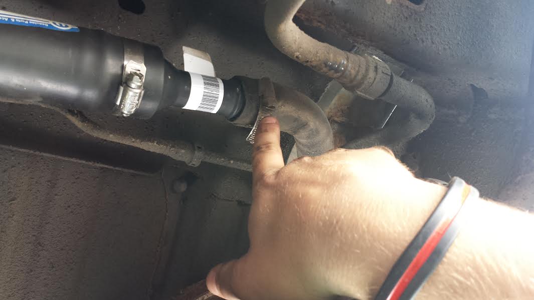

Now we need to loosen the hose clamp that connects the new part to the filler neck. There are 2 clamps that hold the part in. This is the hose clamp on the driver side that needs to be loosened.
Now we need to loosen the hose clamp that connects the new part to the gas tank. This is the hose clamp that connects to the fuel tank and is on the passenger side (relative to the new part). Notice that it is located almost directly above the rear differential.
