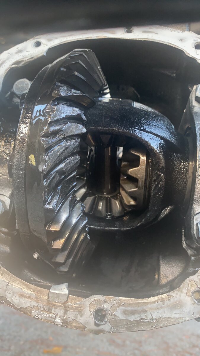

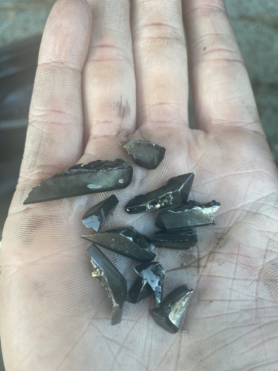

I have a 4in lift 16 Wrangler JKU on 35s. I recently blew out the cv joint on my front drive shaft and wore out my tie rod ends & drag link. (MY FRONT DRIVE SHAFT IS STILL UNINSTALLED) I have also been hearing a clanking noise that goes faster as my tires RPM increases. I looked into it and most people said it was due to a U joint. When I jacked up the front, I spun the left tire and nothing happened. when I spun the right one backwards, it would sometimes catch the left to spin and sometimes the left wouldn’t spin at all. Keep in mind I have an open diff. Sometimes when spinning the right backwards, the same noise would occur in the diff and the left tire would make a minor movement. Any information is greatly appreciated!
