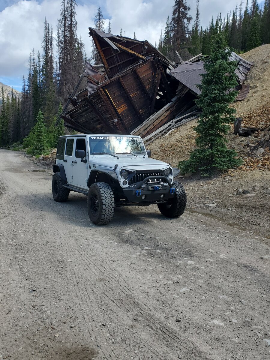

Hey Guys,
Sorry been out of pocket with work and I went on vacation to Colorado took the jeep after getting everything fixed on it. Went the 2 weeks before the 4th, there was a lot awesome rigs, from Wranglers to Gladiator's really want one of those out there. So an update from my end. I had the Fox 2.0 IFP shocks on my jeep, after all the adjustments and tire pressure dropped on it, it was still not right even at slow speeds. However my trip to Colorado was great, on the 3rd trail, was not doing anything extreme broke rear driver side Shock. So after getting that fixed, still riding rough. Well, I made a financial call and replaced those shocks when I got back home with the Falcon 3.3 Piggybacks, and everything is smooth now, no rough riding, no bouncing and that was the only thing I change and everything is smooth. I really think, with the weight of my fender's and bumpers, winch those Fox shocks just could not handle it. So I got the Falcon's that has the adjustable piggyback. I really am impressed with these shocks and how it change my ride quality.
I really want to thank you guys for your insight and help on this issue. Jeep community is great and I really appreciate you guys help.
