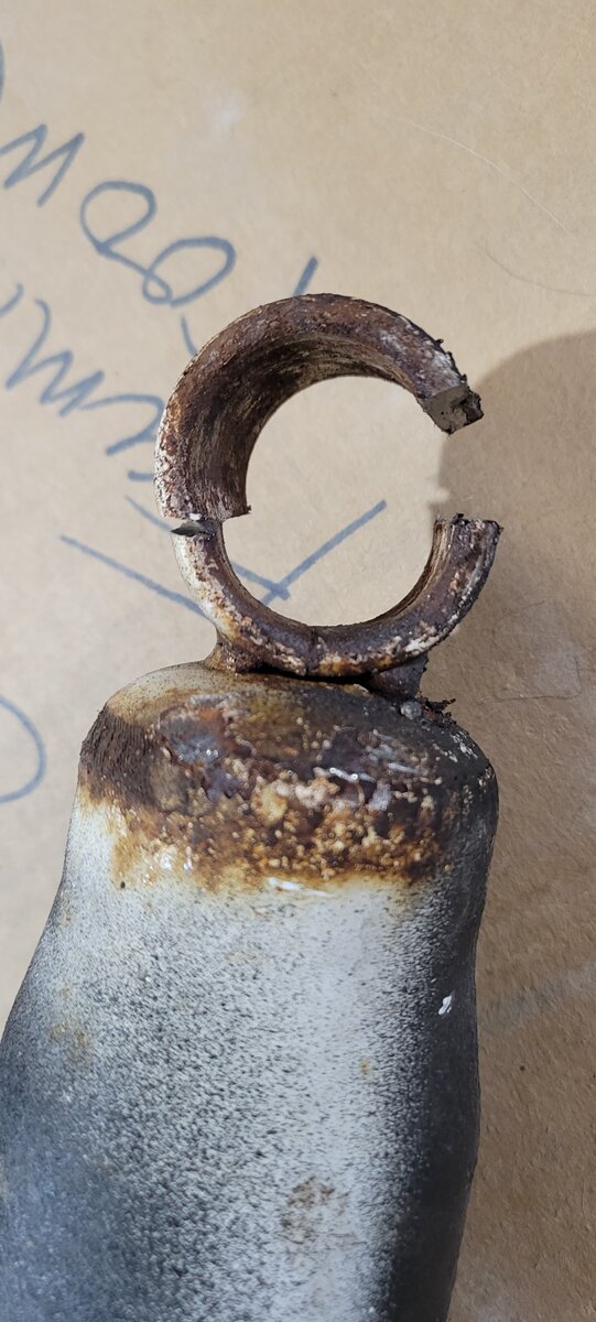

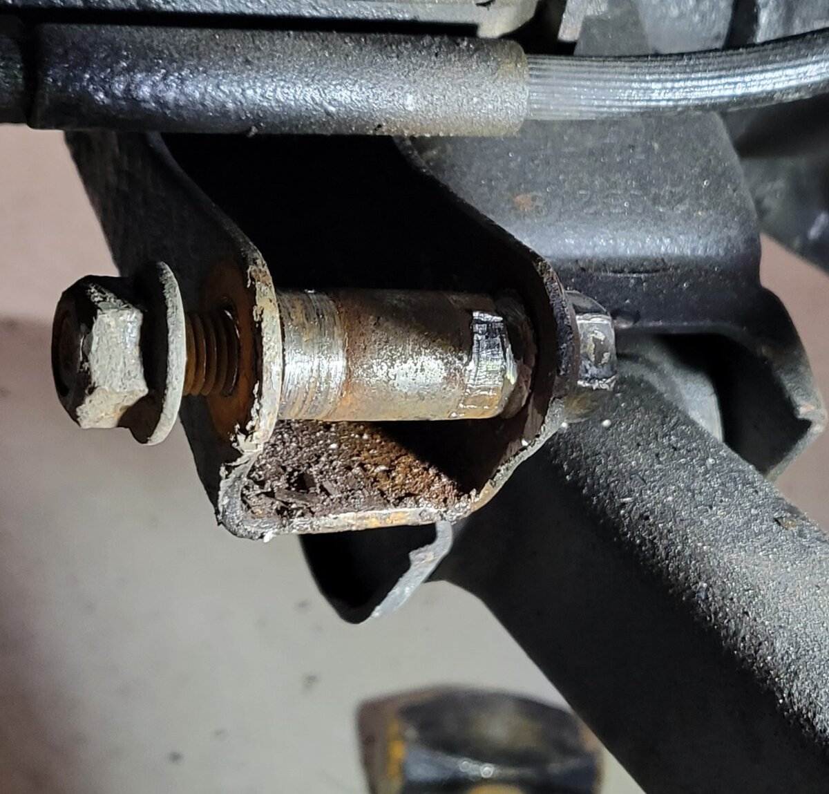

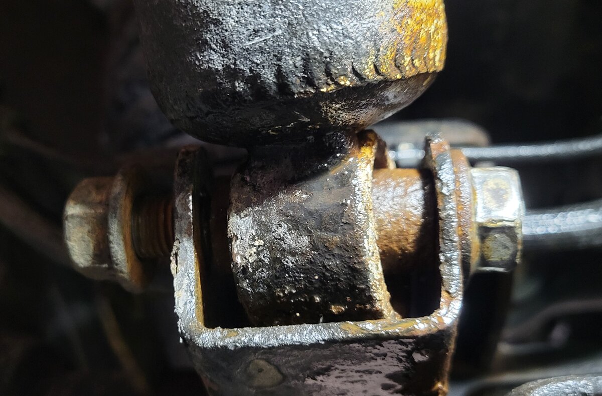

While checking I discovered that the front shock lower mount bushing is MIA.

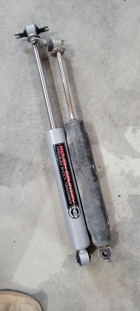

The new shocks showed up yesterday. Much better than the unknown old ones. Thicker shaft and they actually have some life in them. Got the rears installed after straightening out the brackets.
Worked on the passenger front shock yesterday. My year has some funky plastic tray that limits access to the top shock mount. Dont know if this is on all years. It made it more difficult to get to the nut, so I broke out the body saw and trimmed a bunch out. That was the worst part of the job.
Took her for a test ride on the street. MUCH better! Now she actually has shocks that work with the suspension. Before, it was just springs. Rode like a buckboard.
