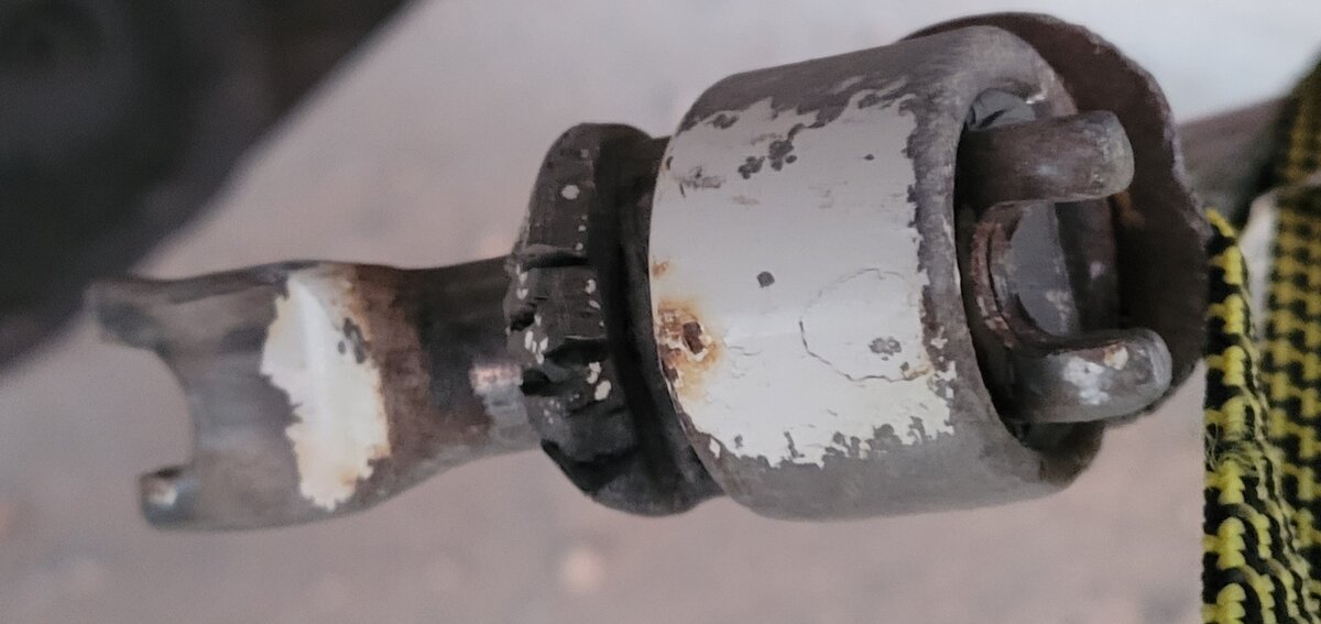

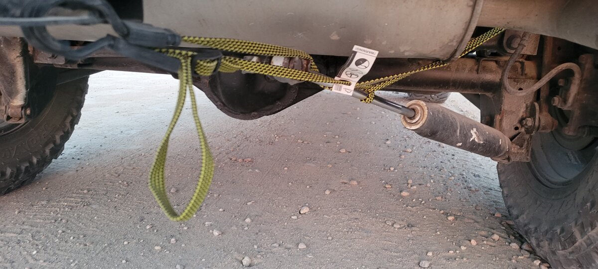

I was going to back over the bank for a pic, when my wife noticed something hanging down under the Jeep.
Turns out that the right rear shock had pulled out of its top mount! The tab was all bent and twisted. The mounting bolts were still in place.
What the Farkle???
We still had to get back home, Searching around the Jeep, I had tools. But nothing that would allow me to to straighten the tab. Time to strap it up.
Am I right in thinking that I got too much articulation to the shocks?
Looks like its time to shop for some new shocks.
It looks like you have a fairly small (likely 2-3") lift. A lot of people don't change the shocks with smaller lifts, especially if they're not planning to flex it up a lot. This can indeed cause the shocks to overextend, and could well be your problem.
Before you buy new shocks, I would spend some time figuring out how much lift you have. There is a good guide in the How To section of this forum. The brand doesn't really matter at this point, but it may in the future if you need to order specific replacement parts. It also is a good idea to know if this lift was done by changing the springs, or just putting in some spacers.

Another mode of failure for that mount is simply loose hardware. It might have not have been over extension but just rattled loose on your travels. Might want to look into some shocks with a lift range of 2-4" just to cover your potential of 3"+. Also, if you care for a smooth ride on those fire roads might want to spend some money on better shocks.
Side note. If your bushings are that worn on the shocks, they are likley worn on all the suspension. Take some time under the jeep, find any worn out items and tighten everything down.
