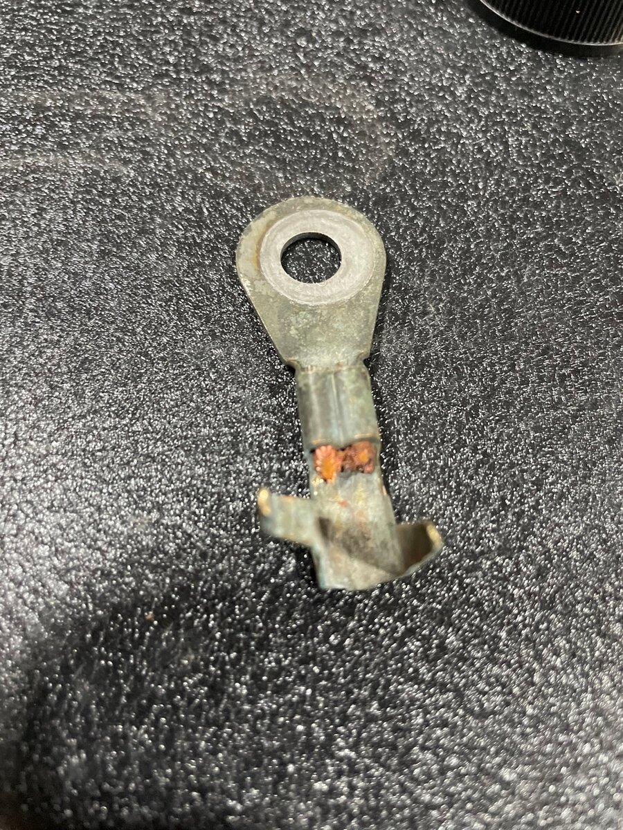

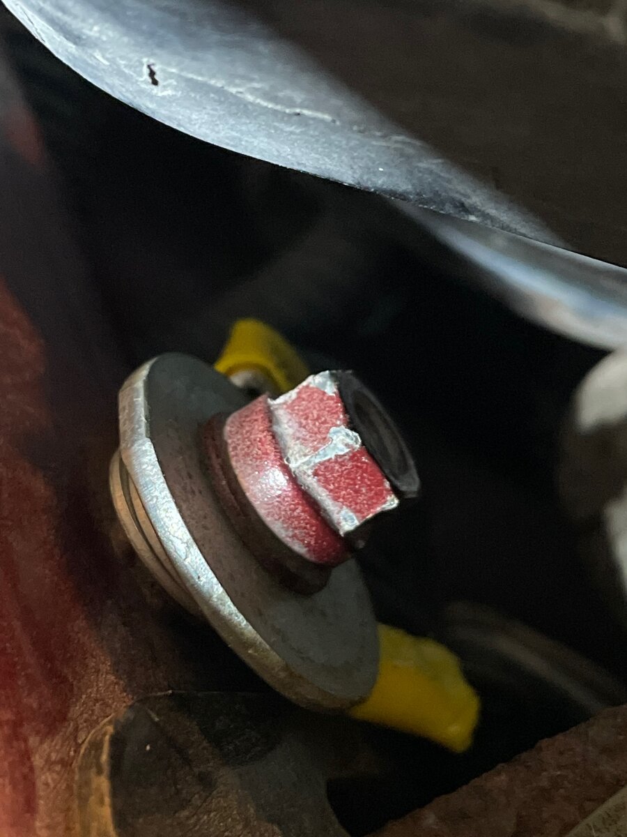

I believe I fixed the issue. The grounding connection next to the breather box was bad. The factory single connection had some wires that were broken. I pulled it and put on 3 separate end and bolted it back on the post. All lights are working properly.
