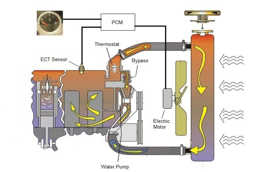

Any way, that's a lot to do over an overheating condition. Typically, start with the easy stuff first- like coolant level (make sure there's enough in the system); check radiator cap pressure; then the thermostat based on how the temp gauge and/or top radiator hose is behaving. Then follow the path of coolant and check off each of the items in order of where they are:
Also, I would question the accuracy of your gauge:
You said it "normally does not go over 3/4 on temp gauge but does so on occasion."
The fact your temp gauge is ever getting to 3/4 would be cause for concern in my book. Your fan is off at 203 or so and will not kick on until temps exceed 213 or so. Your temp gauge showing in the neighborhood of 250 is not good. That gauge needle straight up and down is where you want it.
Let me attach this handy cooling primer:
http://www.saharlow.com/4x4/doc_wrangler_jk_engine_cooling_170830.pdf
