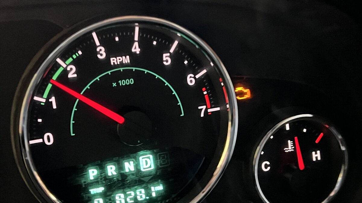

I need a reliable and quick response to my concern. My check engine light is on and I checked for the code. It shows me the P0128 code related to the coolant system running low temperature. I read somewhere that the risk is low, but should get it checked out within a month. My problem is I’m in Tennessee and will be driving back to Louisiana on Monday, 800 miles. Should I be concerned about the drive or not? I’d like to wait and get it checked out at home, not on vacation. Thanks
Straight up as it has since I’ve had the Jeep. I don’t know what the actual degree number would be.
I would think as long as you watched your temp you'd be ok. Have you popped your hood while it's running to see if it smelled or looked hot?
Sure have. No smell or leaking fluids. I pretty much assumed your response, but thanks. When I get home, if it’s still on, I may have the local mechanic I use check it out for me.

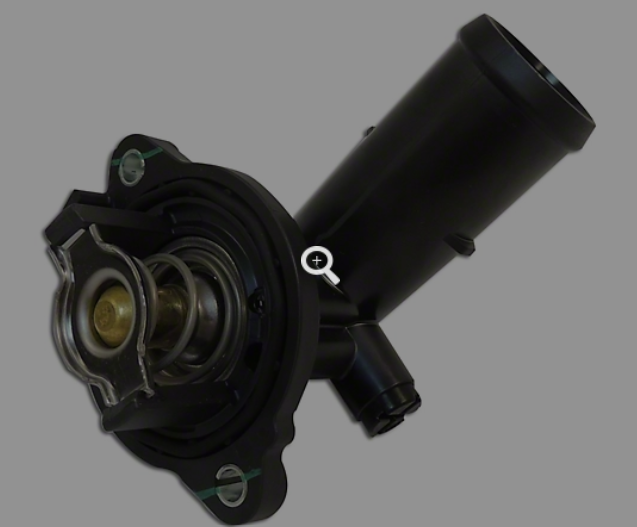

Typically a stuck open thermostat will cause this. Easiest diagnosis:
With a cold engine, have someone start your JK with your hand wrapped around the upper radiator hose and if you can feel flow immediately or within a few seconds of start up, this is the first indicator the t-stat is open. It's not supposed to open until the engine is at operating temp, and when it iopens, that's when you should get coolant flow through the hose.
This first test is the easiest, doesn't cost a penny and will almost always give the info you need to either begin looking elsewhere or just replace the t-stat.
And, as JJ stated above, make sure you get an OEM t-stat. Get the option with the housing, which is black ABS plastic. Much easier to install that putting a new t-stat in the old housing. Partsgeek.com was the cheapest and quickest ship time, that's where I got mine.
