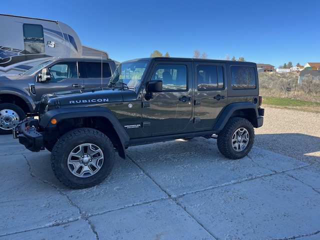

I just did something similar a couple days ago. I started from a stock Sahara 2dr and went to JKU Rubicon springs/shocks with a spacer in front. Here is my post. Let me know if you have any questions...

I understand your sentiment but I think it depends a lot on the particular product and use case. If the OP provides more details about his starting point (model, mods, etc) it would help.
That being said, I received a Rough Country 2.5" spacer lift with the parts I purchased and that went right on Marketplace. It has brackets for the shocks, brake lines, etc but when I'm ready to go that route I'll just pop for the AEV kit w/ matched springs and Bilsteins.

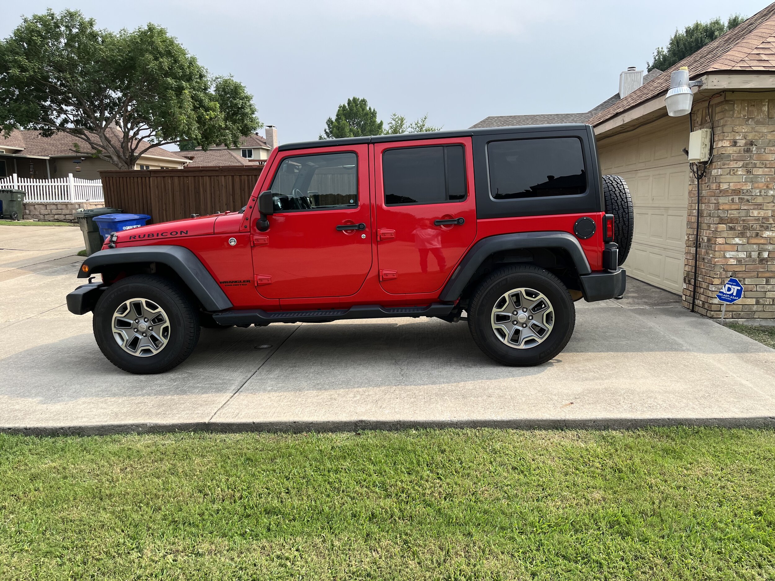

Sorry for the lack of detail. It is a relatively bone stock 2015 Rubicon. My current plan is to put a 2-2.5 lift on it and run a different wheel with a taller, not necessarily wider off road tire on it. I will not be using it for crawling, just moderate off reading and camping. Adding a pic for reference.
That helps! Since your already starting from a Rubicon it changes the reference point a bit. How many miles??

It has just over 75,000 miles on it, but was in pristine condition. The shocks are factory, so they are fairly worn out and not great to begin with. It also wallow a bit on the road, so I think a steering stabilizer of some sort will be needed as well. I really just want it to be up a little bit more and upgrade the tired suspension. I am not adverse to adding springs to the mix if needed, but I just do not want to go to a really stiff harsh ride.

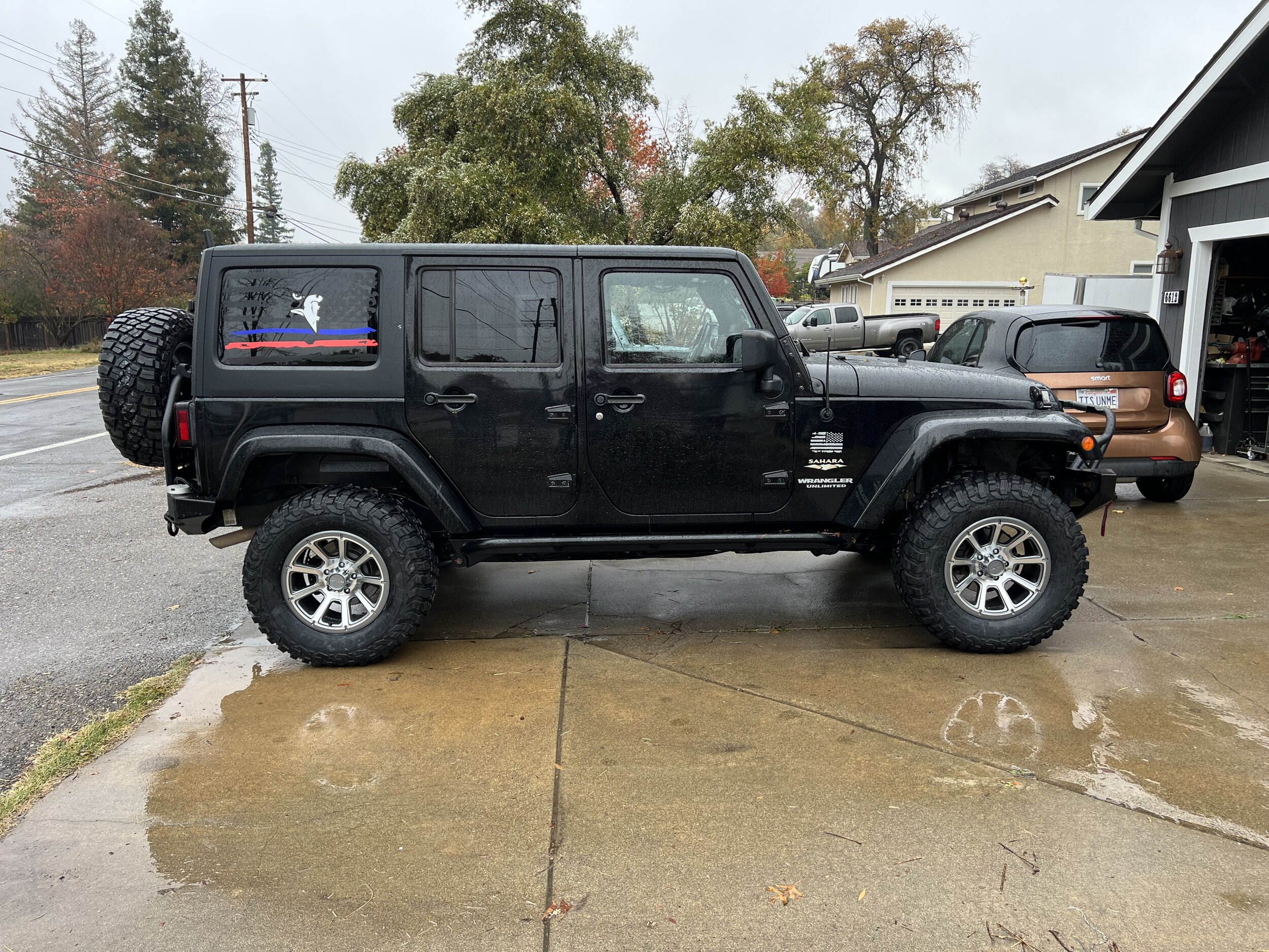

This is exactly what I want stance wise. What tire size are you running?
I just installed the AEV 2.5" lift about two months ago, and could not be happier with it. The kit was around $1100 with free shipping from NorthRidge 4x4. By the time you buy the spacers, new shocks etc, you are about halfway there to the full kit. The Jeep rides and handles better than it did with the factory suspension.

Initially when I measured right after installing the lift, it was pretty close to 3" in height gain. But it has settled slightly, and I haven't measured it since then. I'll try to get a measurement tomorrow.

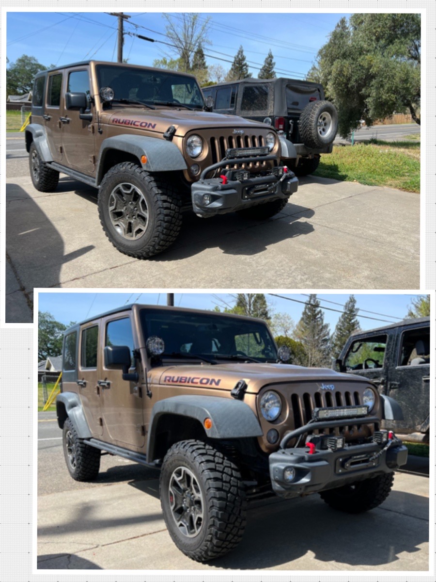

I second the 2.5” AEV lift. It is complete and a great ride. We have it on two JKU and one JK. She has 33” on it. I have a Rubicon, it still has 32” on it. Mine has a before and after picture. We netted around 2.75”-3”
