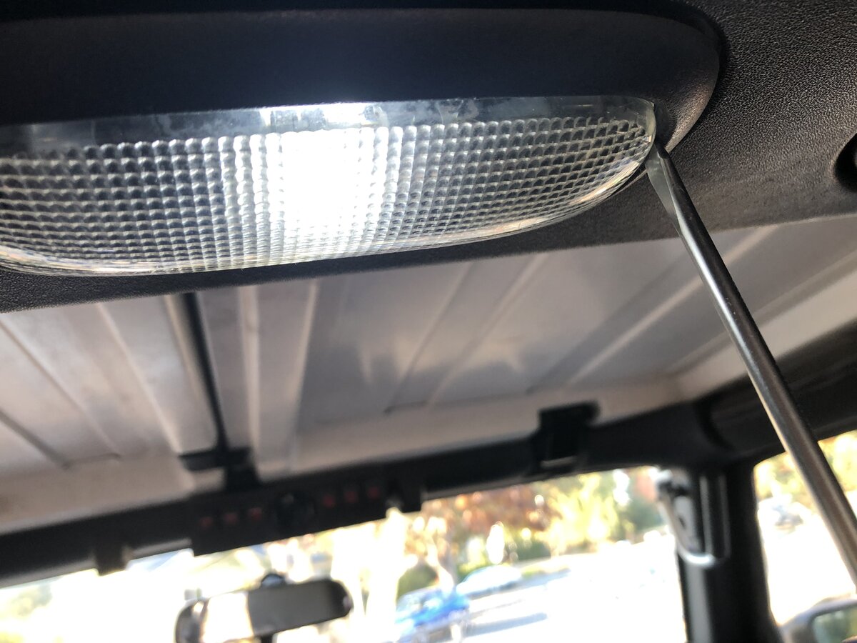

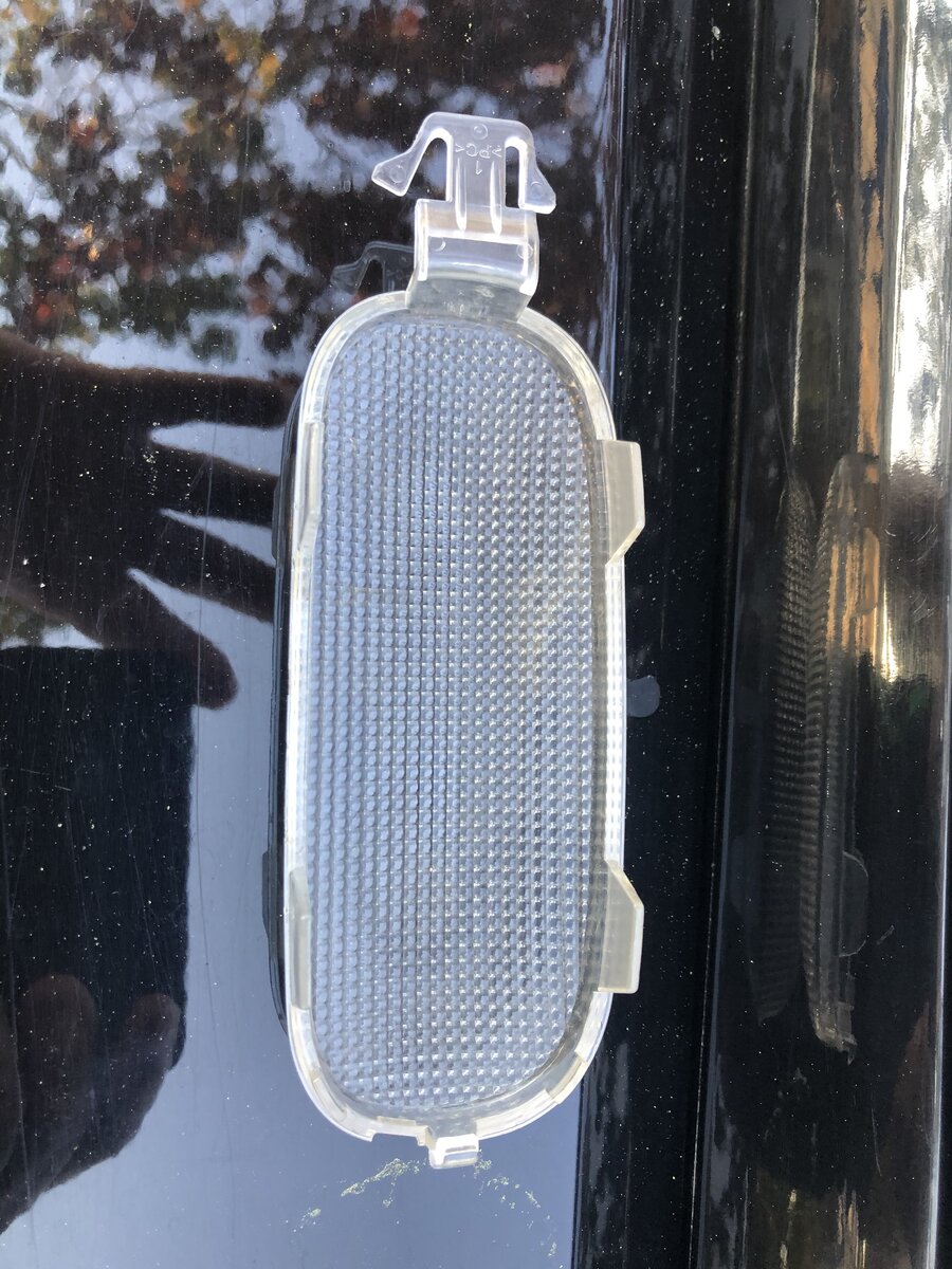

Ok so took my dome lens out .
Top pic left side . See how it has a bend and extension to it
That goes in on left side of housing .
On right side just gently push up a smaller size flat blade screwdriver and should pop out .
If there is resistance than maybe yours or mine is reversed so use screwdriver on left side .
But try on the right first . The left , right directions are looking at it from back seat .
