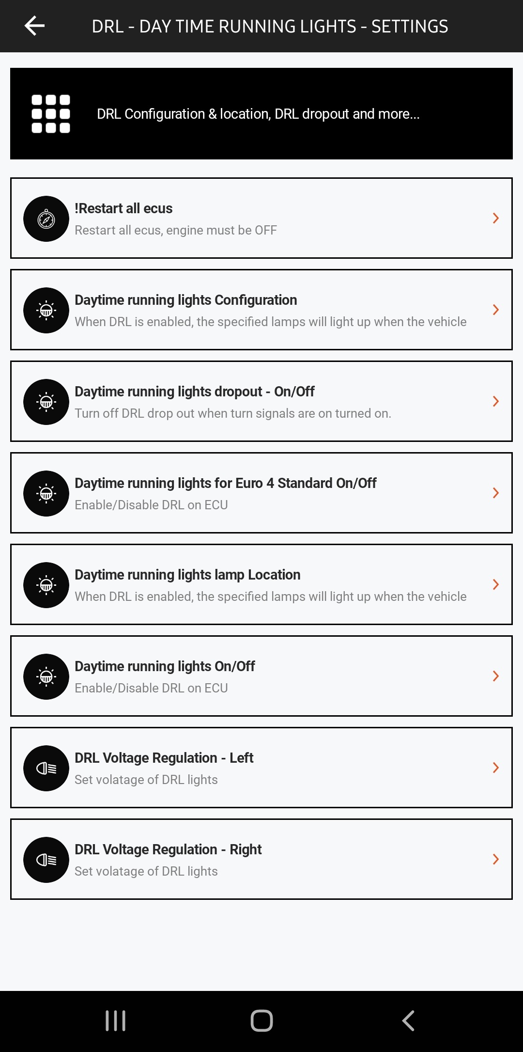

BLACKJKU Moderator Staff Member Lifetime Supporting Member Joined Feb 22, 2020 Messages 4,865 Location Huntington In Mar 26, 2024 #2 Should be able to if you get Jscan. Reactions: WestCoastDan, Rich1961, JeepJeezy and 4 others
JeepJeezy OlllllllO Supporting Member Joined Jun 8, 2021 Messages 829 Location 717 Mar 26, 2024 #3 BLACKJKU said: Should be able to if you get Jscan. Click to expand... This Reactions: WestCoastDan and BLACKJKU

JeepJeezy OlllllllO Supporting Member Joined Jun 8, 2021 Messages 829 Location 717 Mar 28, 2024 #6 Did you check all 7 settings in Jscan for DRL?

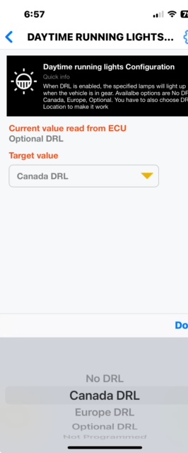

Anybodyhome USN Retired (1973-1993) Supporting Member Joined Jun 15, 2020 Messages 1,424 Location Nashville, NC Mar 30, 2024 #9 When I swapped my OEM fogs for LEDs several years ago, I used the Jscan to enable the DRLs using my fogs. I prefer it that way. And, correct me if I'm wrong, but I thought DRLs were required in Canada?
