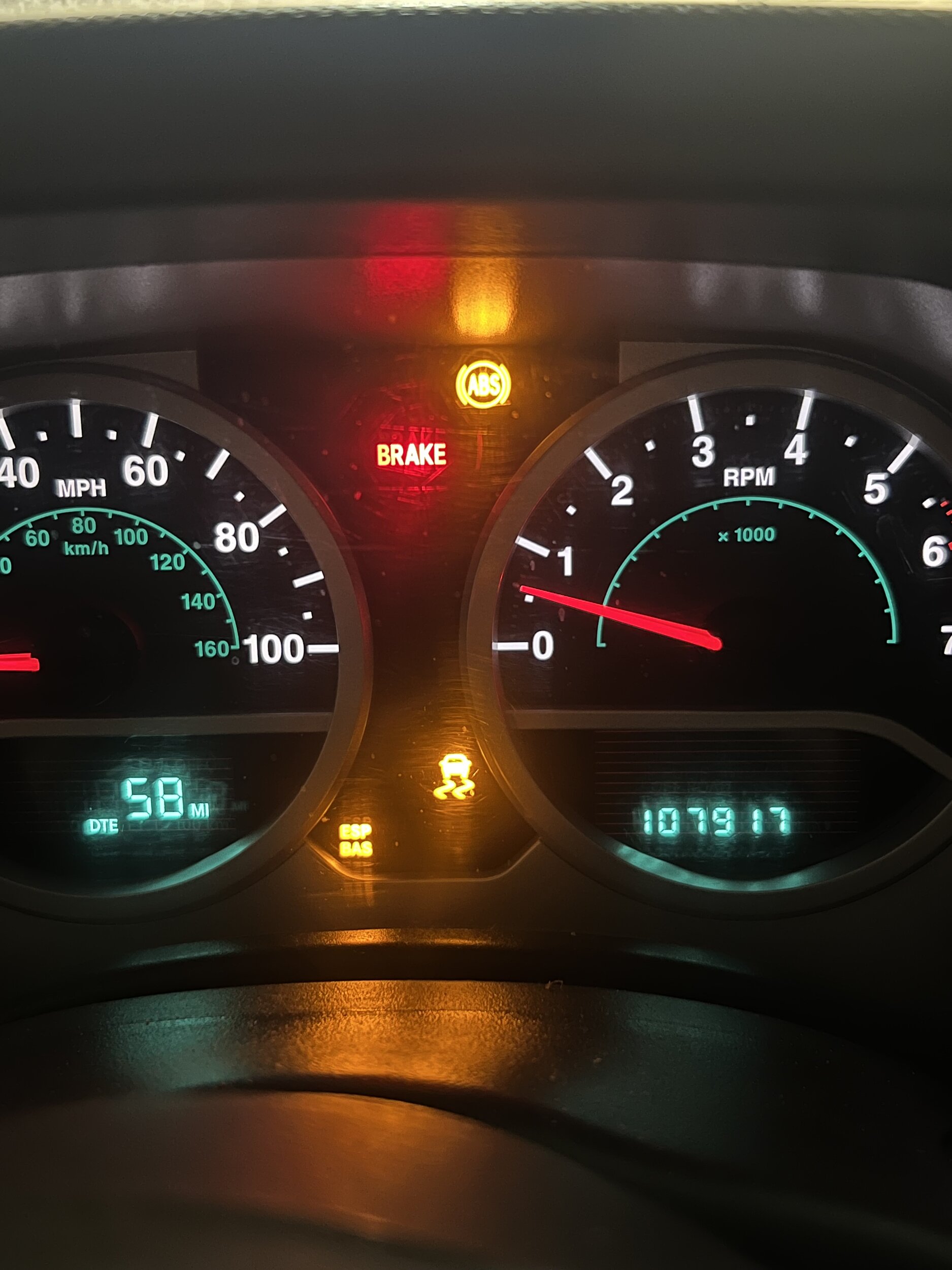

A Apoorman1 New Member Joined Mar 4, 2024 Messages 2 Location Utah Mar 4, 2024 #1 My dash lit up like this tonight. Everything functions normally though. I tried tightening the battery terminals. It doesn’t come on immediately but only once I get moving. Am I screwed?
Danarch JK Addict Supporting Member Lifetime Supporting Member Joined Mar 9, 2021 Messages 1,326 Location Orangevale, CA Mar 4, 2024 #2 Make sure they are clean. While we still have the stock clamps they don’t work well. Also have your battery tested, a bad battery will cause issues. Reactions: BigAL07 and mrjp
BLACKJKU Moderator Staff Member Lifetime Supporting Member Joined Feb 22, 2020 Messages 5,114 Location Huntington In Mar 5, 2024 #3 My dash has looked like that for a couple years now, i'm pretty sure it's a wheel speed sensor. Reactions: BigAL07
Snowbird Tom JK Enthusiast Supporting Member Joined Mar 19, 2023 Messages 445 Location Michigan Mar 5, 2024 #4 Stop by your favorite auto parts store and have them pull codes. Best way to figure it out. Reactions: tJKrider and 1o1Proof
A Apoorman1 New Member Joined Mar 4, 2024 Messages 2 Location Utah Mar 5, 2024 #5 Would the speedometer work if it were a wheel speed sensor? BLACKJKU said: My dash has looked like that for a couple years now, i'm pretty sure it's a wheel speed sensor. Click to expand...
tJKrider JK Enthusiast Supporting Member Joined Oct 20, 2023 Messages 538 Location SE Michigan Mar 5, 2024 #6 Apoorman1 said: Would the speedometer work if it were a wheel speed sensor? Click to expand... Yes. Wheel speed sensors are for ABS and traction control. Reactions: BigAL07
BLACKJKU Moderator Staff Member Lifetime Supporting Member Joined Feb 22, 2020 Messages 5,114 Location Huntington In Mar 5, 2024 #7 Apoorman1 said: Would the speedometer work if it were a wheel speed sensor? Click to expand... Yes but the cruise control doesn't, only thing I miss. Reactions: BigAL07
BigAL07 JK Enthusiast Joined May 18, 2021 Messages 502 Location W.Va. Mar 5, 2024 #8 X2. If u got a wheel speed sensor out your cruise won’t work. J-scan or a good code reader which one or ones it is Reactions: BLACKJKU
G greenie meanie New Member Joined Mar 5, 2024 Messages 2 Location Savannah Ga. Mar 5, 2024 #9 Mine did the same thing. Turns out it's the antilock brake module. It stops ok but the brakes will lock up if you're not careful.
