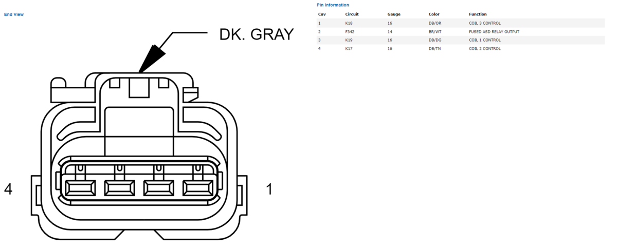

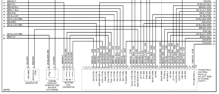

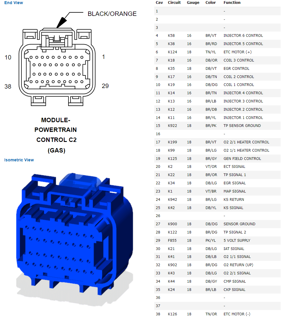

I've attached some diagrams I used along the way, if someone else comes across a similar issue. I can say it is a absolute chore to hunt down all the information!
