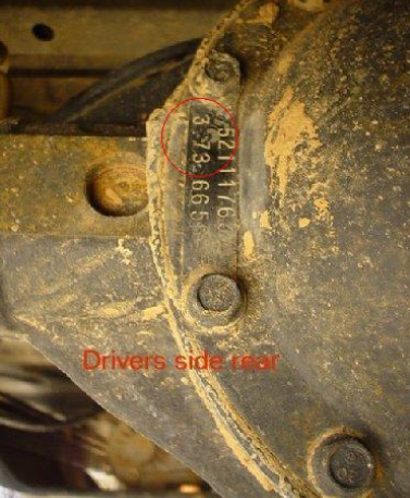

Second: on the rear side of the rear differential, there may be a tag showing you the gearing:

I did figure out (did a little research) about gear ratio and that tag is missing and I'm particularly set up to count teeth and pinions. I read also that Unlimited Rubicons come standard with 3.21, It's pretty obvious someone did some work on it and I'm 90% certain this is the case. He was blowin all of the air out of the system so this is how he ended up with coolant everywhere. I performed the head gasket test this morning (no milky oil, no air bubbles in the radiator or reservoir, no white exhaust.

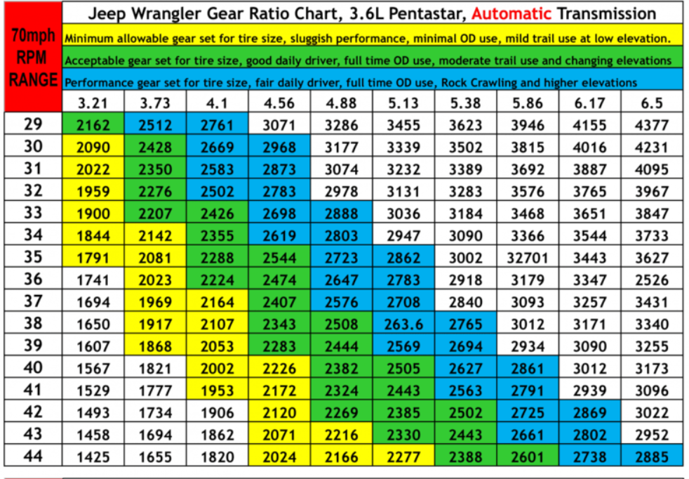

To be honest, I'm not sure a 4.10 is the best gearing for 37s. A 4.56 minimum will run much more efficiently and a 4.88 will be the sweet spot. Your 4.10 is putting a load on the engine and trans with those 37s.
I'll assume you have an auto trans- here's a chart:

You are correct. Someone else provided this table and I'm sure it's not at the sweet spot. I told him that I wasn't particularly set up to count teeth and pinions and that the metal plate with the ratio is missing. It's very evident that someone has altered it and that it's not at 4.10 but whatever it's at is still insufficient. Based on the table I was thinking 4.88 would be ideal. Another individual said he experienced the exact same issue and had to replace the thermostat multiple times before finding a solution.
