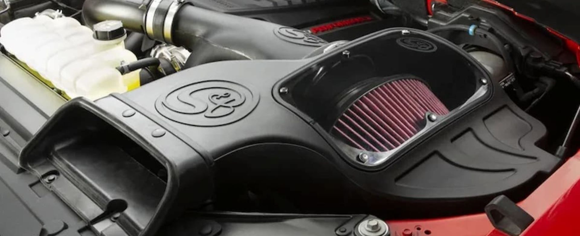

So you need a custom built engine to make it worthwhile? Yeah I just have a 2008 regular stock engine. It sounds like a nice clean filter and keeping that way is the way to go. Is that what you mean by free flowing?
Free flowing filter is a filter that isn't to restrictive, but yet filters enough to not let dirt through it.

Just saying that a higher performance engine would need more air volume from a bigger diameter intake tube.
Back to the question. Good clean filter is all u really need. I tried a CAI years ago and not afraid to admit I didn’t care for it. Replaced it with a good cleanable AFE filter. No complaints at all. I clean it good each time I change oil
I swapped out the disposable engine and cabin filters for washable K&N filters. If you plan to own your jeep for at least 10 years then the cost will be fully amortized, since you save the costs of replacements, and if you take it to a shop rather than DIY, the labor cost as well. There are a lot of tweaks we do to engines that are short term costs and long term savings. As concerns air filters Project Farm on YouTube has comparisons of air filters his conclusions don't show any performance benefits.

Cold Air Intakes add power. This is undeniable. It's not a huge addition, but it is real. They are not superchargers. They are not game changers. In conjunction with supporting mods, they produce bigger gains. And the more you modify the engine, the more important it will be to have an open, free flowing intake.
