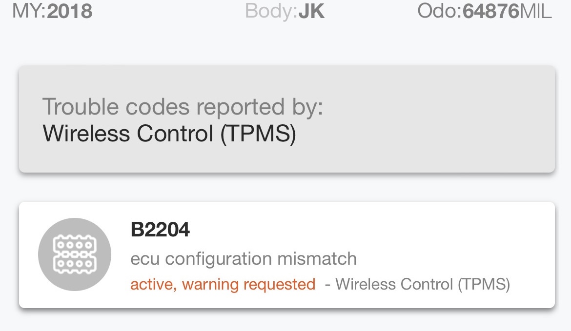

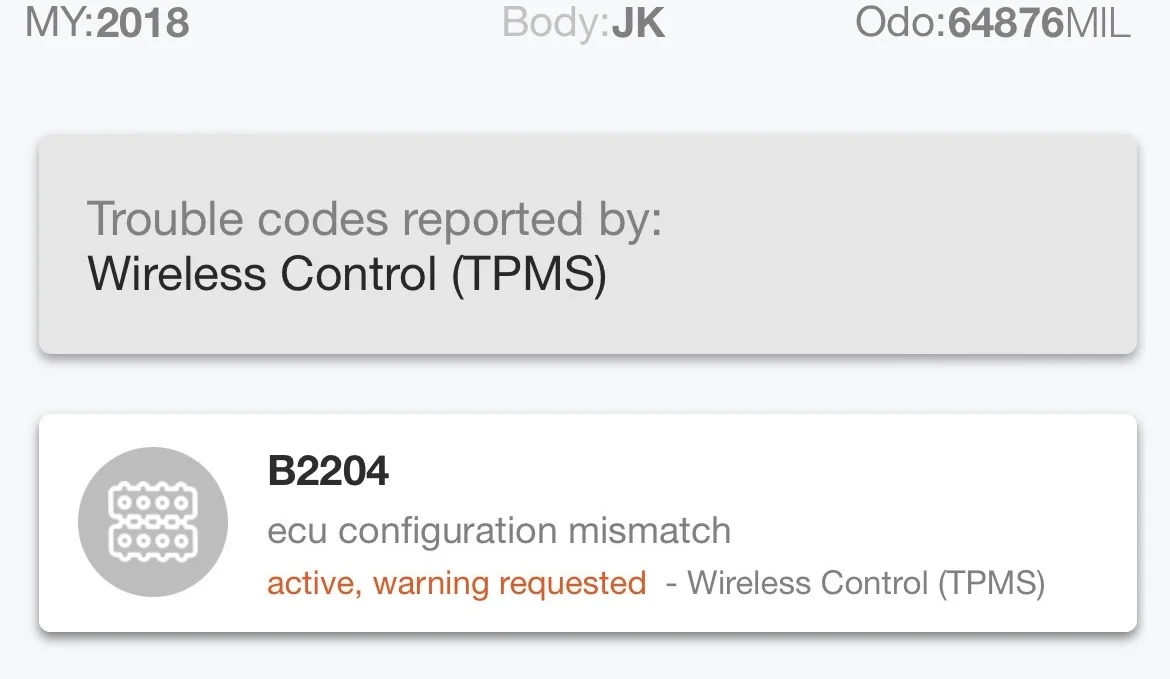

The B2204 error on JScan says “ecu configuration mismatch.”

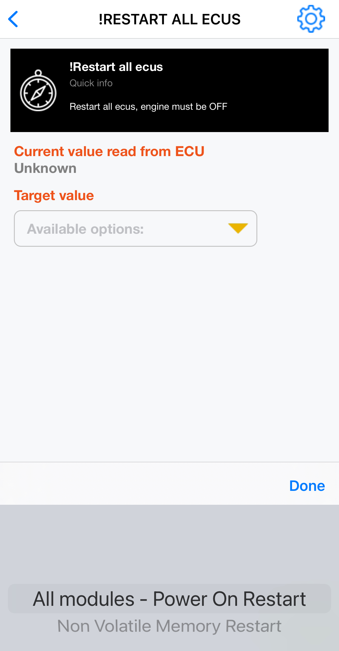

When I open “restart all ECUs,” the target box is blank. There are two options to choose: All modules- power on restart and then Non Volatile Memory Restart. I don’t want to mess anything up. Should I do something there?

Screenshot of the error code and screen shot of what I see when I go to restart all ECUs.
