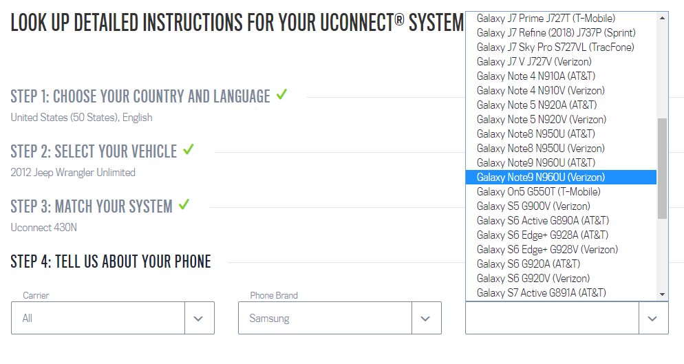

According to Mopar site, your phone is not listed on compatible phones but I think your phone is compatible and the site did not yet updated a list.

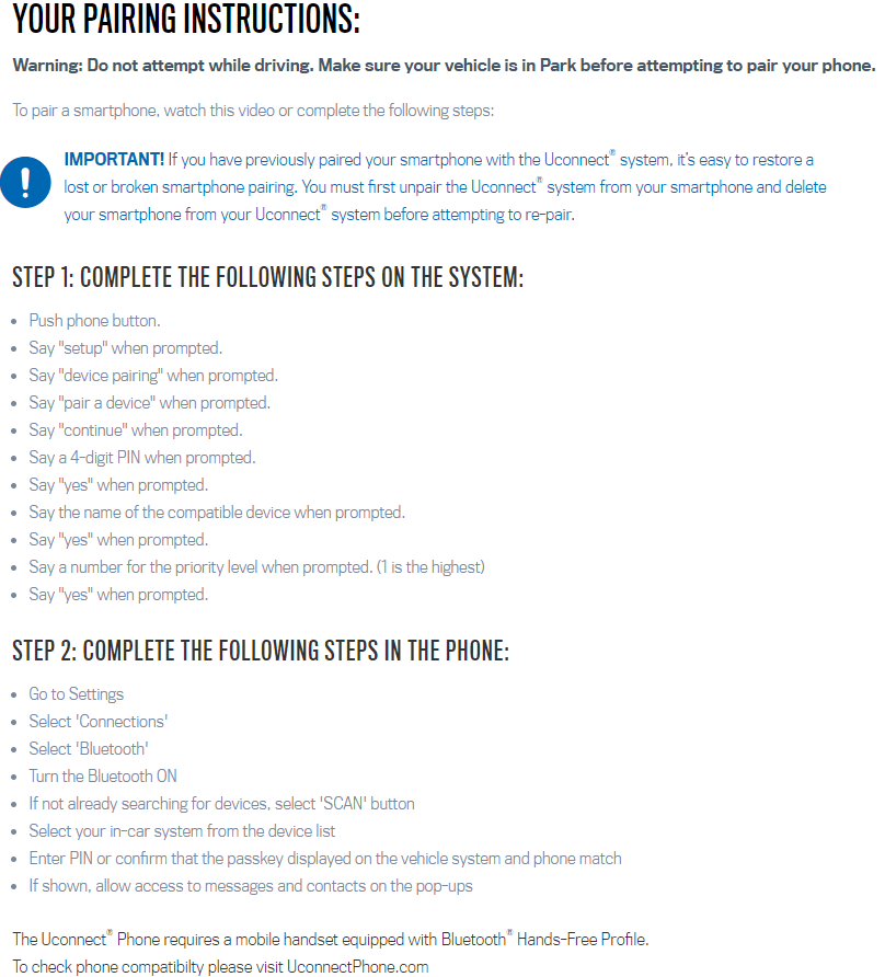

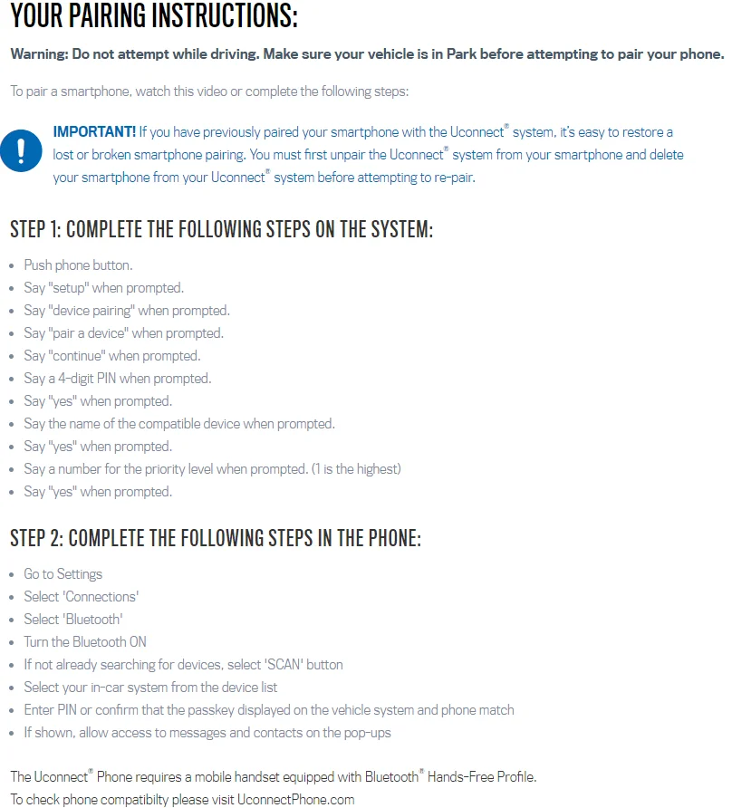

Below is general instructions for 430. I believe you already knows...
