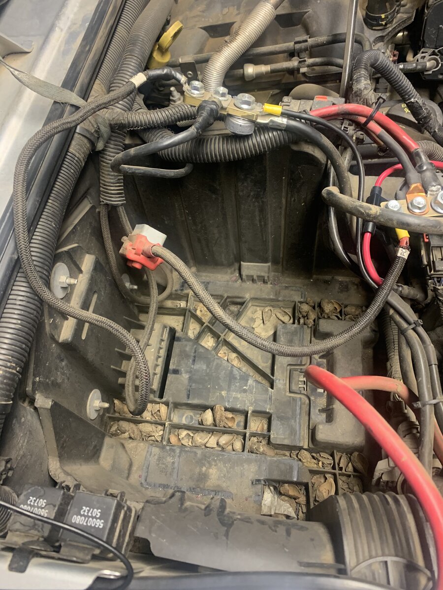

Fun find replacing it:
The previous owner had it stored for a couple years and obviously it was home to a squirrel or two😆.
New NAPA in place.
