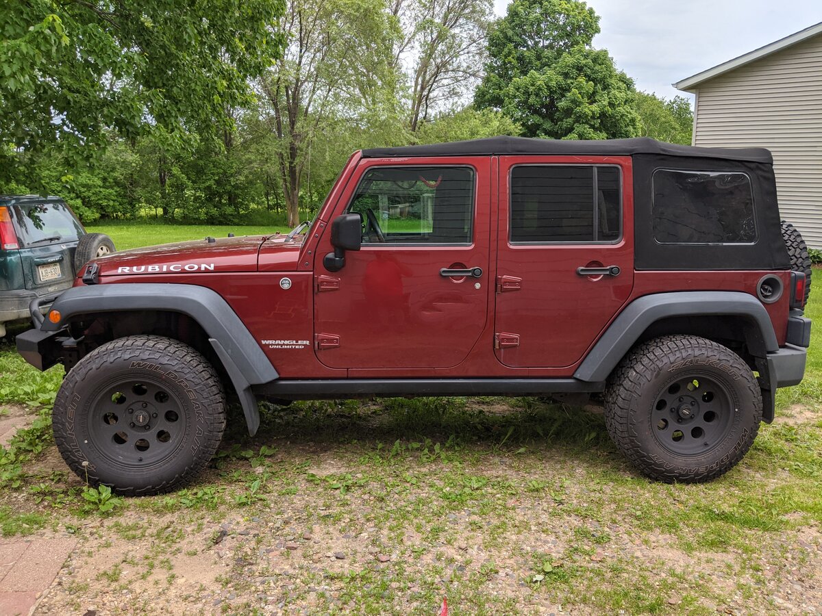

I run 285/ 70 / r17s which are essentially 32.7ish x 11.2
In this pick I have a 1.5 teraflex basic leveling kit. Tomorrow I'm installing the teraflex 2.5 spring kit with the vss shocks.. unless I get rained out.
One thing to remember when increasing the size of your tires you can create clearance issues with stock rims. These tires would physically not fit on the jeep with stock rims, I needed more back spacing. My buddy still picks on me about that.
How heavy is the bumper in this pic? With the leveling kit, did the bumper create any sag on the front suspension?
It's been quite awhile, I don't remember if I had my winch or not at that point.
The leveling kit really did what it was supposed to do, it just leveled the vehicle out. Yes with a heavier bumper the front is less high, but it's all about making it the right height for you. Whether that is based on appearance or function is totally up to you.
