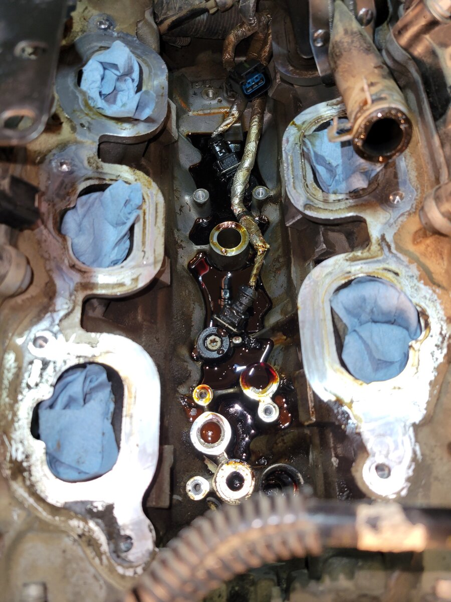

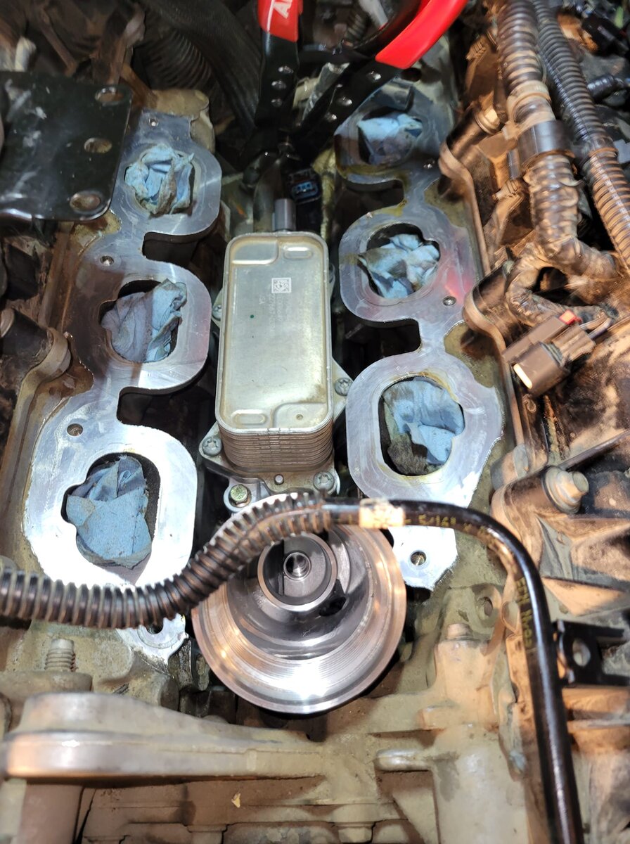

Another oil cooler bites the dust
I got it done on Saturday and all is well now but because the Dorman unit is on back order, I had to throw an Amazon unit in there. Hopefully it lasts a while. Adding insult to Injury, the Intake was dripping with oil so I got the pleasure of also buying a $170 PCV Valve from the dealer.
