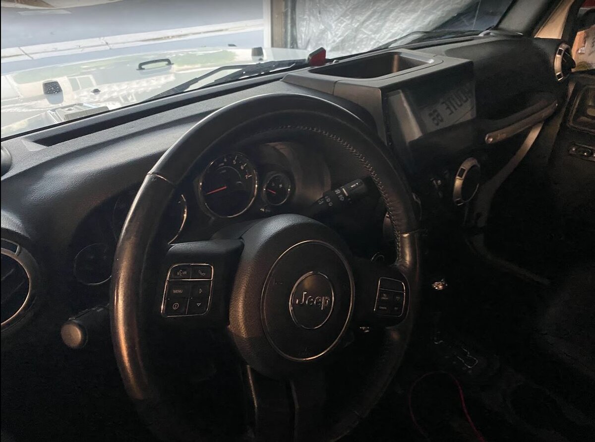

Today I installed it.

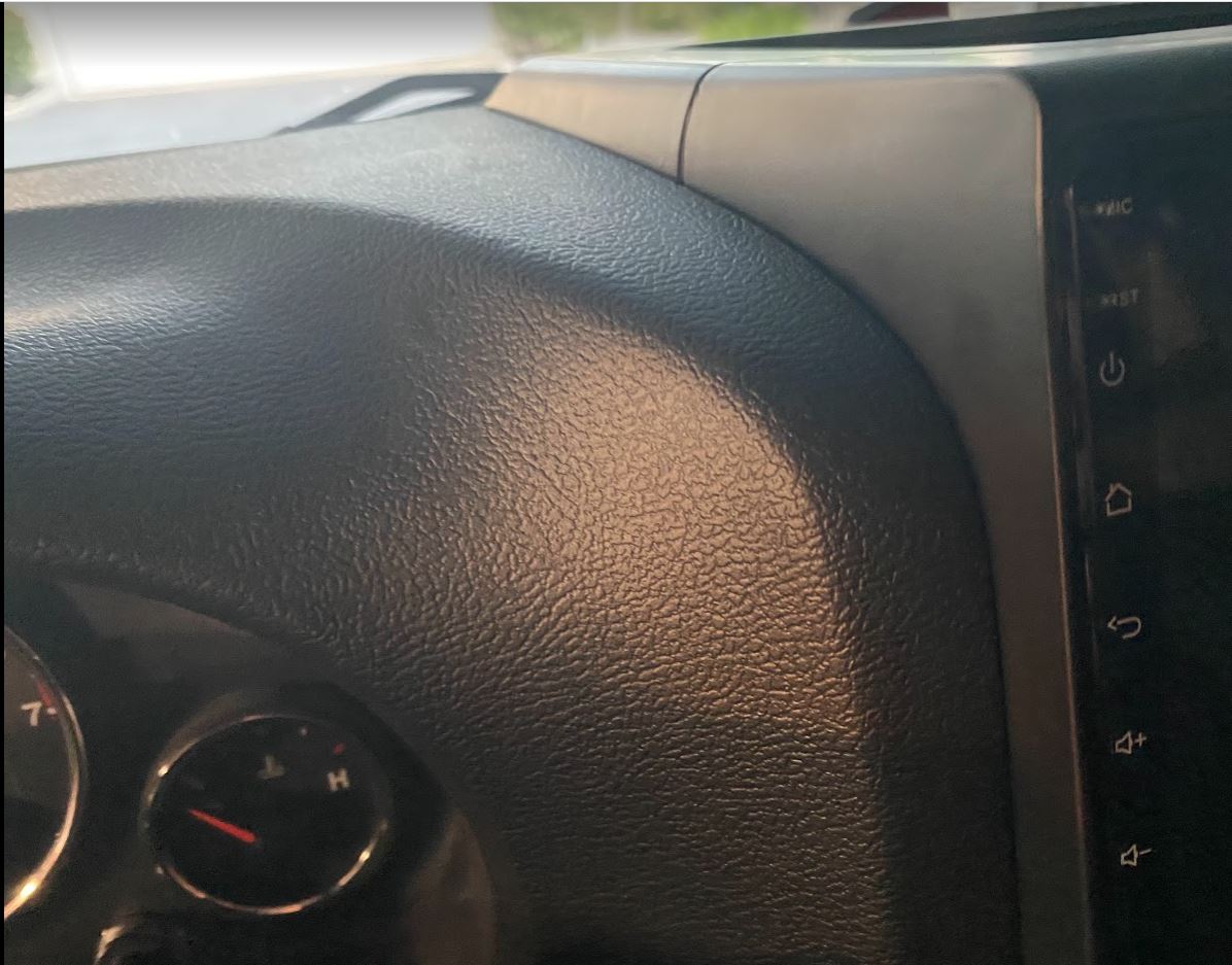

I was impressed by the fitment of the new dash pod, but to get a clean look around the gauges, it was necessary to file down (4) gate tabs that were not smooth.
It was super easy, and unnecessary for most, but my OCD would not allow me to install it without filing them smooth.

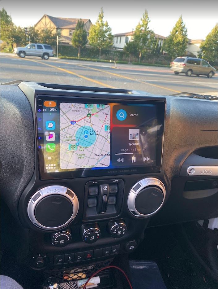

Setup was as expected. It supports both wired & wireless Carplay on my Apple 11 pro max.
Some reviews state there is no scan function on the FM radio, but all I had to do was hold the button for a second instead of just tapping it & it scanned as expected.
I didn't make any significant changes to the setup, but I did flip through the software enough to locate the basic controls & functions.
The radio/center bezel is a bit tricky, but it fit nicely once I got all of the wiring organized and tucked out of the way.
The finish of the plastic parts is better than expected, matching the grain/texture on the passenger side very well.

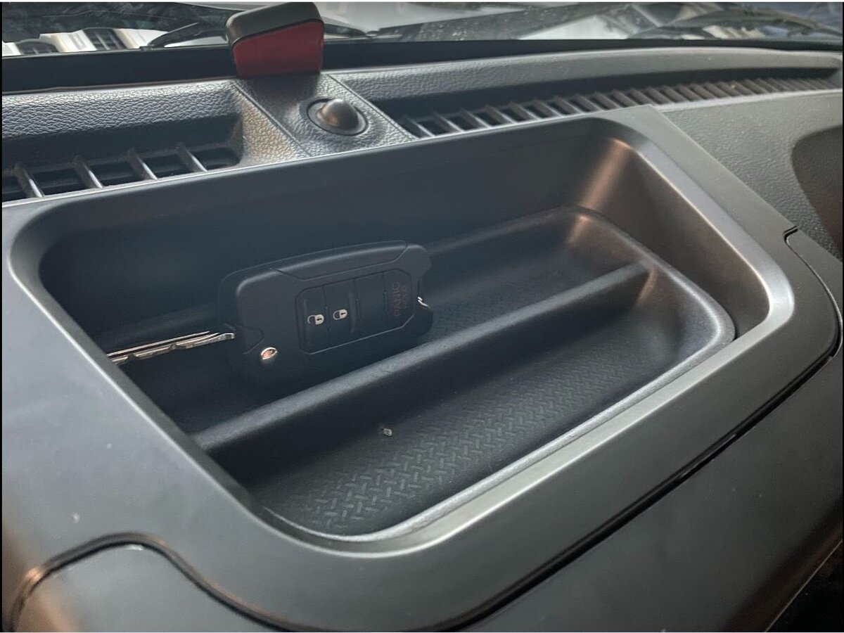

The tray is a perfect copy that allows the plastic/rubber insert to be reused.
AC vents fit nicely and lock solidly, just like in the factory bezel.
So far, I give this thing 2 thumbs up; definitely worth $599 when you realize that lesser units are priced at over $1,000.
