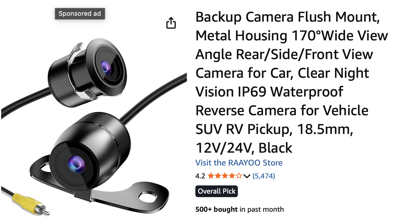

Hello, I purchased a cam off Amazon for less than 20 as the touchscreen resolution is not great anyway, I had the J Scan already and then mounted the camera in spare tire center hub cap. Easy install and there are many inexpensive mounting solutions.
Ah, and for power, I used a "key on" positive from the passenger side tail light, and poked a hole through the grommet for the wire to go through.
Good luck!
