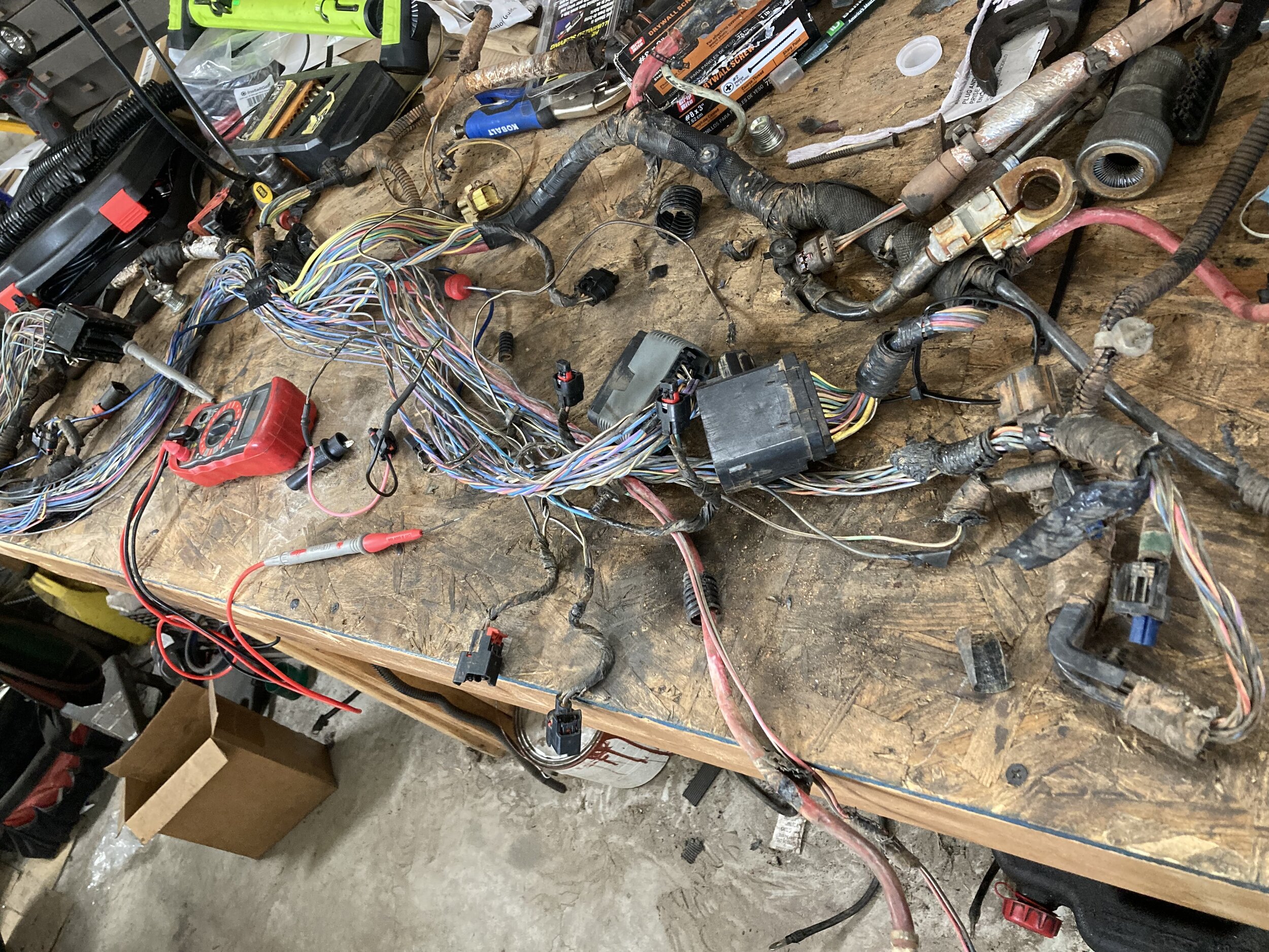

Even if I get it to act up then check power or continuity it’s all working fine. If I reset code it runs good for 30 seconds. Check engine light comes back. Check for power or continuity when it’s messing up it comes up fine. When I picked it up from last mechanic it was missing then a minute later it smoothed out for rest of drive. When it missing computer it shutting fuel injector off. I was thinking maybe it thinks it’s being stolen that’s why I thought about key. It also started about 1 hour after new keys programmed.

This is my engine harness had the whole thing out it must be in the body harness the wire for number 5 had no resistance I would hook meter up and shake wire around to see if it lost connection did it to all coil pack wires
