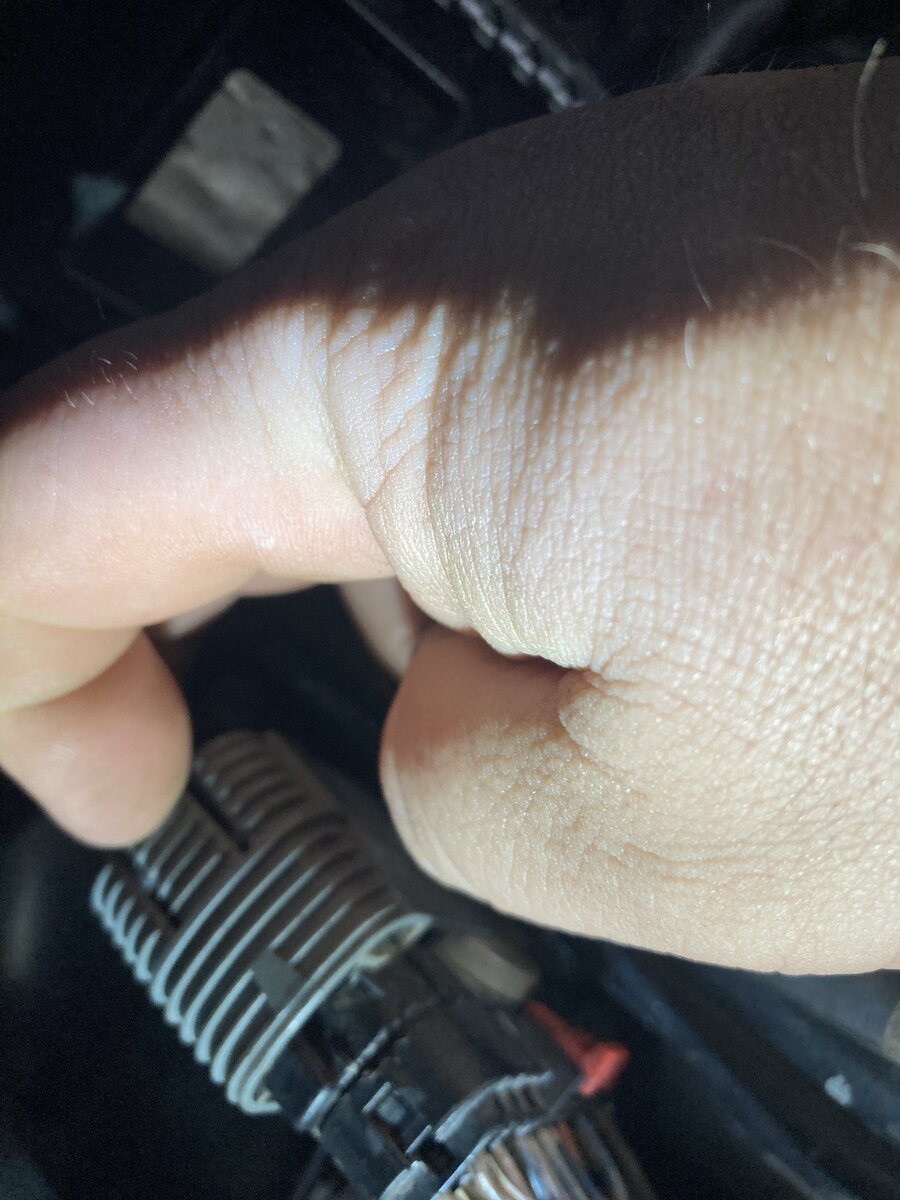

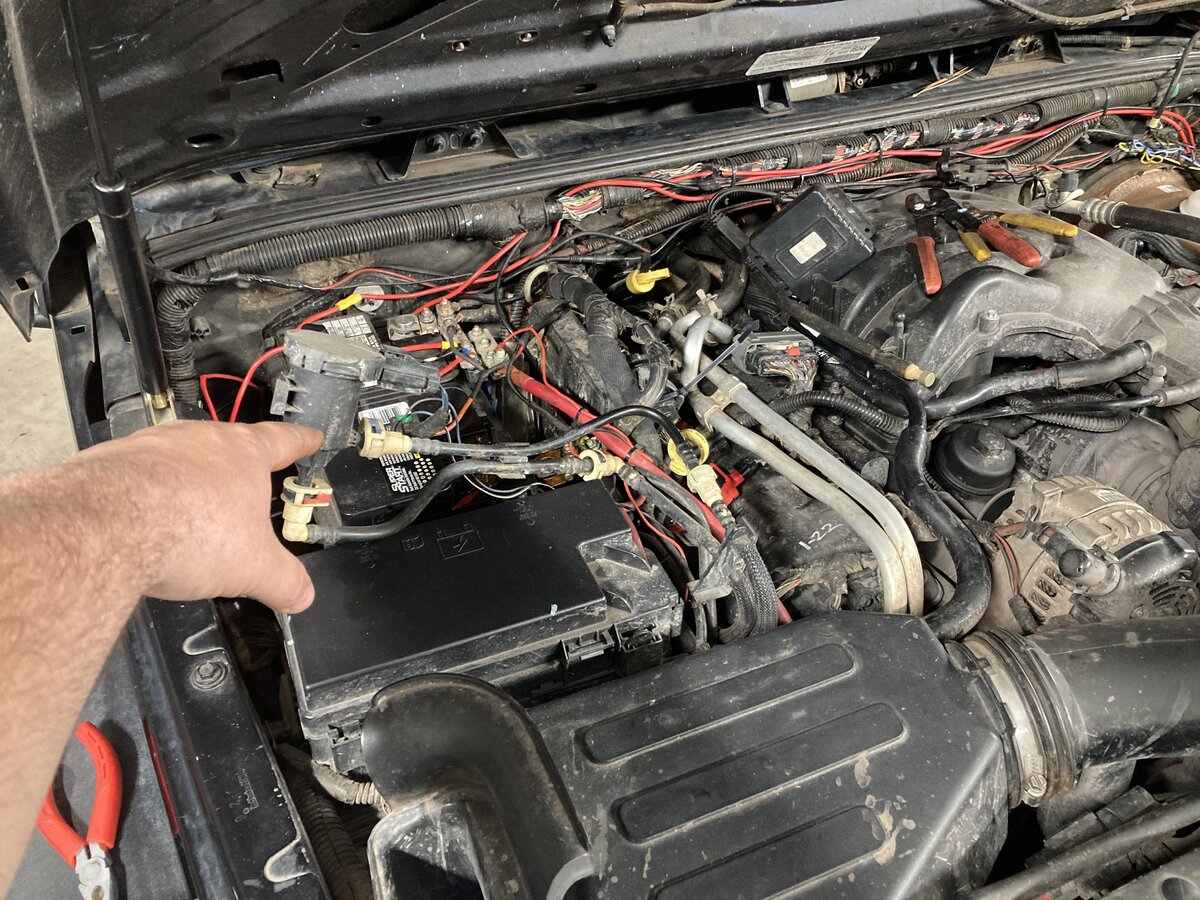

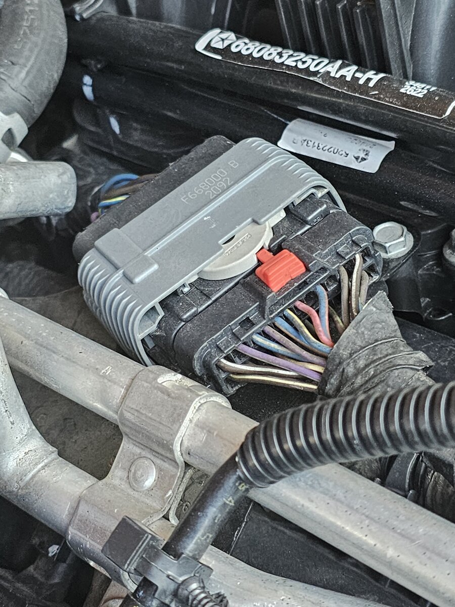

Got it...it came up on this forum so I don't feel so bad...I don't see exposed wires pins look good. Do you have care to post a couple of pics of the engine bay so I can see where stuff is connected? I've got some oddities to me...see? I'm assuming one line is disconnected goes somewhere??? And the long one just hangs across to battery and so it comes loose...?

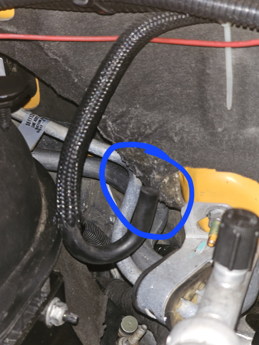

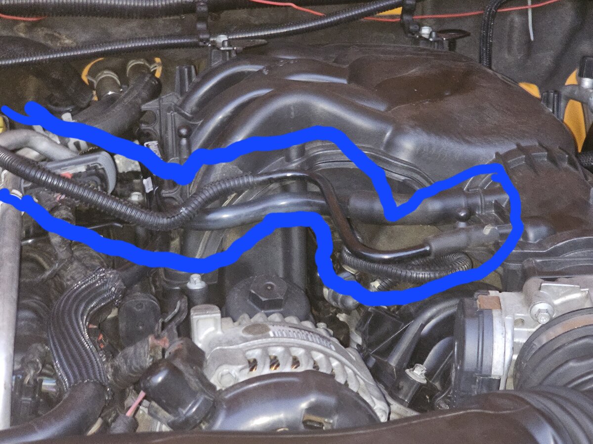

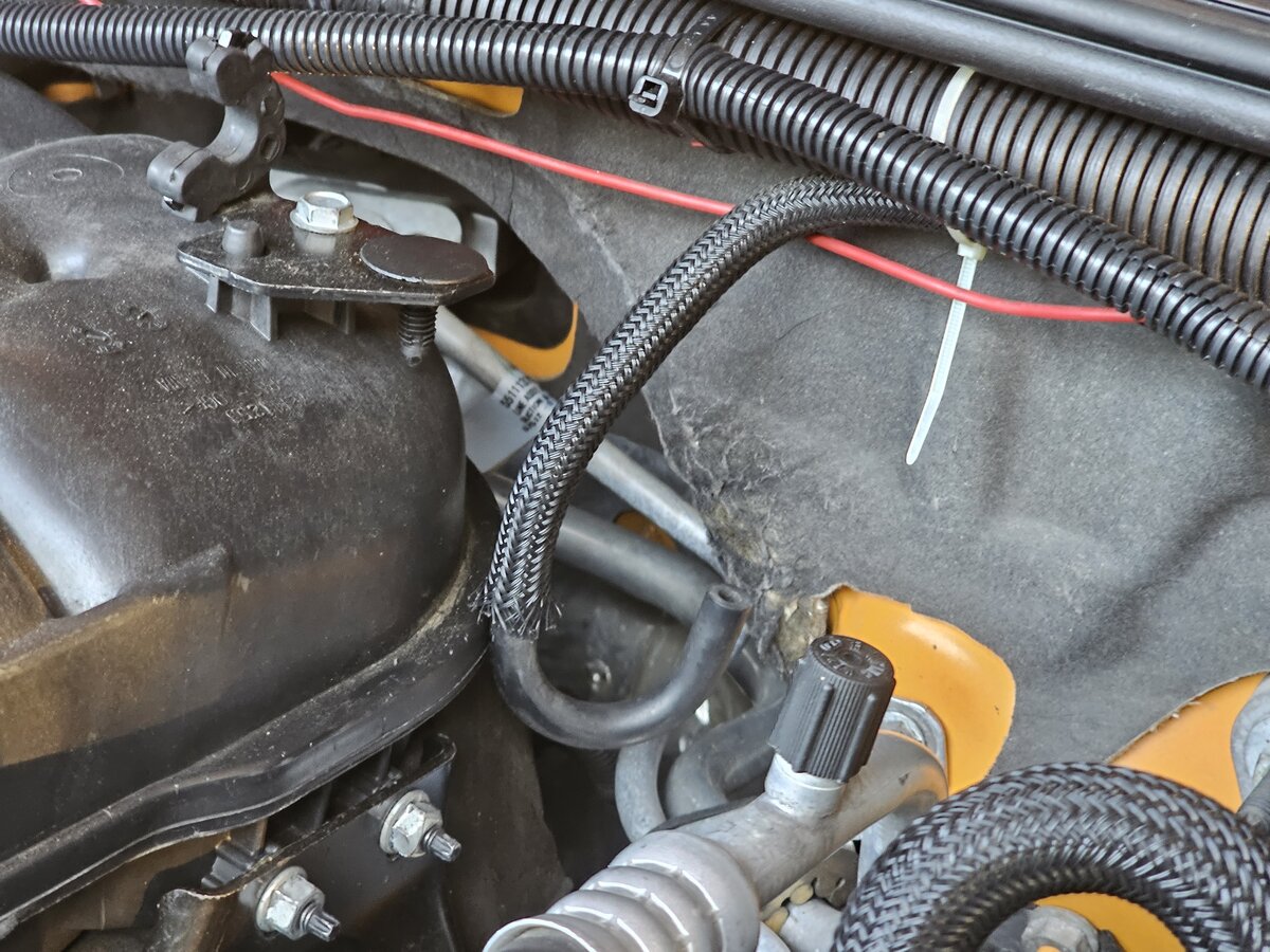

I can’t find that small hose location but what I’m pointing to is where that hose you’re looking for goes. If you have vacuum leaks that can lead to misfires too. As you can tell I’m doing the same thing you are. Think my misfires fixed but I’m trying to figure out why I get a cat inefficiency code with new cats
My evap line is just sitting on top I see yours is ran under the heater hose (which the back end black hose where the metal line runs into the rubber hose right pass the clamp, is cracked I see) if I see correctly prolly why mine is unstable someone just shoved it back there. The disconnected line goes to the underside of the vacuum pump.
Previous owner had a motor put in mine guy did a hack job as far as I can tell so mine could not all be In correct place that evap peice was sitting next to my battery
