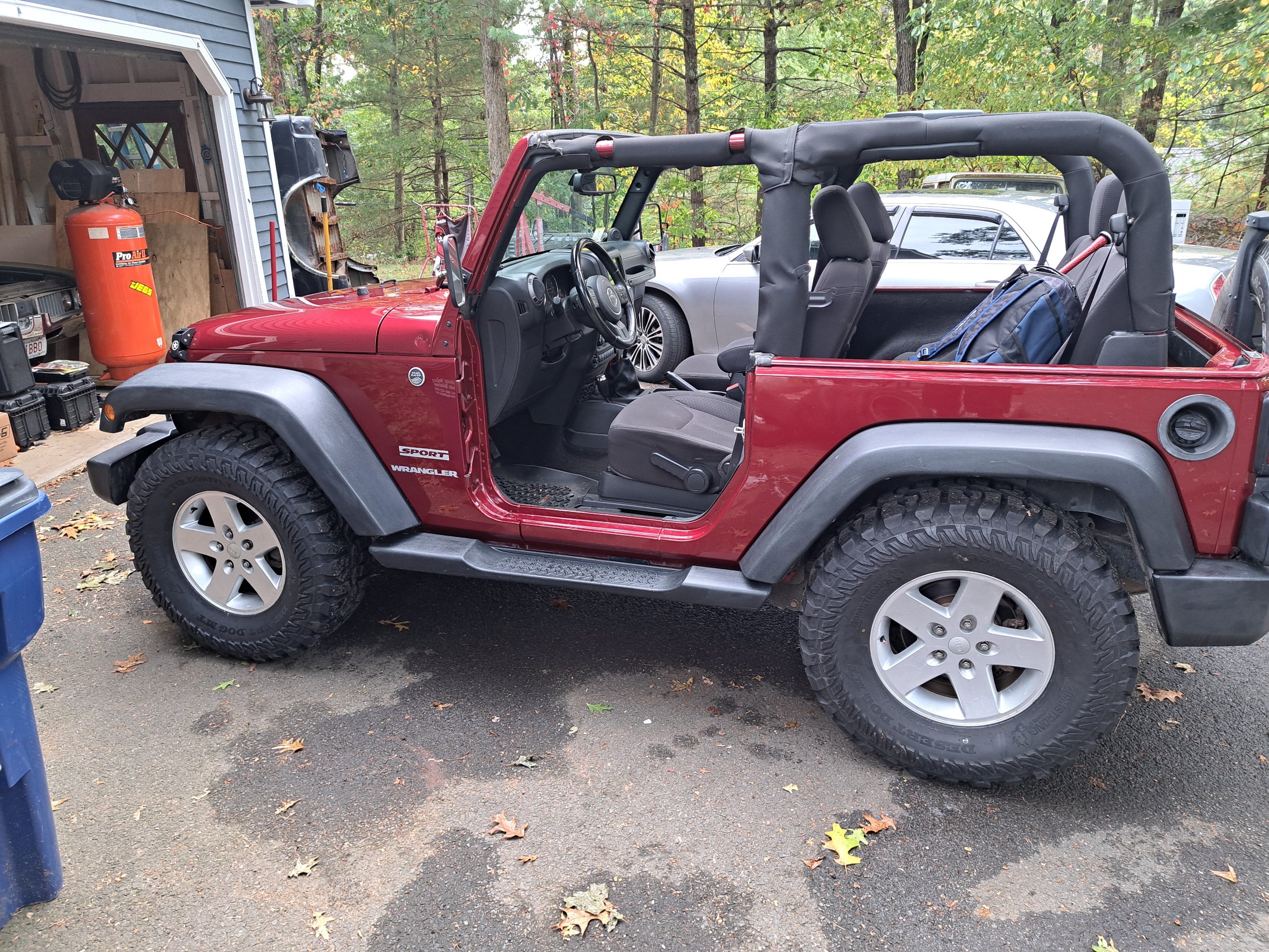

Just an update, yesterday I was able to get 35s on the stock Jeep, they look great and there is only a very slight rub at full lock in either direction. I haven't had a chance to articulate the suspension yet to see what if anything rubs but all in all as of right now I would give it 2 thumbs up on 35's fitting without any suspension lift.
Pictures? I am curious how it looks. Seems like it may be a little tight fit.
Reactions: tJKrider
Only have the one right now. I can take more with measurements if anyone is interested. I drove it a little more yesterday. Coming into the driveway it rubbed a little. Nothing awful. Couple things to remember, this is not my daily driver. Also, I plan on replacing the front bumper with a stubby one.
