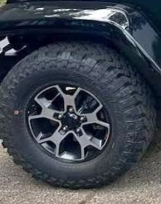

Had the same issue on my wife’s JK. I put a washer behind the jamb stop bolt solved the problem till we got her new rims.I added this tire size on our stock 2015 & I'm getting a slight rub at full lock.
I chased it down to what appears to be the sway bar on the right (passenger) side.
I'll have to dig in a little more when I have time, but I already ordered .75" spacers to level the front suspension, so I'll be under there soon anyway.
Thanks, this solved the rub issue, now I just have to put the spacers on to level out the ride.Had the same issue on my wife’s JK. I put a washer behind the jamb stop bolt solved the problem till we got her new rims.
