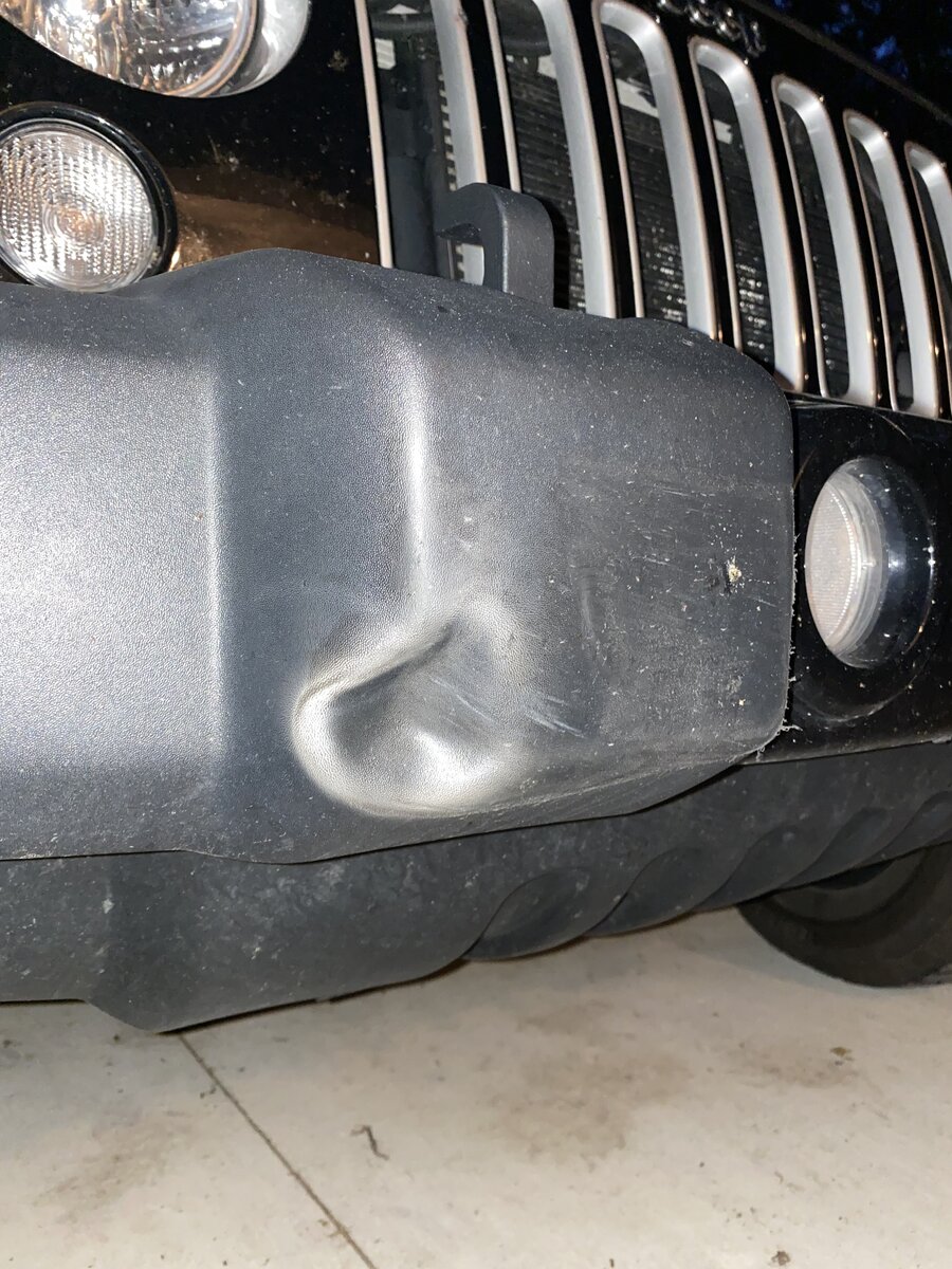

T Tom_H Member Supporting Member Joined Sep 5, 2020 Messages 29 Location mid-Michigan Jun 15, 2021 #1 While parked at my dad’s retirement community, it looks like someone backed into our front bumper. Any suggestions ? Can this be fixed ? Do I need to purchase a replacement plastic part ? How difficult is it to remove the plastic cover ? Reactions: mrjp
Lxxtsy JK Enthusiast Joined Oct 16, 2019 Messages 337 Location Somewhere on Earth Jun 16, 2021 #2 You can try and pop it out with a heat gun or just leave it. Reactions: mrjp and Qaddiction
Anybodyhome USN Retired (1973-1993) Supporting Member Joined Jun 15, 2020 Messages 1,430 Location Nashville, NC Jun 16, 2021 #3 There are a few YouTube videos which offer a couple different solutions. Reactions: mrjp
Daddyo2373 JK Enthusiast Ride of the Month Winner Joined Jan 2, 2020 Messages 144 Location Greenville, SC Jun 19, 2021 #4 You should be able to remove the bumper and then remove a metal piece to access the plastic part, or you can drill a small hole and use a screw driver or allen wrench to pull I back out. That's what I did on our rear bumper.
