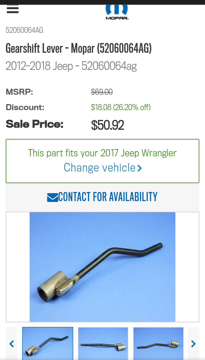

So, I went into the Jeep dealership to get a PCV valve for my 2007 JKU. The local/well-known to the local Jeep community parts guy helped me. He used to have a 2010 JK manual and we got to talking about gearing, ect. Then it reminded me I needed a lower/inner shift boot for my manual NSG370. It's been ripped since I bought my Jeep a couple of years ago.
He ordered me a lower shift boot. I was telling him that I'd have to order a new shift knob because I couldn't get the damn thing off last year when I wanted to change the upper boot to a leather one AND I need to take it off to install the new lower boot.
He then proceeded to tell me that he put a 2017 gear shift lever on his 2010 and it made a HUGE difference. He stated a few things:
1. It was stiffer and did not shake as much, maybe do to the isolator at the end where you bolt it (T45 torx) to the shift tower.
2. ERGONOMICS: he said that it was way more comfortable to drive, without having to go way to the right for 6th gear and hitting your passenger's leg when you shift into reverse.
3. His Jeep popped out of 1st gear on a slight occasion and it didn't after the replacement. I have it occasionally too, but I think only once since I regeared from 3.21 to 4.56 gears (don't know if that has a correlation.
So, I went home and researched it. Looks like there is a drastic difference in the way the gear shifter bent. And, I just trusted him with his results. I called him up and he ordered them (gear shift lever and knob).
Picked them up today (lower boot, shift lever, knob (gotta order a 12-17 knob also, because it won't fit the 07-10)).

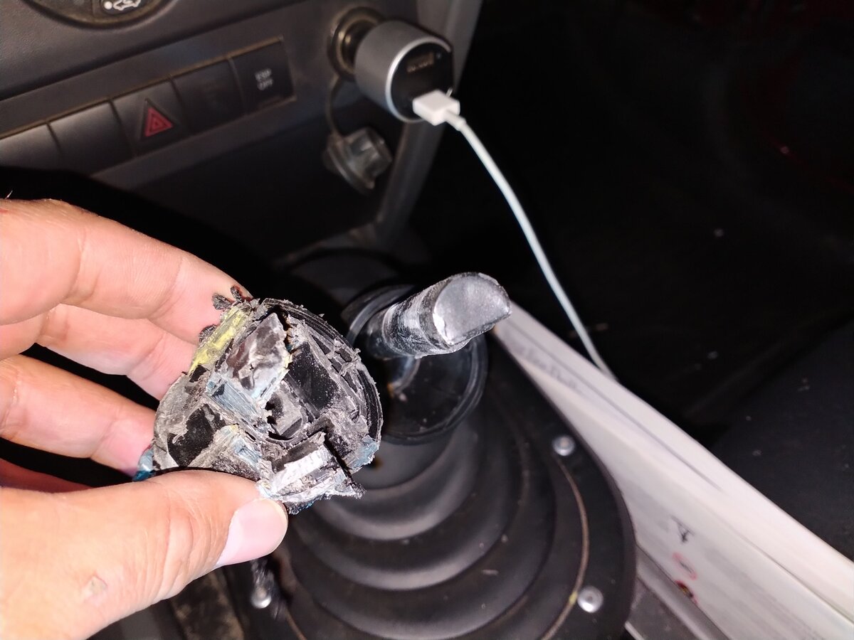

I had to use a (don't laugh) jig saw to break the knob apart and take it off. See pic below, bitch was thrashed and it seemed as if it was glued on. I tried everything before... Every method on YouTube, except for the guy that used a rope and a hoist. That shit is just crazy.

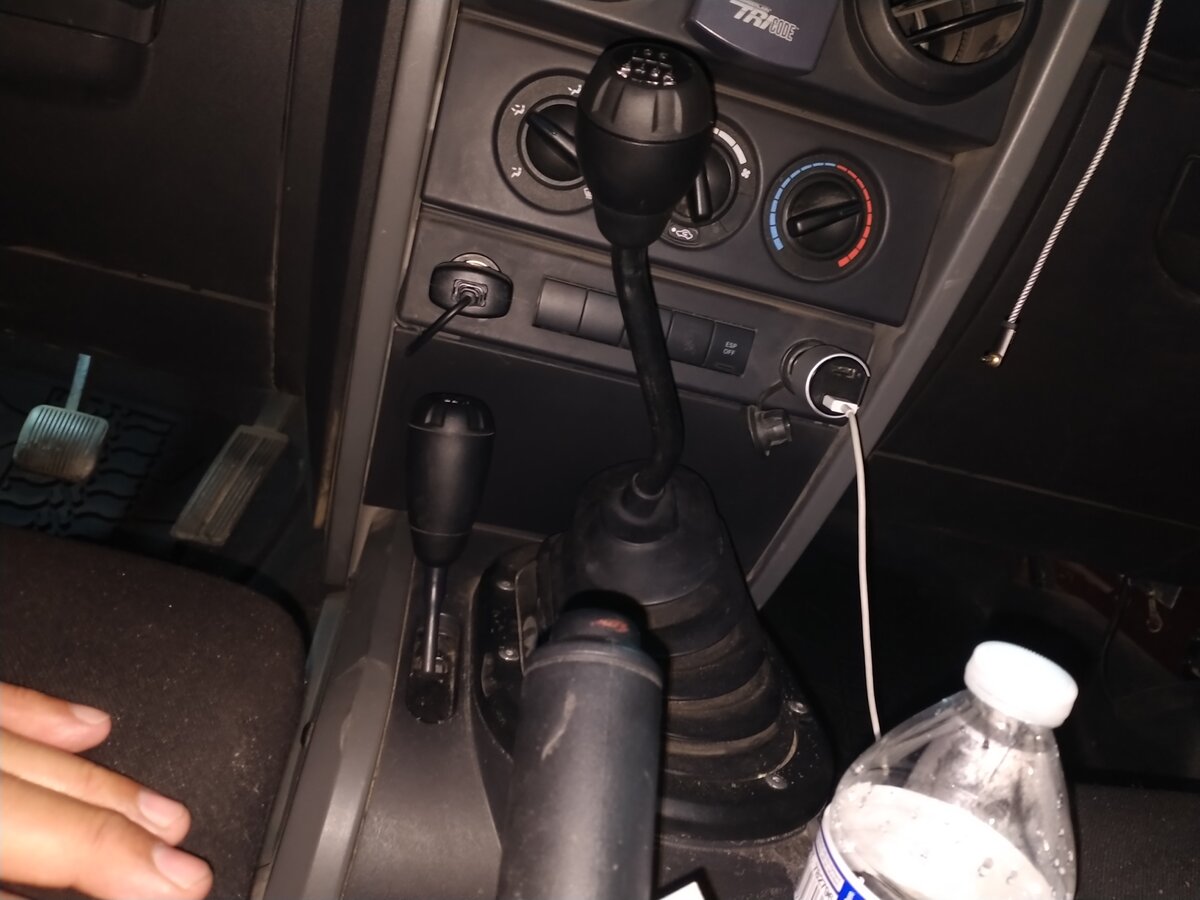

Holy smokes, what a difference!!!!! Here's what I noticed:
SHIFTING: More solid and deliberate. I feel the gears a lot better going into gear when shifting.
ISOLATOR: I couldn't visually tell the difference from the new to the old one. But it feels a hell of a lot different - TREMENDOUSLY LESS VIBRATION FROM THE KNOB/SHIFTER LEVER, SOFT - BUT FIRM FEEL.
KNOB/SHIFTER POSITION: Before, if I had a bottle of water in the cup holder closest to the shifter, I'd be on top of the bottle cap in 6th gear. Now, in 6th, I'm about 2" to the left of it. The knob is closer to me (by about 2") and it makes a world of difference in a good way *insert "that's what she said" jokes here*
SHIFTING: Feels more positive, smoother and deliberate, maybe even shorter... but, that might be in my head. Although the isolator where it connects to the shift tower looks and feels the same as my old one, it's definitely better.

Pic 1: The part/part number.
Pic 2: The gear shift lever/knob installed.
Pic 3: The cut up knob that wouldn't come off. If you try to take yours off with a few good yanks and can't get it - CUT IT and buy a new one - it'll cost less than taking ibuprofen for a while when you pull your back out 🤣🤣. It should come out with a quick, firm twist and pull. I accidentally put the new one on and forgot to put the boot on.. got too excited. Came right out.

There was no choice. Been trying to get it off for a YEAR. I think it may have come loose in the past or something and the previous owner glued it maybe. Since I had a new one, I even took channel locks and got western on it... I'm not the weakest guy either.
The sawzall was too dangerous, it was flinging the gear shifter out of gear. Went to the jigsaw and it was like a smooth surgery.... then I took the channel locks and broke things to get it off. The rest of the install took 5-10 min.
