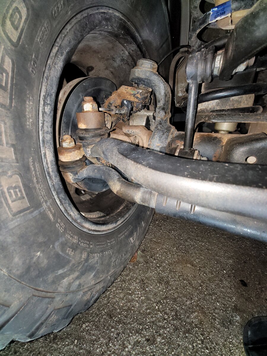

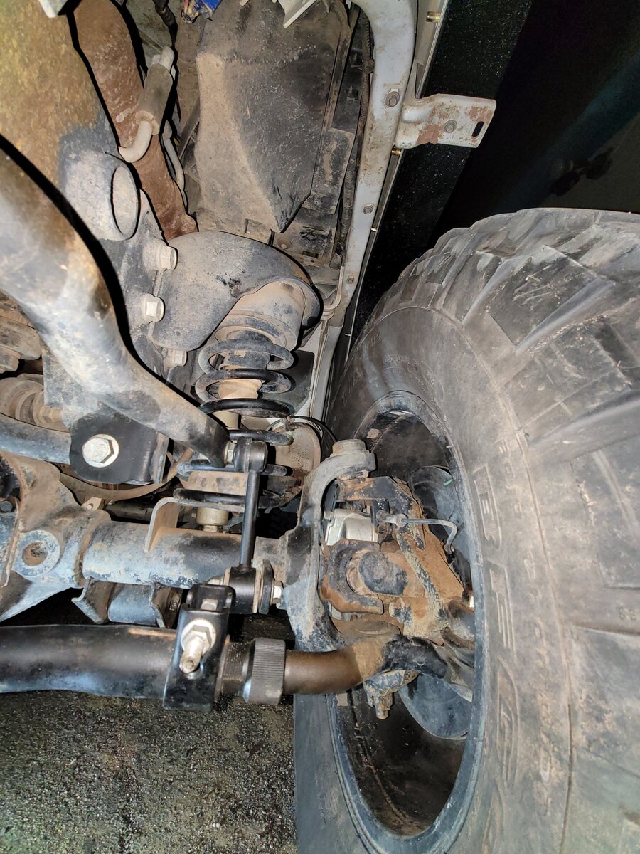

Posting pics for others who may get the wobble. Missing the balance weights on driver wheel, some on rest of the wheels and the rubber on front ball joints look shot. Tires are worn. Never knew these would cause such bad vibrations at 45mph. This forum helps alot. Suspension and steering bolts are tight, and no play with bearings or wheels at all.
