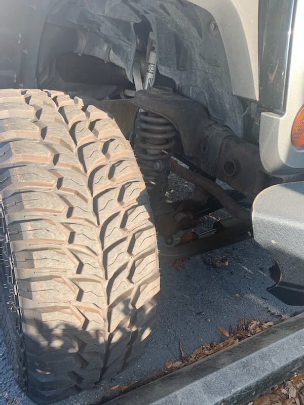

Hi vman, looking at replacing the suspension tie rods, steering clock, abs sensors and wheel bearing would that tighten up the steering wobble, also it’s for a tow behind an Rv. Would you have the transmission and axle fluids swapped .

Check the VIN for the clock spring. There is a major recall on the early year JK's so you may be able to get that one done for nothing.
You can spend about $1.5k and get top of the line aftermarket drag link, track bar and tie rod. Replacing all of them yourself with stock parts would cost around $500 I think.
A top of the line steering system, including a gear box, is about $1.7k. You can get a stock replacement gear box for about $600.
You could replace the knuckle ball joints and front wheel bearings for about $400.

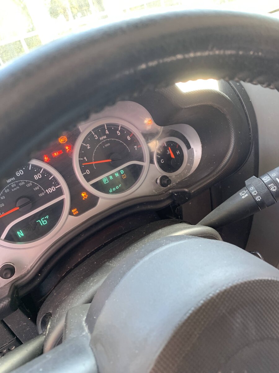

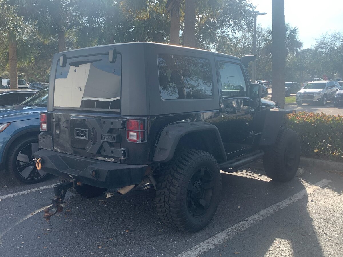

Thanks for all the input and advise inc the walk away part, the Christmas tree lights appear to be all suspension, brakes, abs wheel sensors and possible clock sensor, just from what I’ve read, it’s been in the swamp not too bad with rust and neglected recently, my thoughts are any Jeep I buy needs all of this around the price I have 8k. I’m buying one to tow behind an RV… with that being said how much abuse will it get being towed behind and and what suggestions on the above items which are on the dash need immediate work to ensure it doesn’t wander or lock up behind the Rv. Thanks
It's the same as flat towing any 4x4 with a solid front axle.
If it were me I'd make sure it's driveable before trying to tow it. You'd need to make sure all the steering components, driveshafts, transmission, transfer case, wheel bearings, ball joints, diffs, etc etc were all good to go first. You don't want it locking up or having death wobble while towing it.

Hi vman, wheel bearings and drive shafts is that one piece , brakes rotors looks straight forward and could go aftermarket on the existing suspension. Parts see attached
Hi vman, reading the below and looks like all would need to be replaced to ensure safety and no chance of death wobble, not sure the 8k is such a good deal
Unless you're looking at a much newer model it would all need to be replaced anyway. Stock cost for new drag link, tie rod and track bar is about $500. I spent closer to $1500 for top of the line aftermarket stuff, replaced the entire steering system, and got it regeared all in (inc purchase price) at that $20k mark. That includes all of the other little stuff like replacing sensors and gaskets as well as replacing the flooring system with Armorlite.

Thanks for weighing in, with it being at a dealer not sure they will go down further than 8 I thinking it needs 2k to clear the errors with just doing rotors brakes any of the suspension and sensors bushes etc which are worn out, that not thinking of any drive shaft or axle things

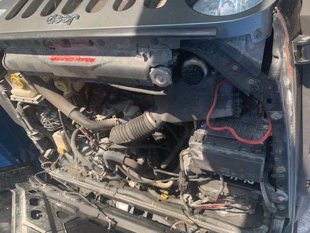

I call BS that they don't have a code tool. Ask at a local O'riellies or something like that if you can borrow one. Explain the situation, you may need to leave a deposit or phone.
My understanding for when all the lights are on is that a big thing is wrong and not necessarily what the lights are telling you. The brain could be failing, or it could be as easy as a major ground. Codes can at least give you an idea. Take a pic with your phone and look them up yourself, or bring them here.
