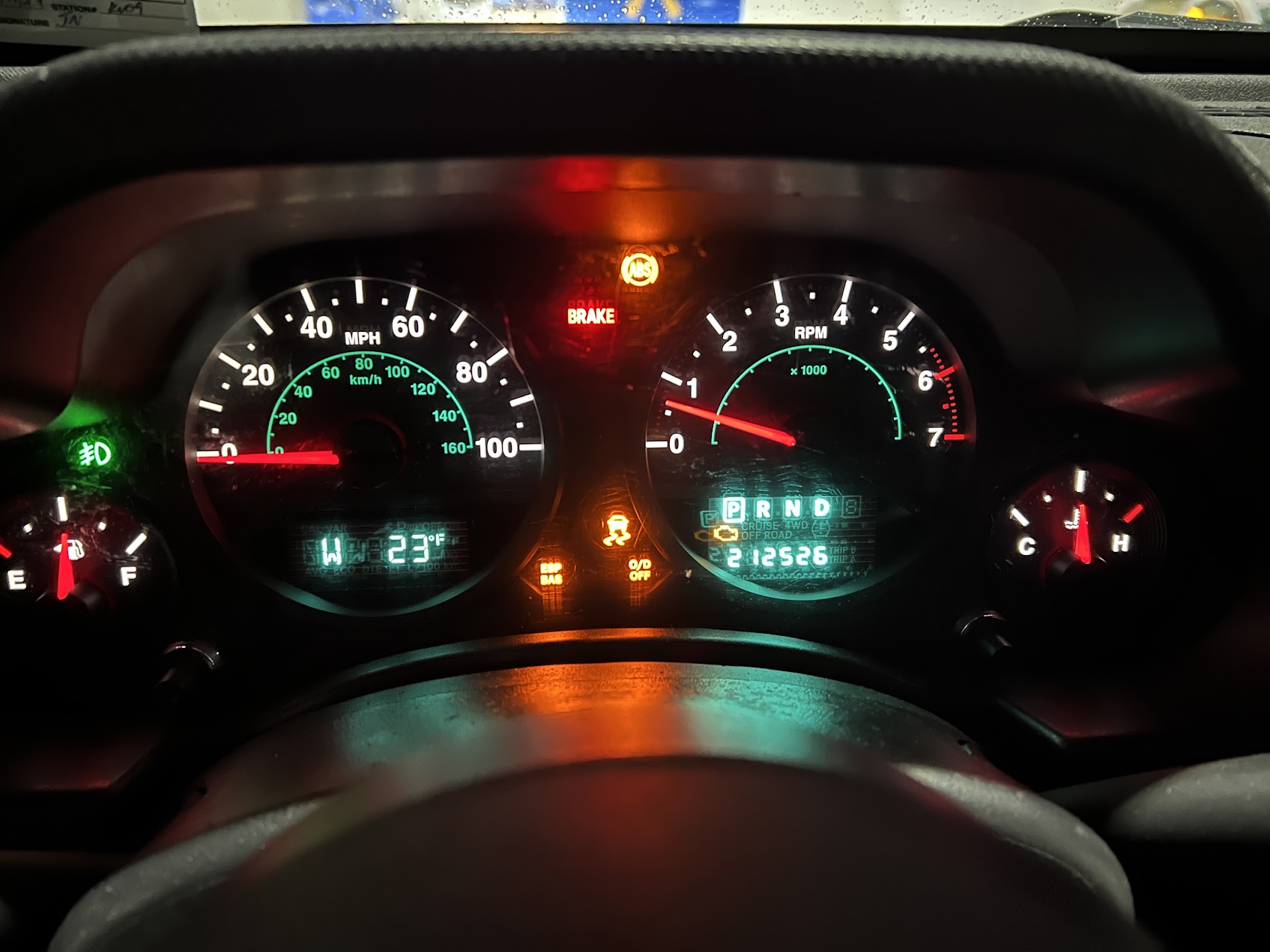

I did run into a slight issue with the Jeep. During one of the snow storms, I was coming up my steep and freshly covered driveway. It caused the traction control to engage, and likely the BLD, and eventually made it up without much issue. About a day or two later, I was driving my Jeep to the school to pick up my son, and the dashboard lit up like a Christmas tree...
I thought maybe I had ripped out a sensor while I was slingin' snow getting up the driveway. I did a walk around and nothing looked wrong. Parking and turning off the Jeep reset everything and it appeared fine. However, now every time I drive, once I get above 10-11 mph, the Christmas Tree lights up again. It was extra cold and a snow-filled few weeks, so I figured I'd just let it go and deal with it once the cold snap ended.
Fast forward a few days and I was driving through town, stopped at a stop light, and my horn started blaring, my windshield washer pump squirted for 2-3 seconds, and the wipers started. By the time I realize wtf was happening, it all stopped. However, the transmission would not shift out of 2nd gear. It would go into PRN and D, but it would simply not shift out of 2nd gear in D, 2, or 1 on the shifter.
A few days later, while I was parked in my friend's driveway, the horn started blaring, washer pump sprayed almost the entire container dry, and the wipers were going nuts. The Jeep also turned the motor off. I turned the key off, everything stopped, and when I restarted, it was like nothing happened.

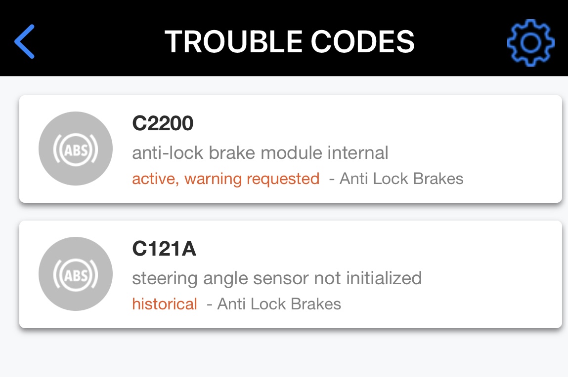

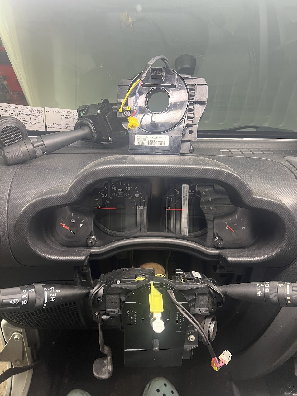

Got the Dorman Clockspring installed, as well as the new turn signal, and although it no longer clicks when turning the wheel, and my turn signal actually stays locked during a turn, it did not fix the error with the ABS/Christmas lights.
I'm about 98% sure it's the ABS module at this point in time. I found an older forum post where people were giving some advice on how to test. If i restart the Jeep (which resets all the ABS lights) and mash the gas on a dirt road, the traction control kicks in and does its thing. Continuing to accelerate past 10 MPH and the ABS/traction light stays off. If I brake hard on dirt (to engage) ABS, the lights come back on and the system is disabled. I can repeat this many times and the same thing keeps happening, suggesting the fault within the ABS module. Looks like that's my next thing to replace...

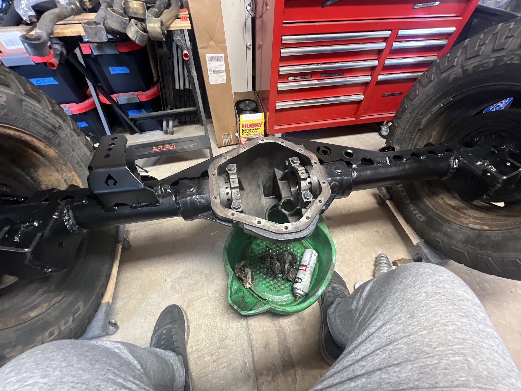

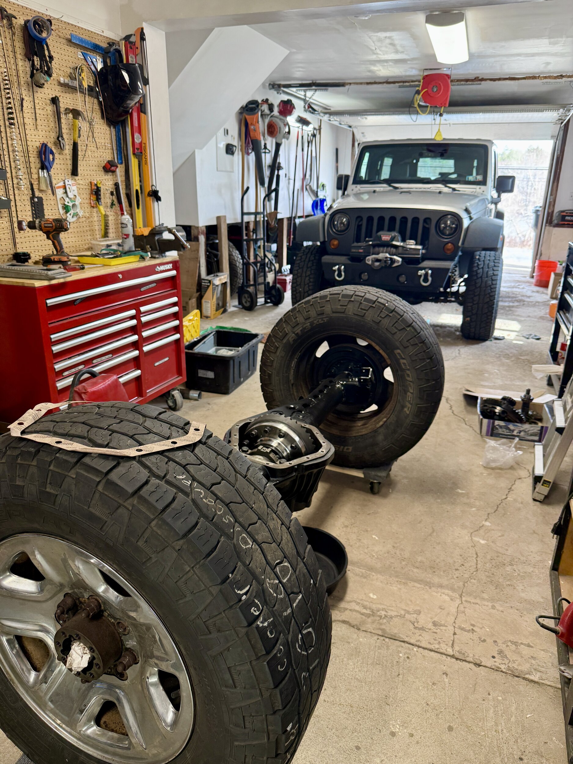

The weather appears to be breaking some, so I began prepping the 14B for gears. Got the housing stripped and cleaned out. I can't find my Wheatstone set, so I had to ordered some new ones from Amazon. Once those get here, I'll finish prepping the ring gear and new Richmond Powertrax Pro Grip carrier. I hope to have the gearset fully installed this week and can then move to getting the hubs machined for the tone ring.

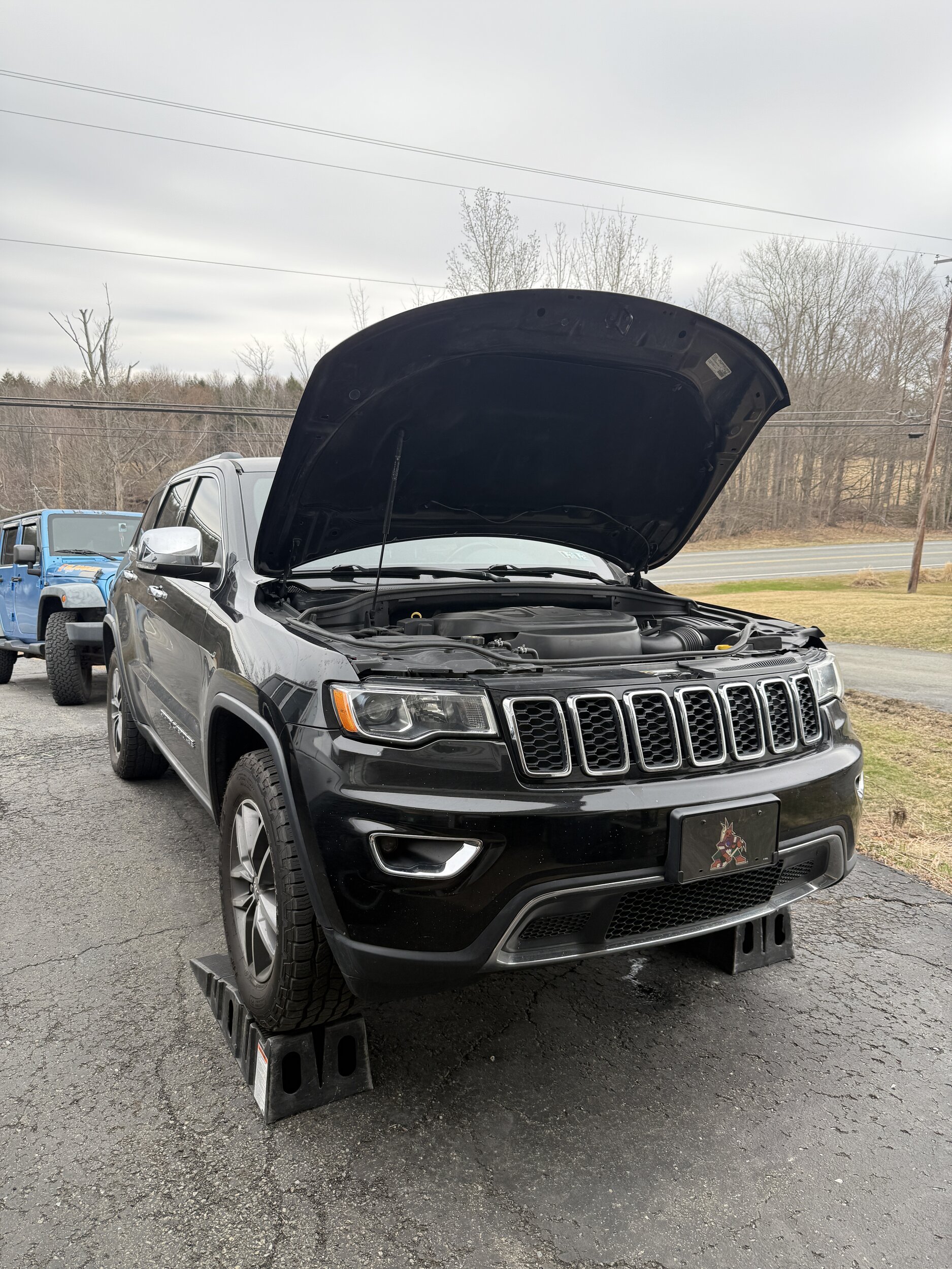

Had a busy weekend - the Mrs. grand Cherokee just rolled over 100k miles and to thank me, it started to leak at a seam on the radiator…
Thankfully, a new Mopar unit off eBay was relatively cheap (~$300) and quickly delivered. Swapping it out wasn’t as much of a nightmare as I was expecting, taking the better part of 3 hours (I had to start/stop a few times to deal with other things).
I wrapped it up just before dinner time on Friday, which was good because we spent the next day racking up about 400 miles on a college visit to UCONN. Nothing like stress testing a new install right away :)

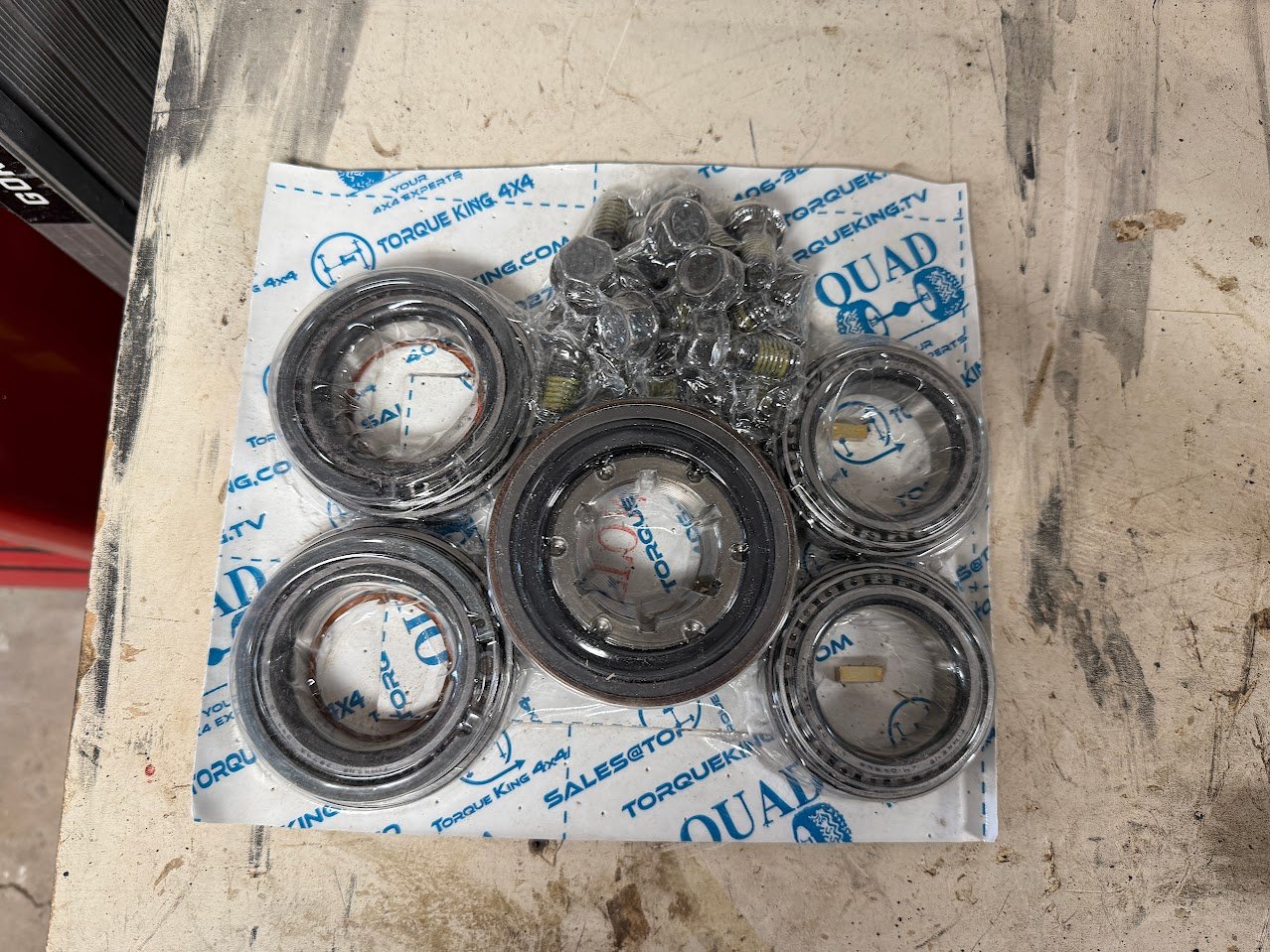

Other than having to drive back to AutoZone twice in one night - first to get a 7-ton puller (my 5-ton was about 1/4” too short!) to make pulling the yoke easier and the second to get a chrome 1-1/2” socket for the pinion nut (my 1-1/2” impact socket wouldn’t fit inside the new 1350 yoke!!), the setup was easy. Gotta love 14 Bolts…

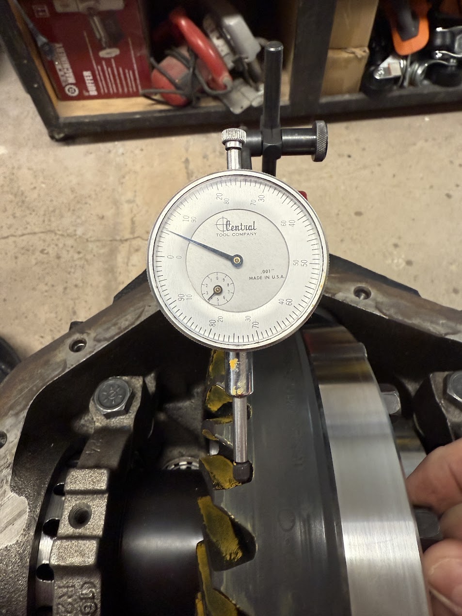

I was able to get the pinion preload near perfect at 35 in-lbs with the Yukon Solid Spacer setup from East Coast Gear. I landed at ~0.0055” BL, have no perceptible runout, and got a fairly respectable pattern - I shouldn’t have any issues with this install.
Next up is putting a thin coating of oil on the gears and carrier bearings, then pulling the hubs off to knock the studs out and hopefully find someone local who can machine them for the tone rings. With any luck, I’ll bolt these axles in by the end of the month!

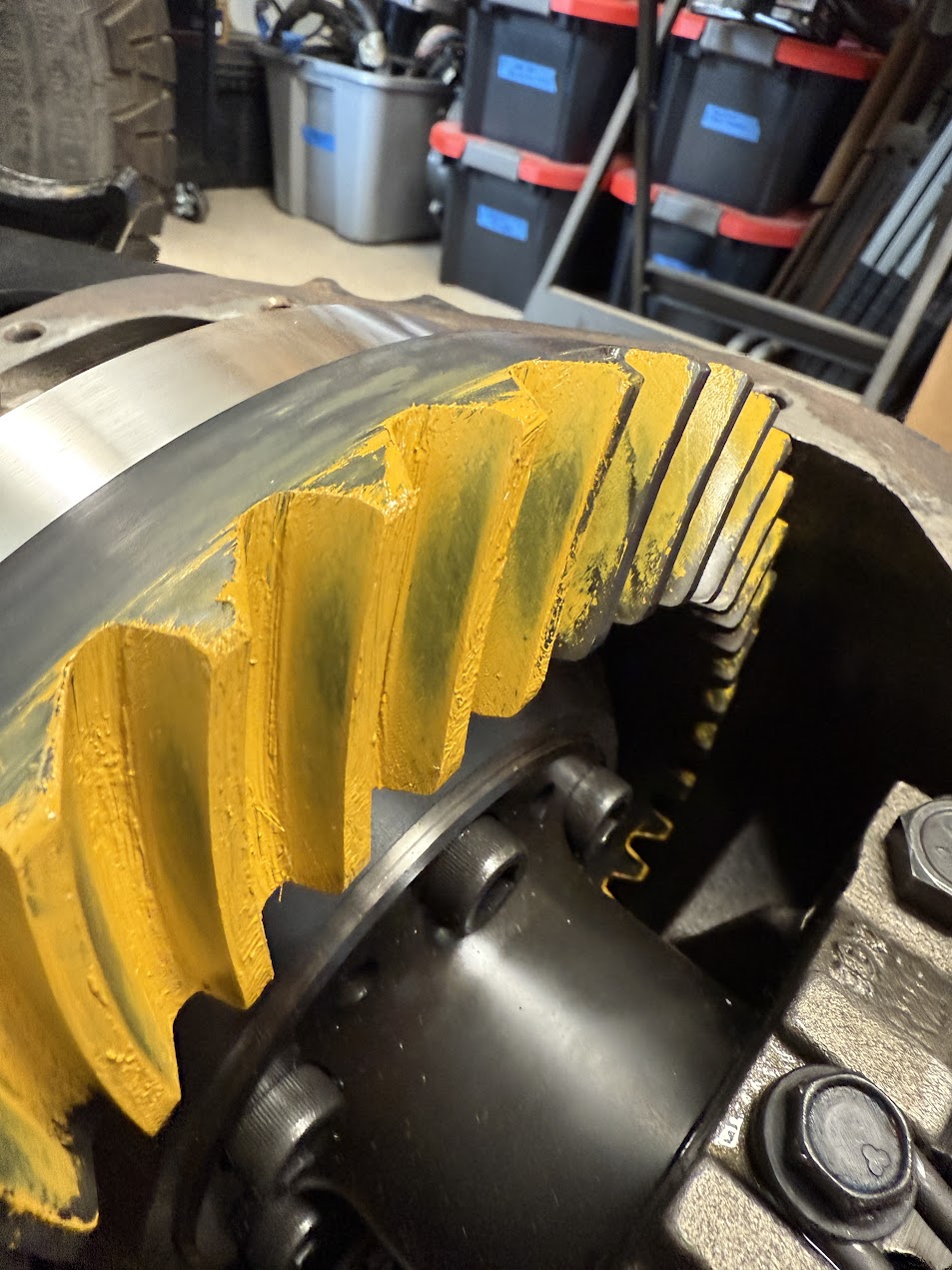

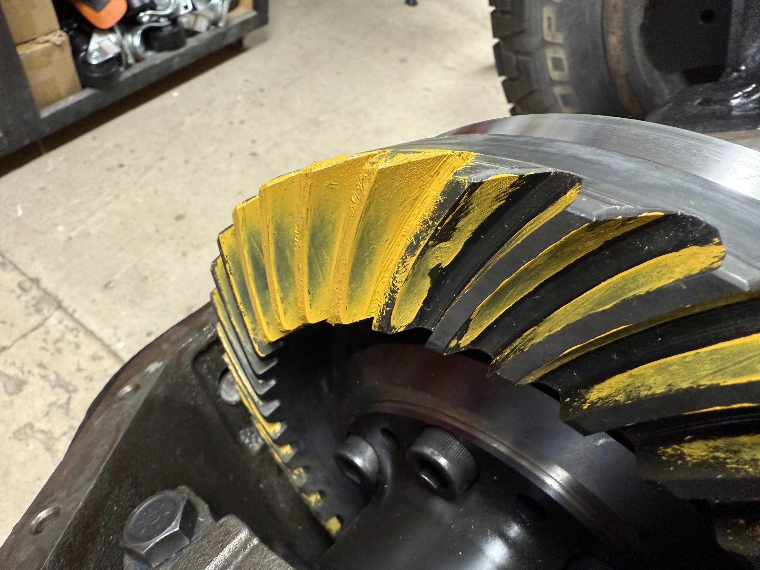

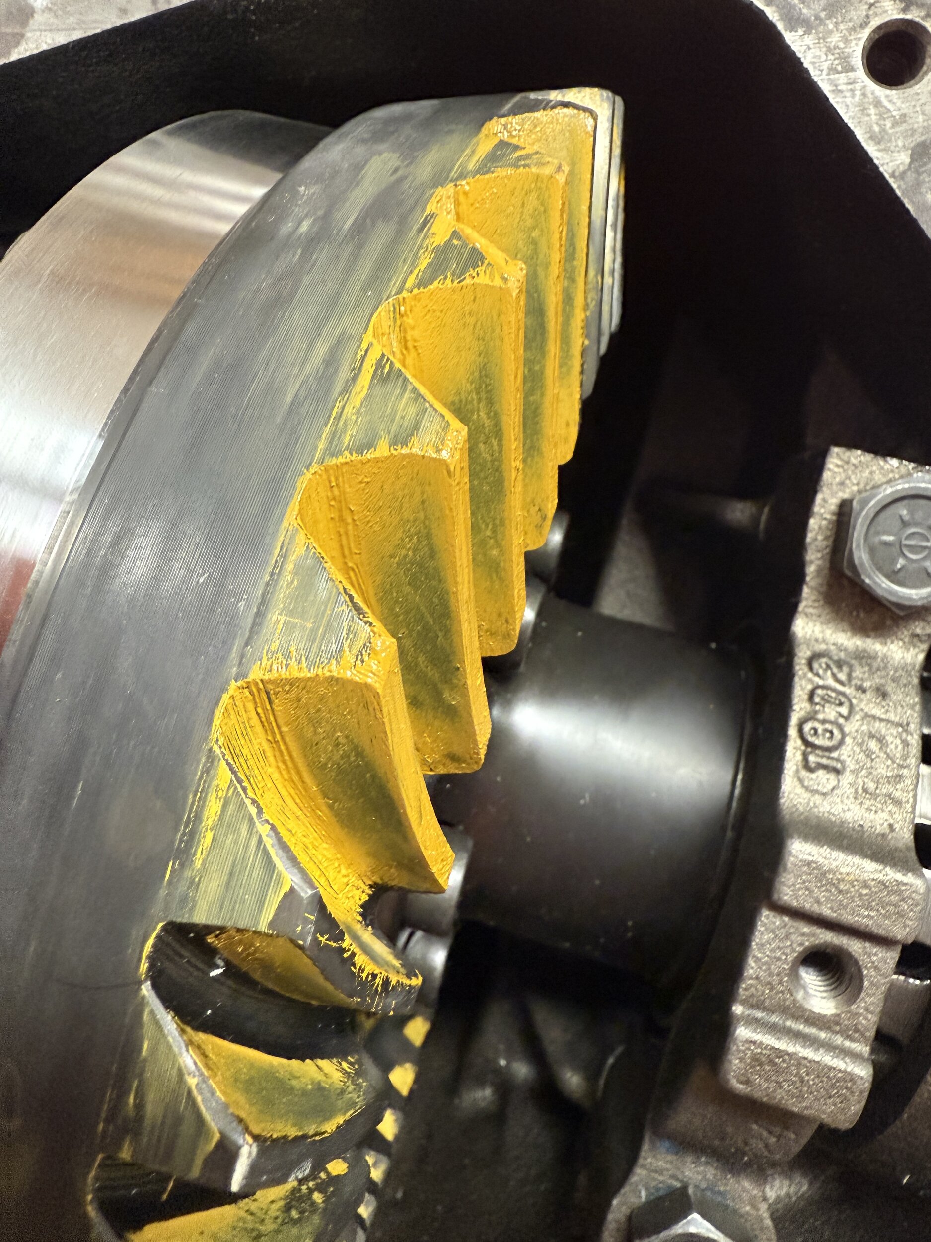

As I usually do, I did a final check after torquing everything down and setting the proper carrier preload. The final setup ended up at ~0.006" of backlash...
I got about a good a pattern as I could hope for with gearsets these days:
I always take final setup photos and show my shim stacks, just in case I ever need to do a warranty claim. It also makes a handy reference should I need to regear it again for any reason.

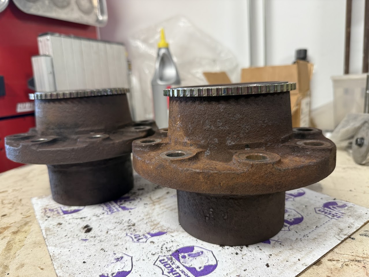

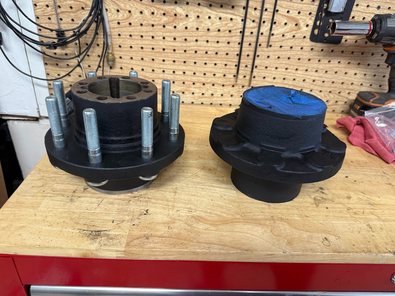

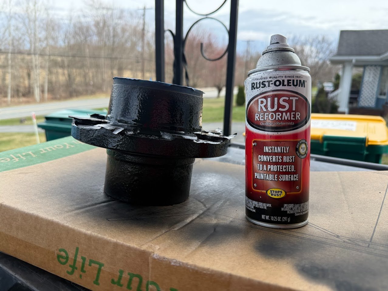

I've got the hubs scrubbed, steel brushed, and soaking in rust converter/remover. With any luck, the new hub bearings will arrive mid-week and I may even be able to get this thing moving sooner than I had hoped...

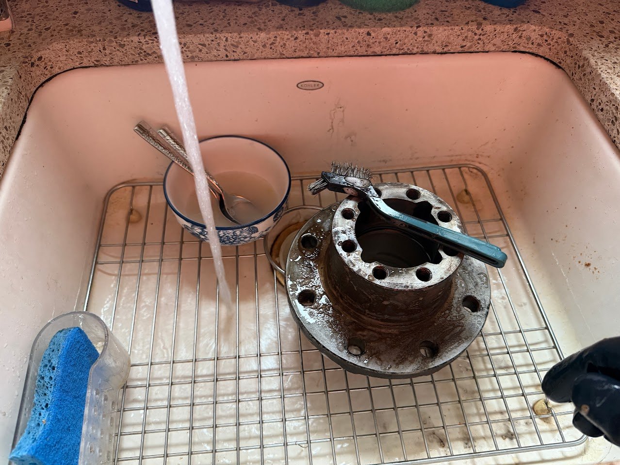

Don't you just hate when you're washing your rust-remover soaked hubs and the kids put their cereal dishes in the sink??!!?? Kids these days...
After soaking for 2-3 days each, then scrubbing aggressively, followed by a nice bake out in the oven, I hit each hub with some Rust Reformer and some black high-heat paint. I was hoping to get these all done and reinstalled so I could install the ABS senor brackets and drill the holes, but Torque King 4x4 took a little while to get me one of the seals.

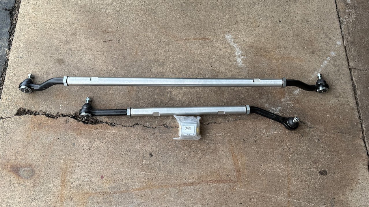

The Fusion 4x4 drag link and tie rod showed up at least - these are beefy for sure!

The bearings arrived, so I took a few minutes to get some paint on the hubs, get the new studs pressed in, and get the bearings installed...

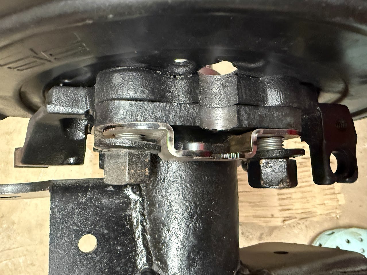

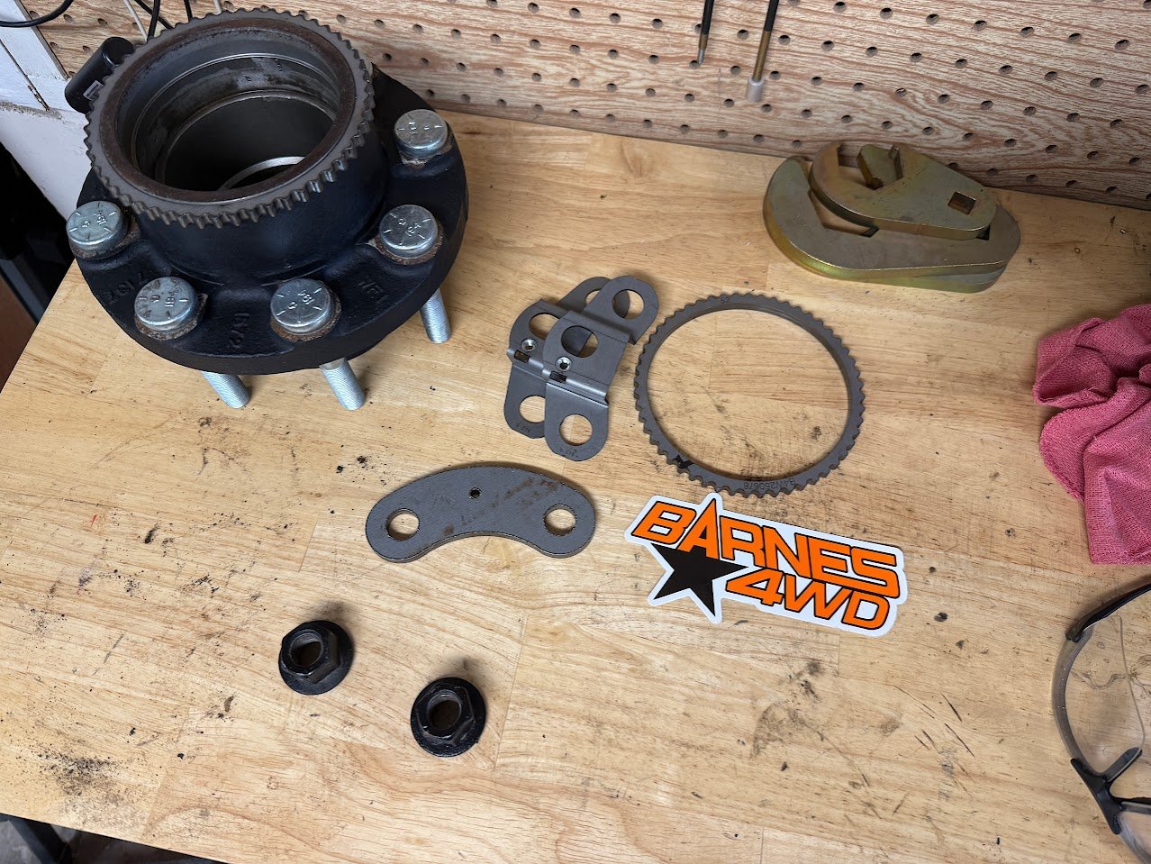

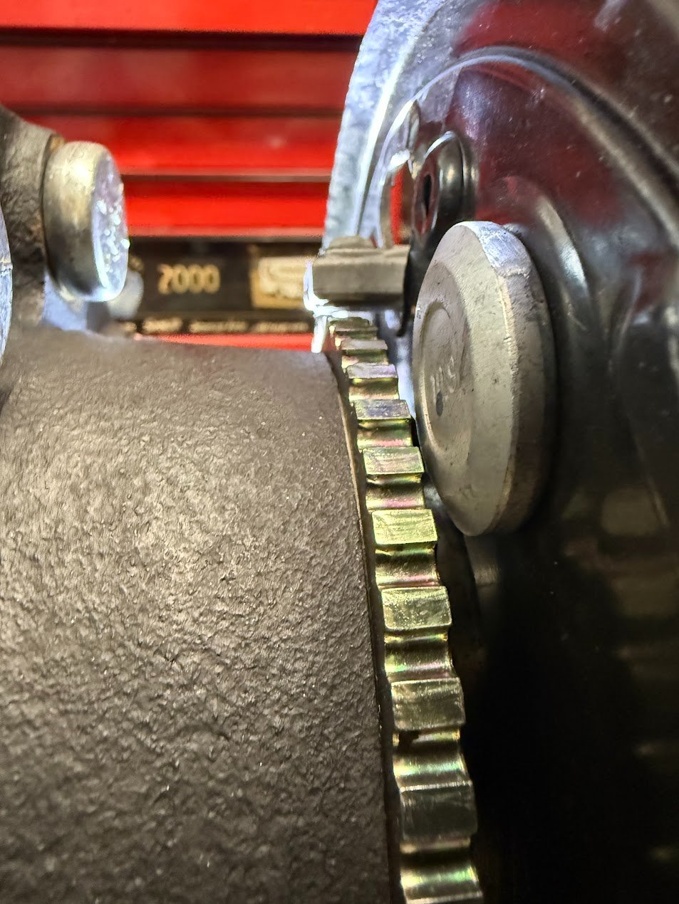

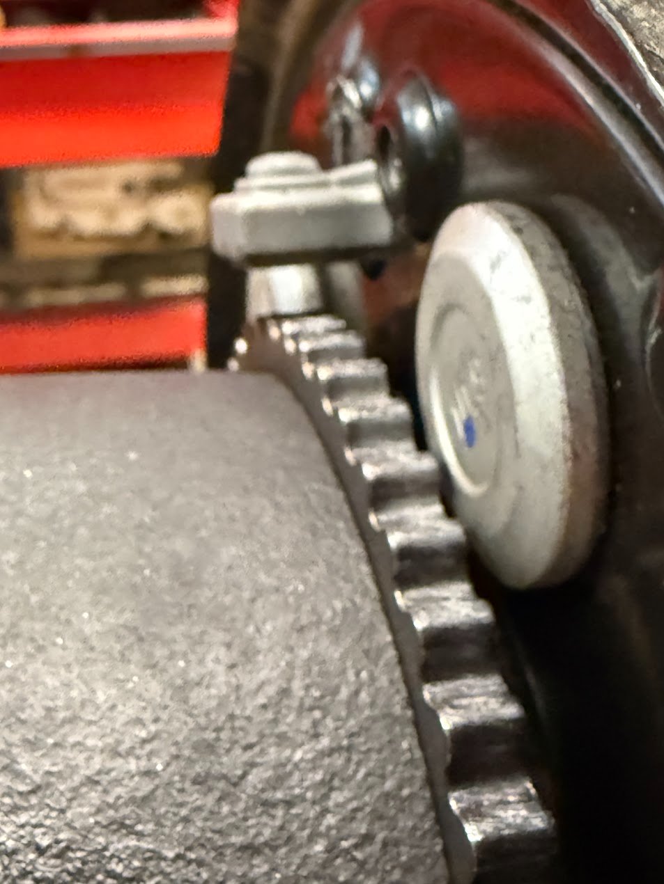

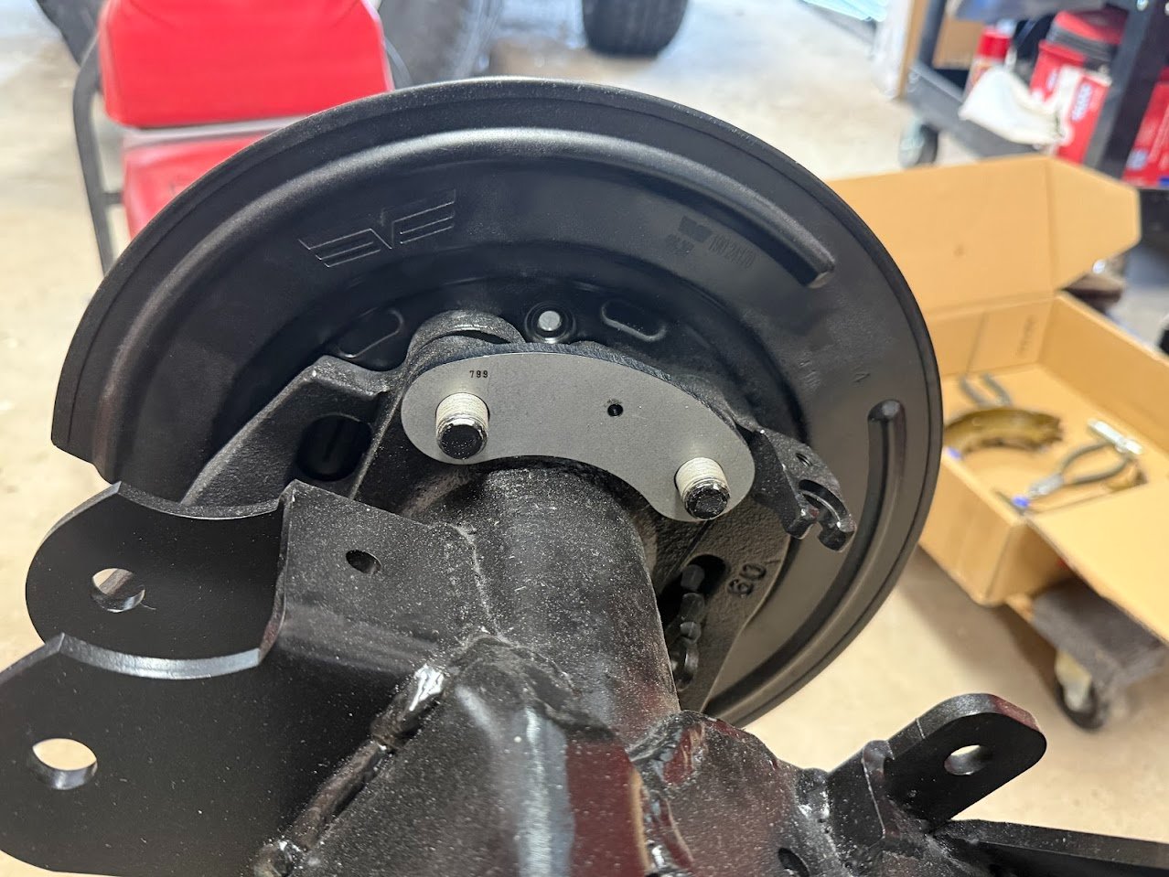

Although I had a set of Artec VSS mounts and tone rings, I bought a set of Barnes 4WD VSS mounts and tone rings on a holiday sale. I liked that it also included a "drilling template", which I thought would be helpful...

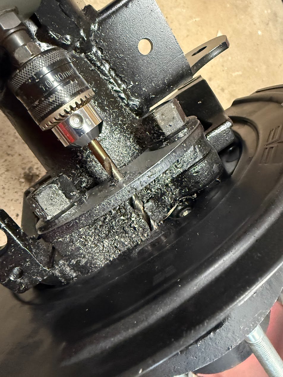

I saw a few "tips" on various forums where they suggested to not follow the instructions (which wanted to you drill the template out to 3/4" and then use that as a drill guide) and instead use the 1/4" hole to make a nice pilot guide for a 3/4" hole saw:
This process worked well and cutting through the dust shield, backing plate, and housing flange cut like butter with a fresh carbide hole saw. Unfortunately, even with the hole drilled perfectly aligned, the VSS was nowhere near where it needed to be:
We are talking millimeters off! I thought maybe the mount was installed backwards or upside down for a moment. I decided to try the Metalcloak VSS mounts and I couldn't even get the VSS inserted as it was still about 1/2" blocked by the axle flange. Needless to say, I spent a good amount of time clearancing the flange and backing plate to get the VSS to fit. Once I made enough room, the VSS dropped in place and was in perfect position (using the Metalcloak mounts!):
So for those looking to do it, I would say skip the Barnes kit completely as they simply are not made with enough precision to be helpful. With the VSS sensors cleared and installed, I had to make my parking shoes fit around the tone ring. You can see below just how much has to be taken off the inside edge of the shoes. All you need to essentially do is make the inner circle a "true" circle.

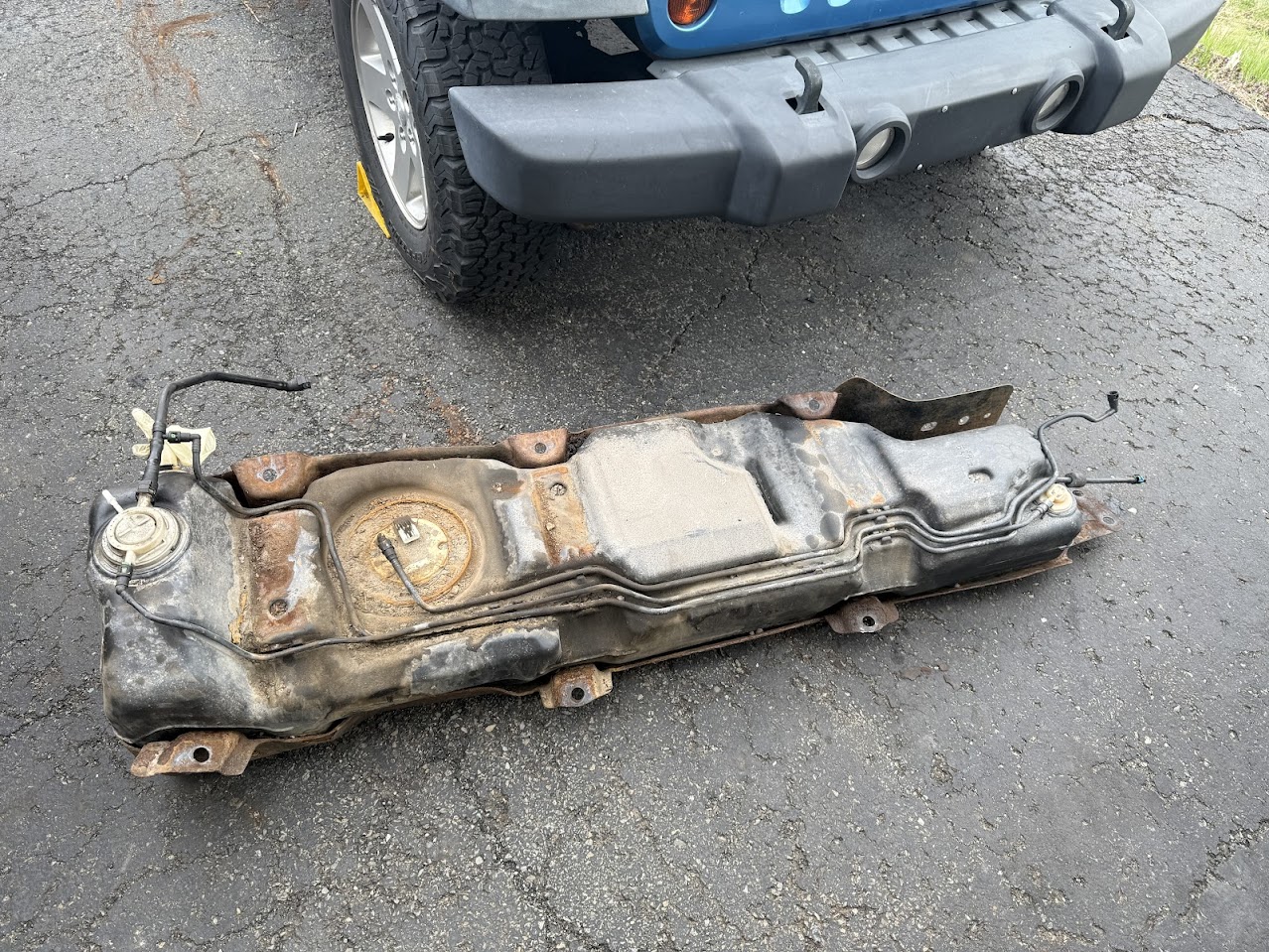

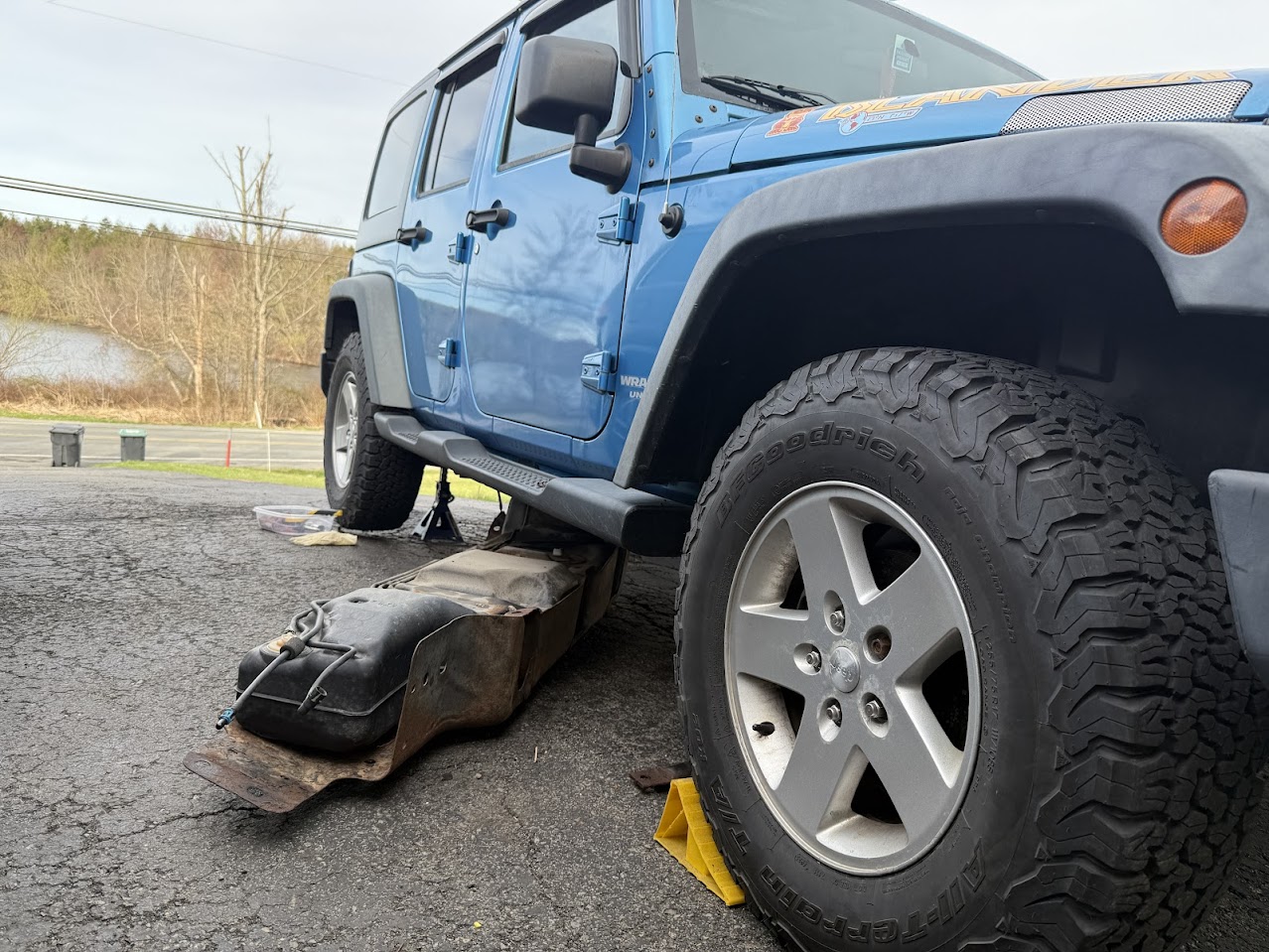

My daughter's Jeep has been smelling like gas fumes here and there. Some days are better than others - where some days it smells like a spark from across the county will cause a boom, and some days you can't smell anything. I've checked the hoses, including the nefarious roll over vent nipple that tends to crack, but there weren't any issues visible. I found a used tank for $250 and picked it up before dropping the tank just to make sure I could fix it in quick order...
Unfortunately, getting the tank out was a pain in the a$$, requiring me to cut one of the bolts out of the frame mount. Additionally, there was a lot of corrosion on the inside of the tank skid, where knocking the rust loose actually caused a hole to form. I ended up having to place an order for a new skid with Amazon, and picked up a new Delphi pump while I was at it.
There were no broken nipples and no cracks to be found, but literally "smelling" around the tank suggested that maybe the seal around the pump is what was causing the odor (which explains why the smell sometimes is fine, and why sometimes it's terrible). Anyways, gives me a chance to clean the frame up while I was down there...
There is a ton of scale and rust on the rear shocks, though nothing cancerous really anywhere. I suspect the PO's parked on a lawn a lot, which is where you usually see that level of scale develop. Hopefully, I'll be able to clean this all up this summer, since I'll be doing lots of driving next year while my daughter is in college and I start the Hemi swap on my Jeep :)

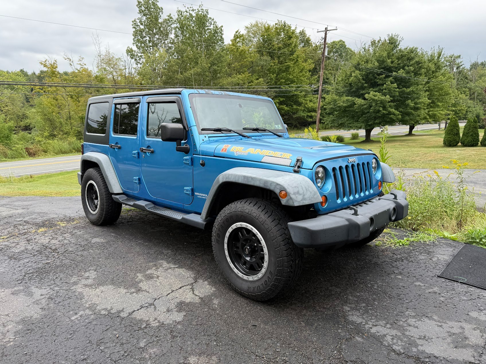

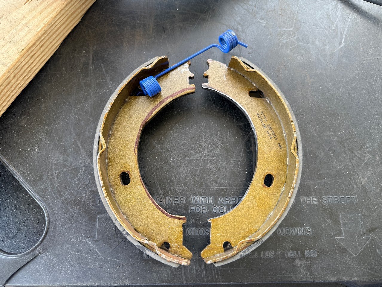

We dropped my daughter off at school on Friday, which means it was time to roll my Jeep into the garage and start the tear down...

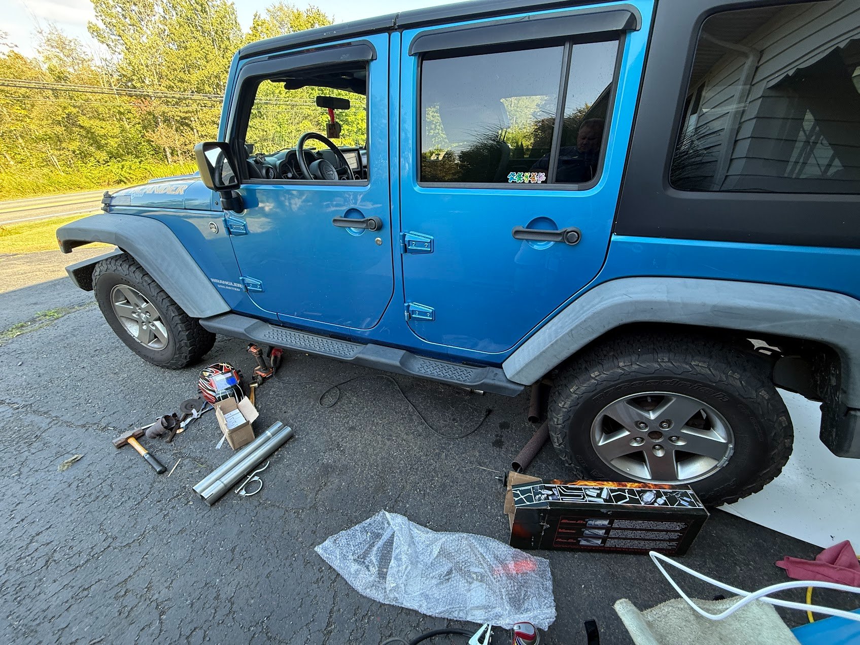

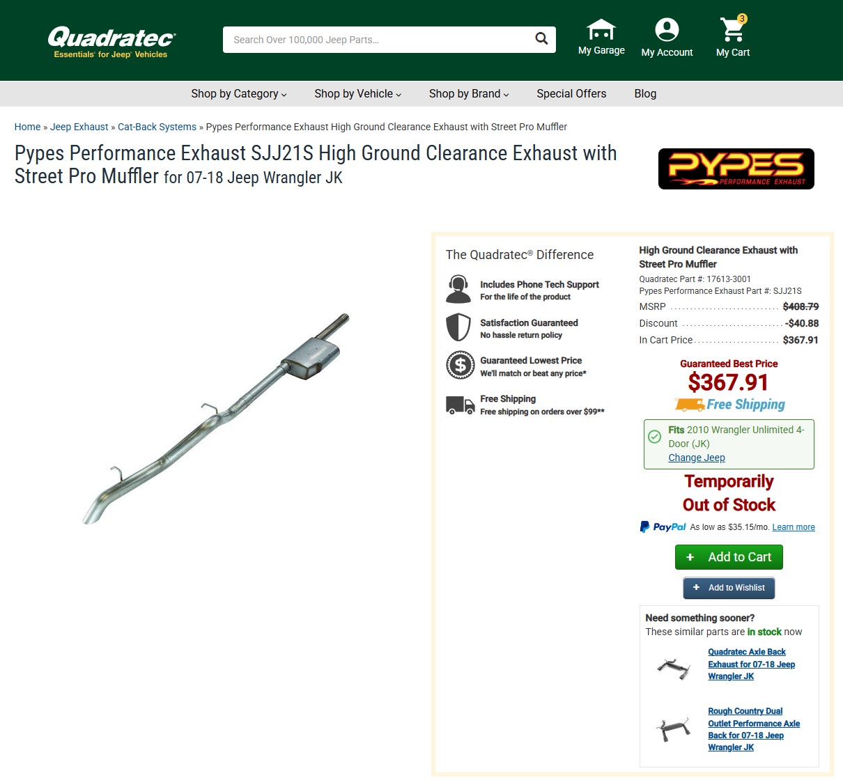

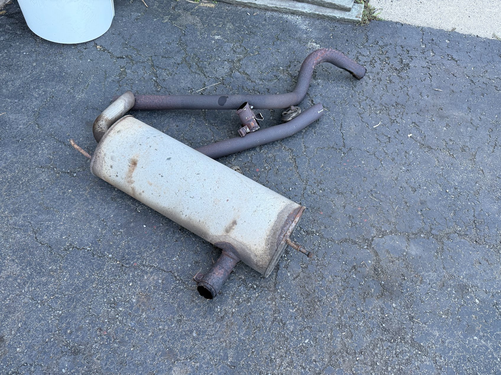

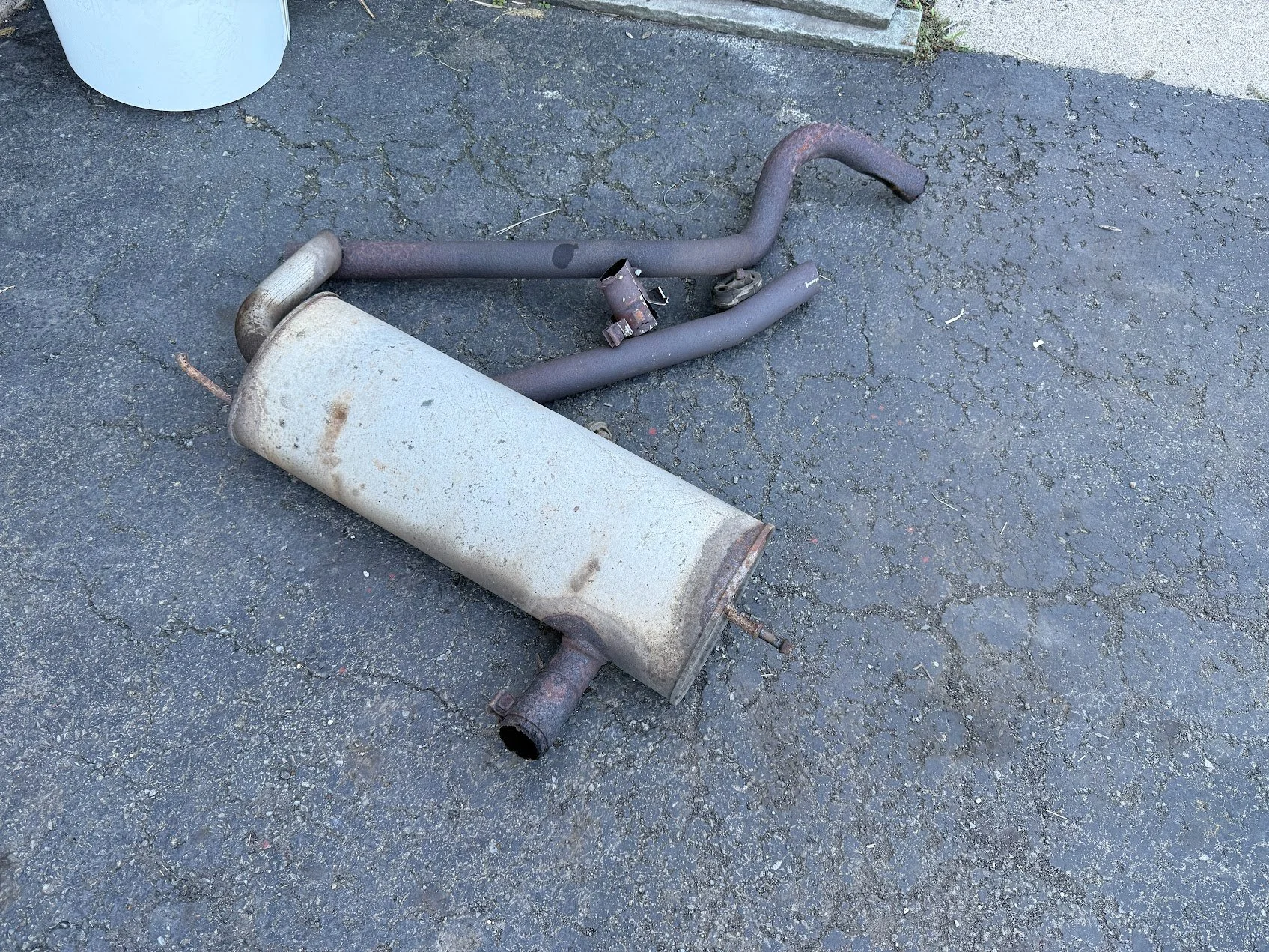

Of course, the day before I was about to start driving her Jeep, her exhaust broke right in front of the muffler...
I went with the Pypes kit from Quadratec:
Overall it's a real nice kit and even comes with replacement rubber hangers. It's stainless, so good for PA weather, and eliminates that massive muffler under the rear hatch. That said, it's a tad loud, but I'll let it break in a little bit and will see how I like it in the long run. I may end up replacing with a larger Flowmaster or similar at some point, but for now, it works as intended...
I ended up swapping my wheels and tires over to the Islander too. Her tires were smaller and shorter, so they'll make pulling the axles out of my JKU easier. The plan is to get the axles pulled this weekend and the new ones plopped in place. I'll bleed the brakes and will then start prepping to pull the motor. Before I do that, I may also snag my Rubi rails off of my JKU and put those are the Islander. My daughter doesn't use the steps ever and all they do is scratch my leg and get my pants coated in mud...
Those plastic steps suck and they tend to rust really bad at their attachment points. Better to run nothing than those things. I got some open box rock rails off Extreme Terrain for my Jeep years ago so may want to fish around for those.
Honestly surprised my exhaust hasn't fallen off at this point either. That's a really cherry looking Islander though.

Oddly, the steps don’t have it too bad. There’s a lot of surface scale underneath - I’m guessing the PO parked it on the grass - but the steps are fine. I’ll definitely put some Rubi rails on; they look funny with nothing there, but that will be a weekend project perhaps.
The Islander only has ~79k miles too and was previously owned by a a guy I used to coach with, who got it from a state trooper friend of his. It is a “Rebuilt” title after the first owner hit a deer and slide into a ditch. The state trooper fixed it with all Mopar parts and it rebuilt by the local Jeep dealer - I have all the receipts and everything. No frame damage - they even have a measurements verification done at a major auto body shop in the area. The service desk guy even talked the trooper into the Rubicon hood and gave it to him at cost.

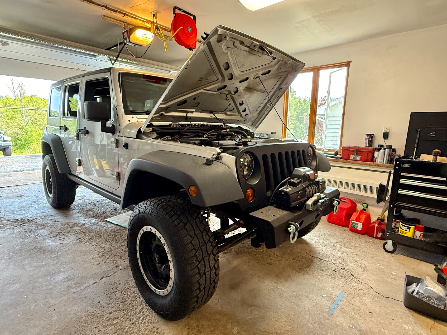

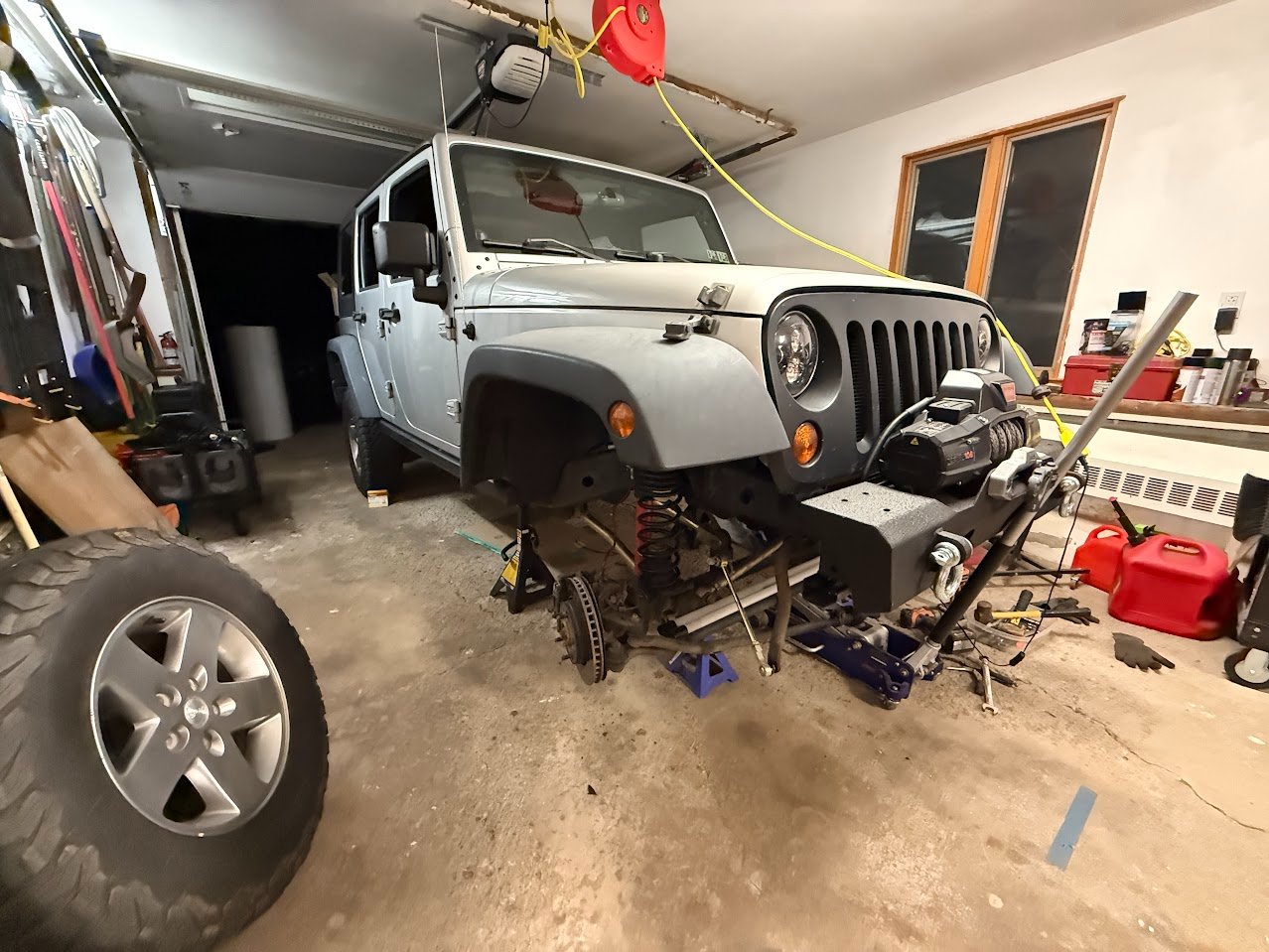

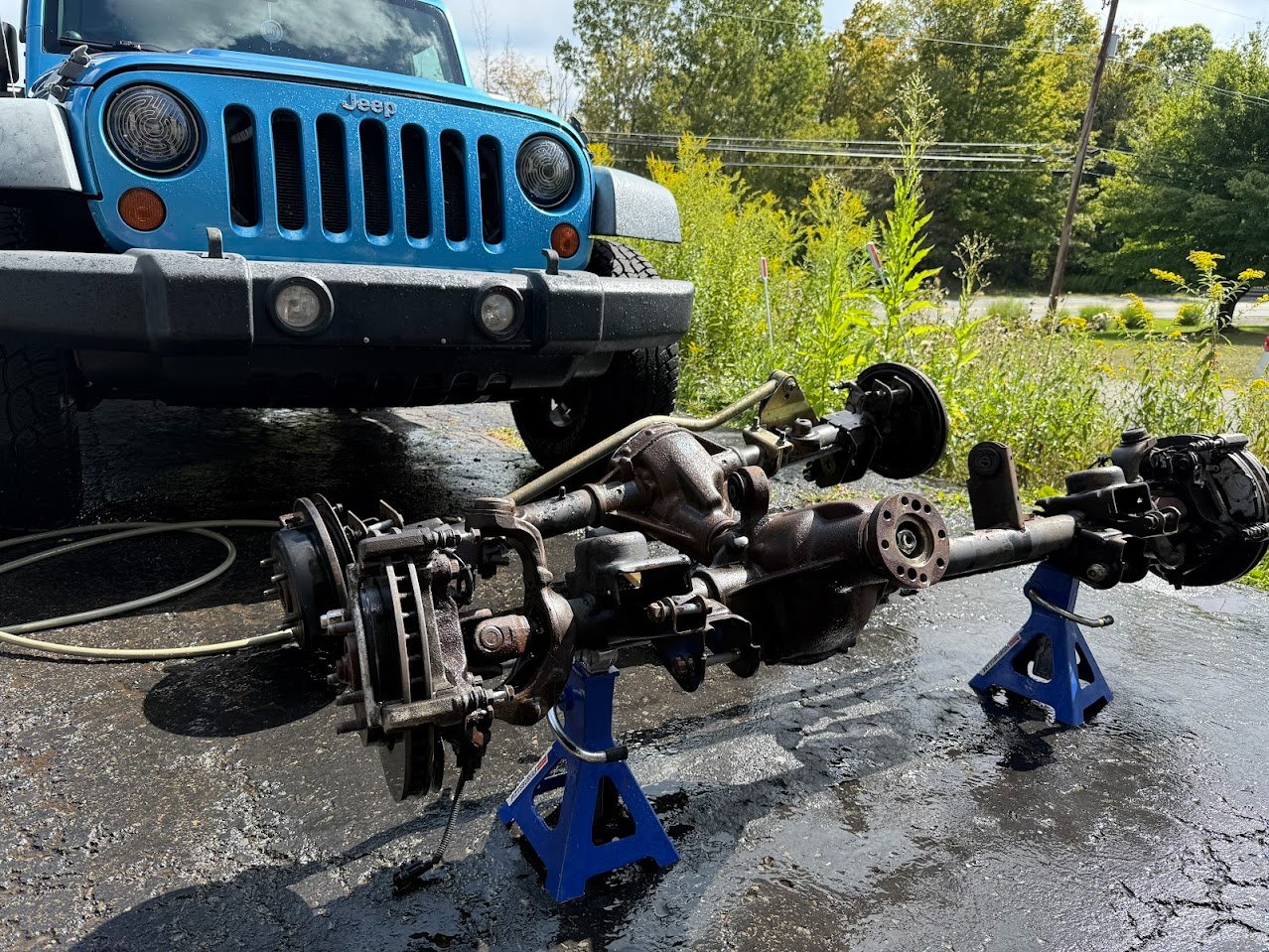

The teardown has begun!!! Finally...
They don't look too big on the ground or on the little dolly thing I made, but when you start wrestling around 700 lbs of beef, they certainly get heavy!

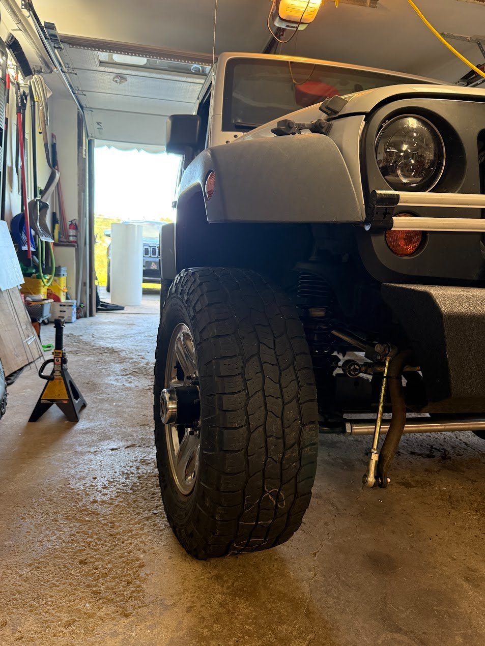

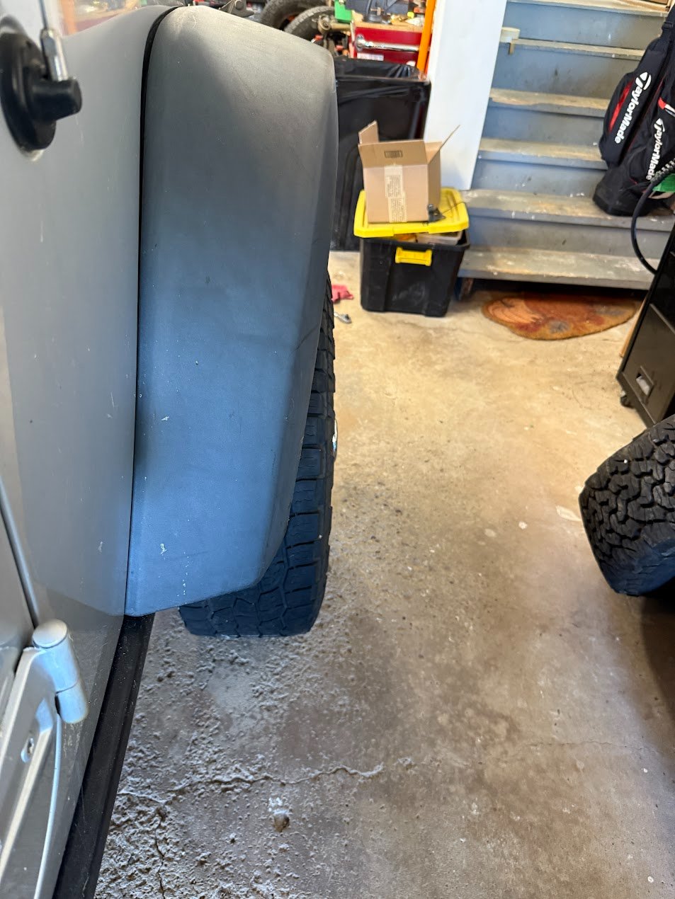

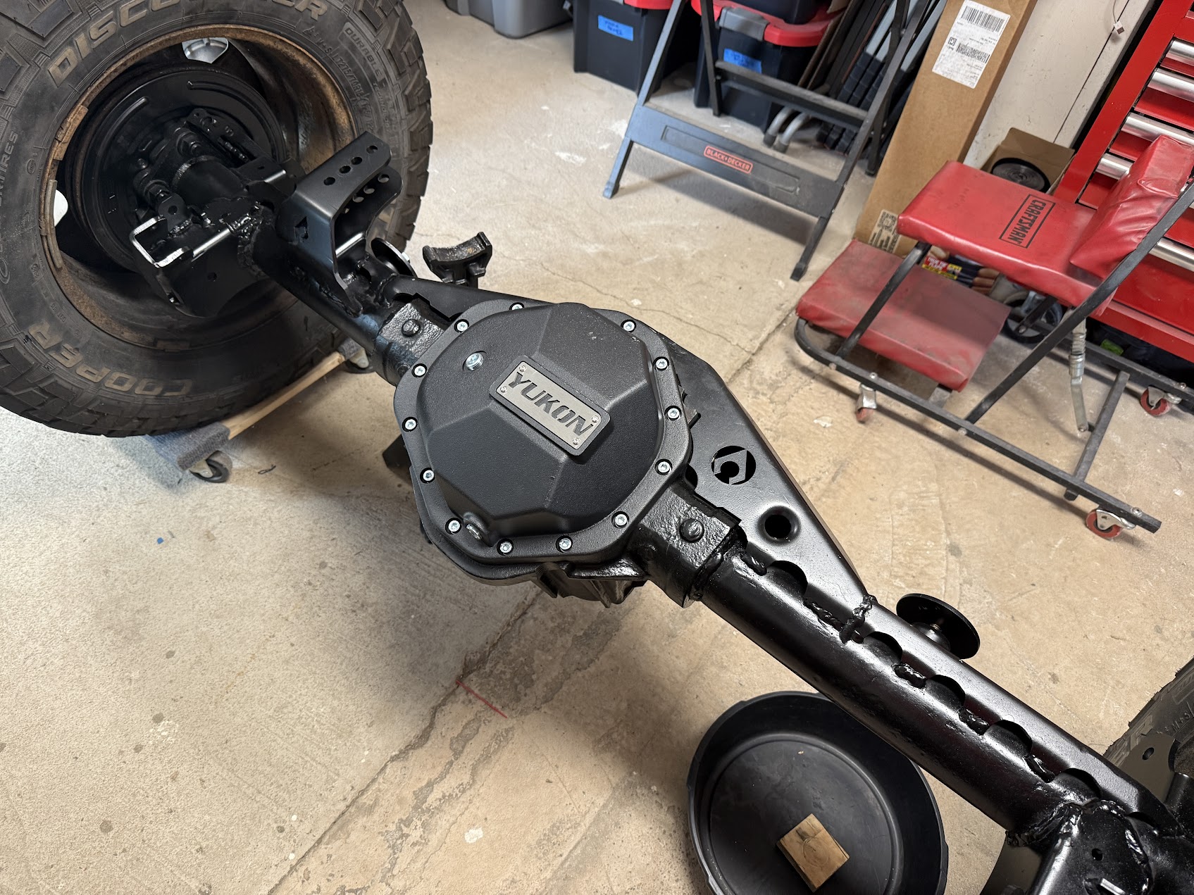

Front back on the ground with 3.5" MC springs (previously 2.5") and a set of 275/70R18 tires on stock Ram 2500/3500 steel wheels (with ~6.75" of BS).
Not a whole lot of stick out with the OEM flares as it currently sits, but with the 39-40"s on ~4" of BS, I am gonna plan on adding at least some additional coverage to keep the inspection station people happy. I found a local guy selling a barely used set of Bushwhacker flat flares with the modified OEM liners already attached, so I'm going to pick those up this weekend.

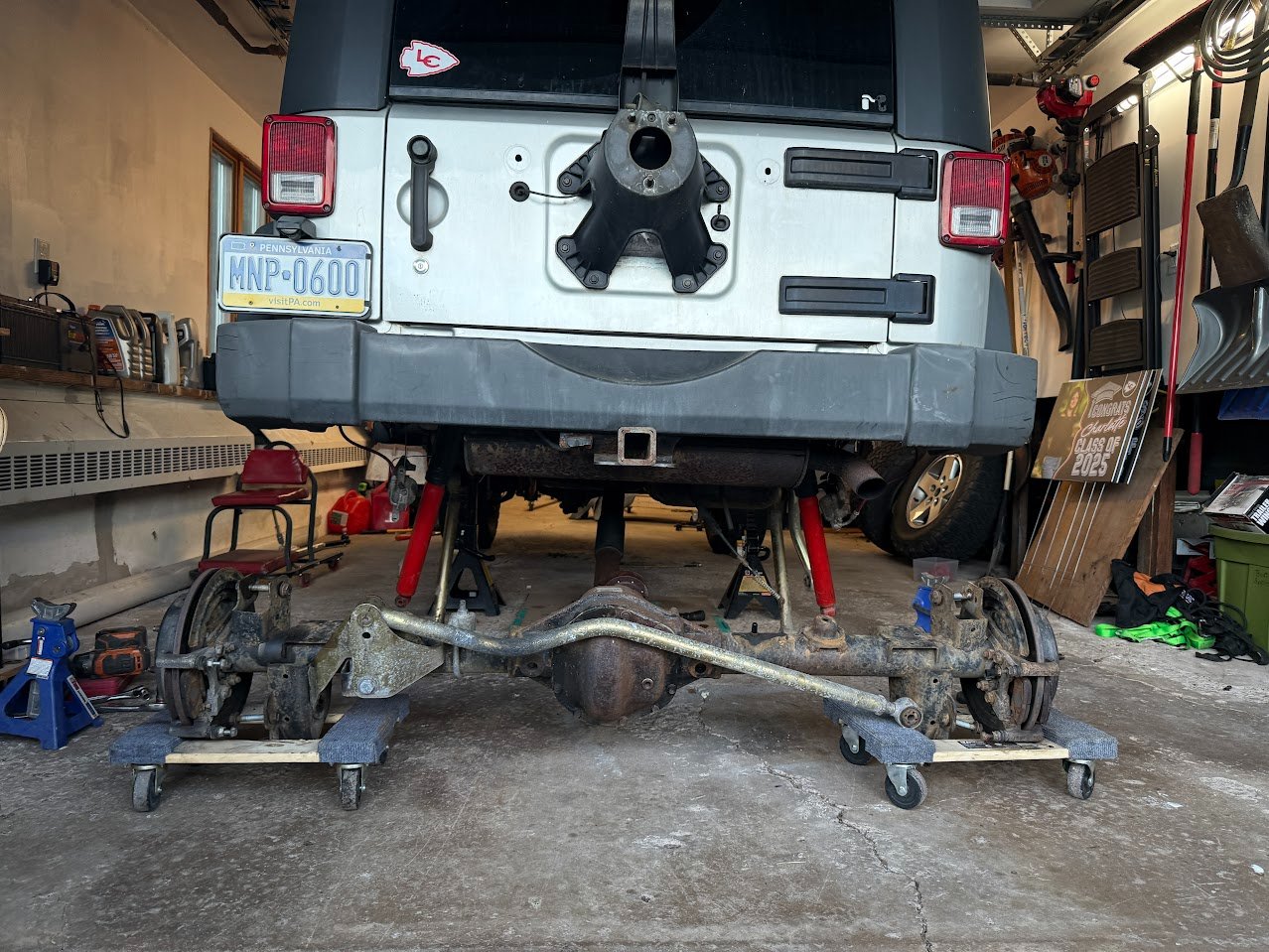

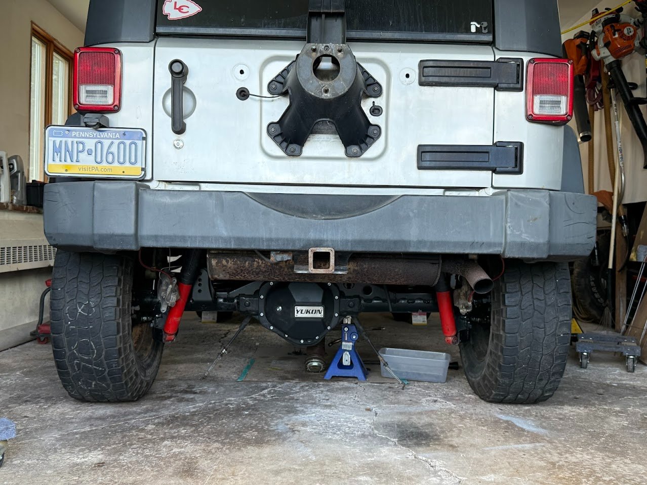

Got the back end out in less than 45 minutes. A lot easier than the front end since I didn't need to use the spring compressor, but boy did that driveshaft flange give me some headache...
The 14B goes in tomorrow! I need to snag some new banjo bolts to hook up the new brakes and get the system bled. I will want the brakes working so I can still wheel it out of the garage as I continue the strip down of the motor/trans so I can power wash it without rolling down the driveway into the lake...

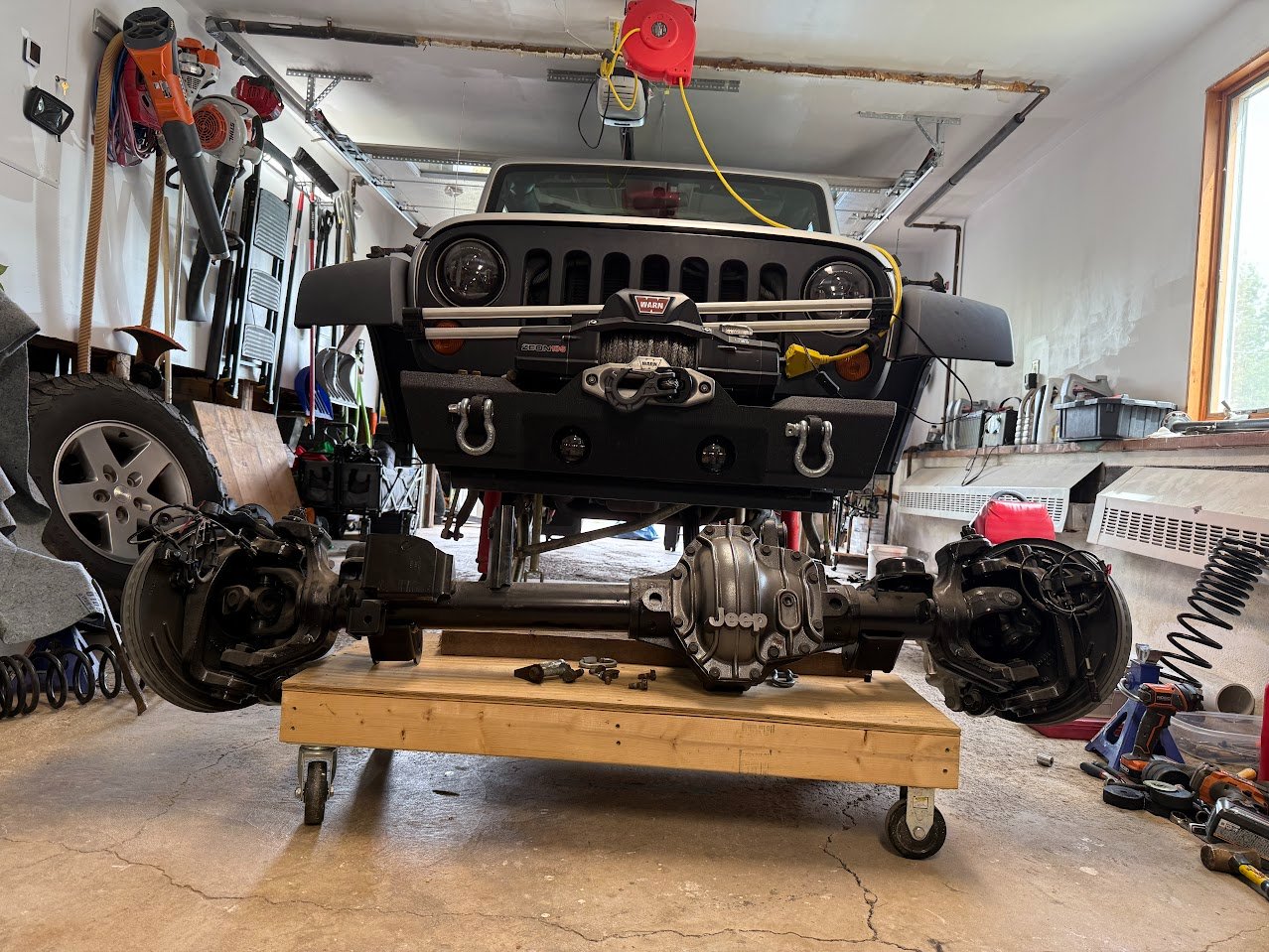

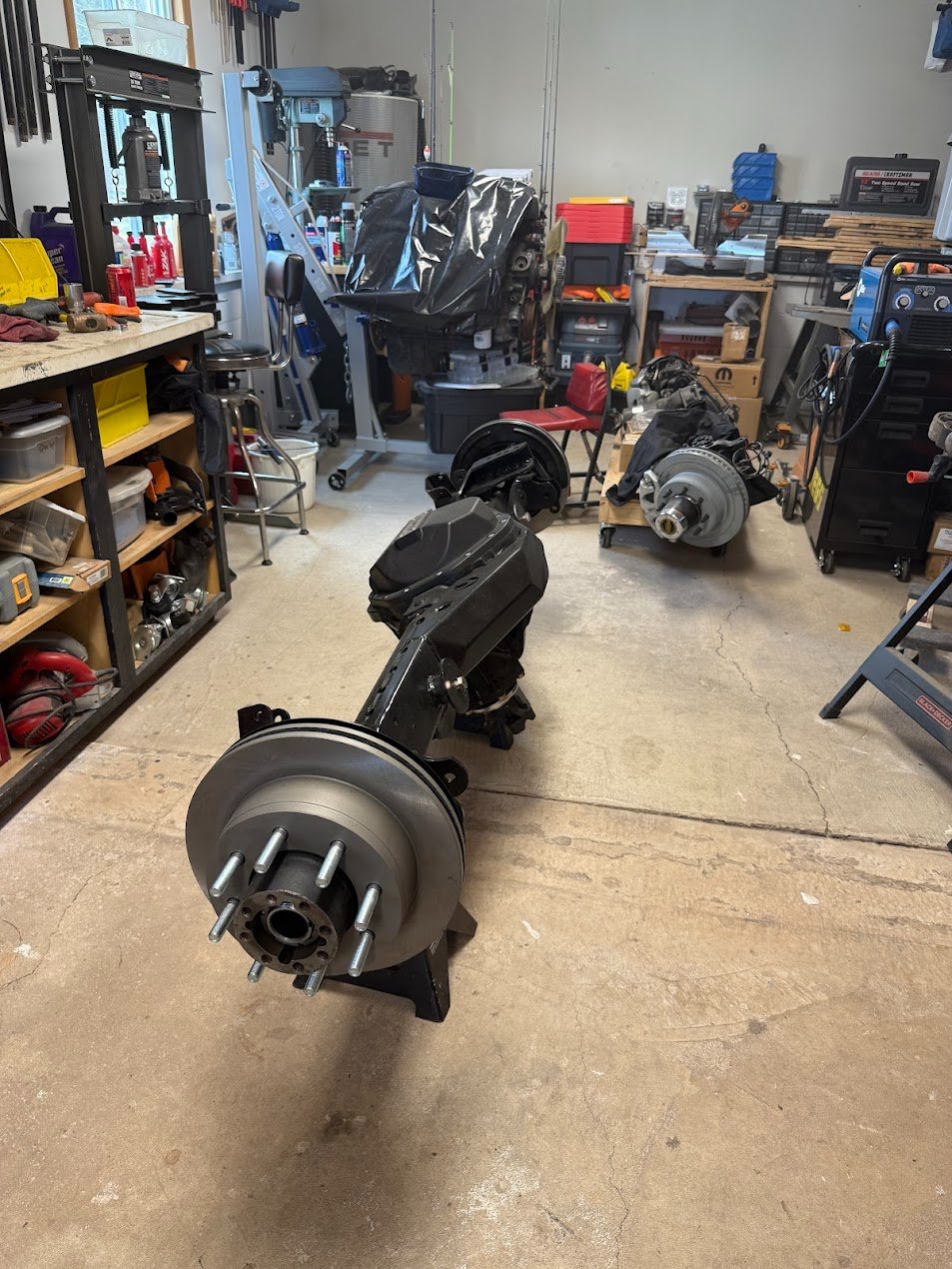

The 14B is in place! Everything bolted up as expected, though the trackbar is really close to the diff cover. I don't know if it's gonna clear it, or if a different trackbar shape will help, but I'll most certainly need to check clearances soon.

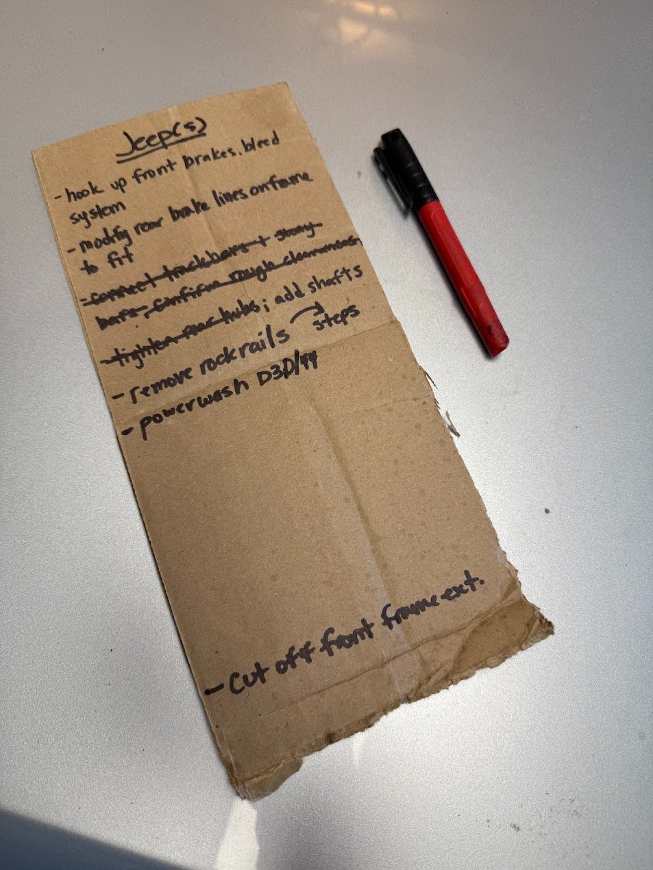

Making my (in)famous "carboard checklists" to help me keep track of things, especially silly things that are easy to forget (like "add diff lube!"). These also help me plan out my free time, as I can spot something that I can bang out quickly if I'm on a time crunch.

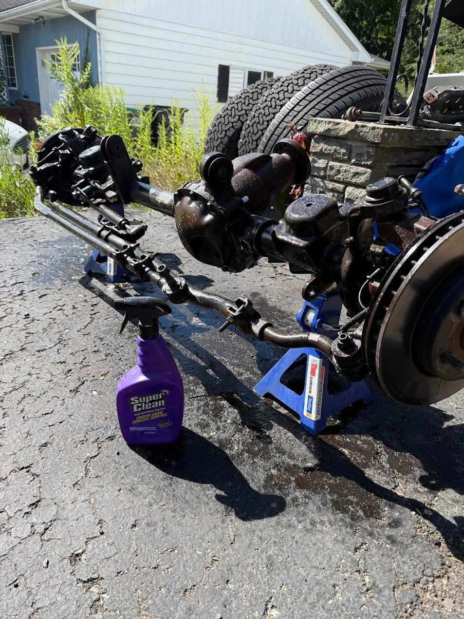

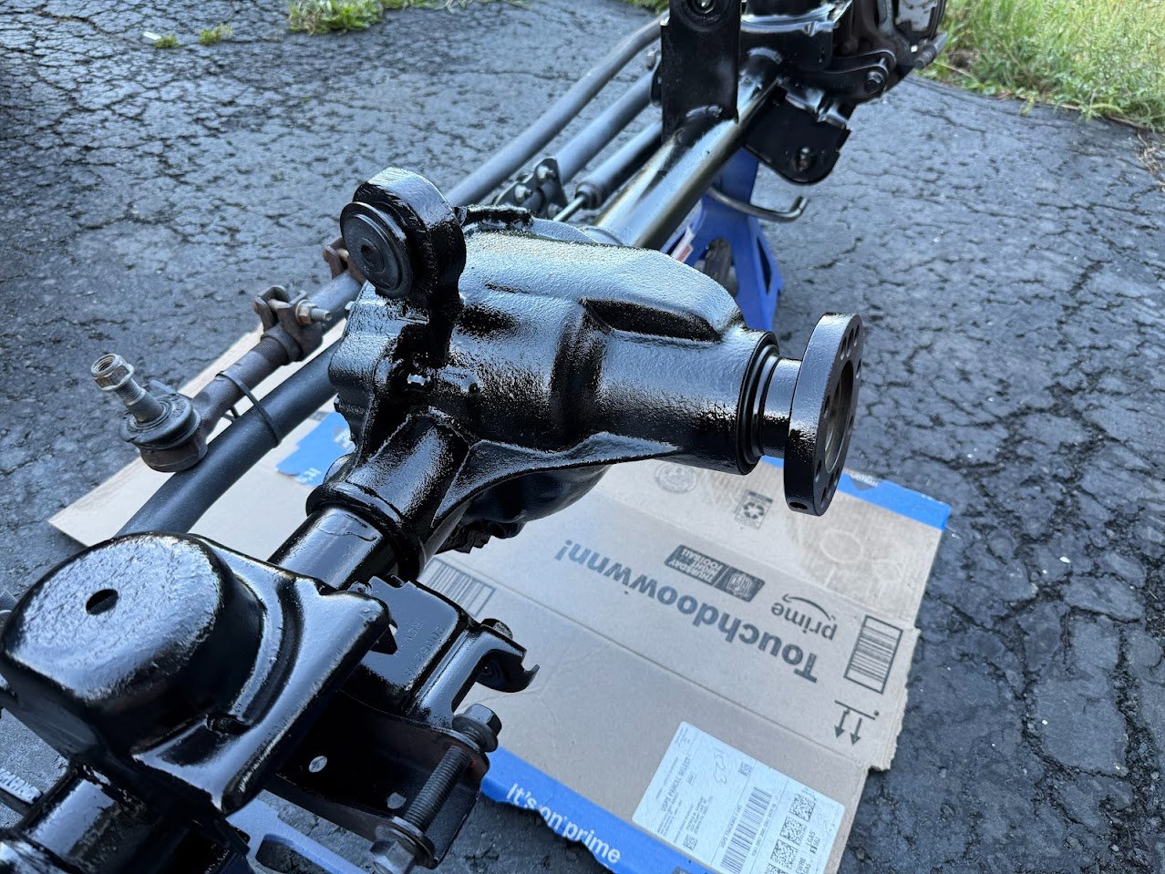

Since the weather was so nice, I decided to scrub up the D30/44 and throw some fresh paint on...
A few hours with the needle scaler, wire brush, and cardboard, and I'll be able to bring these back in the garage to start regearing for the Islander. I missed a Labor Day sale, but will reach out to my contact at East Coast Gear Supply and see what kind of package they can work up. In the meantime, I'll get some other supplies needed (e.g. new balljoints, hub bearings, etc). I found a NIB D44 Eaton/Detroit TrueTrac on sale on FB Marketplace, so I hope to get to these in the next week or so.
