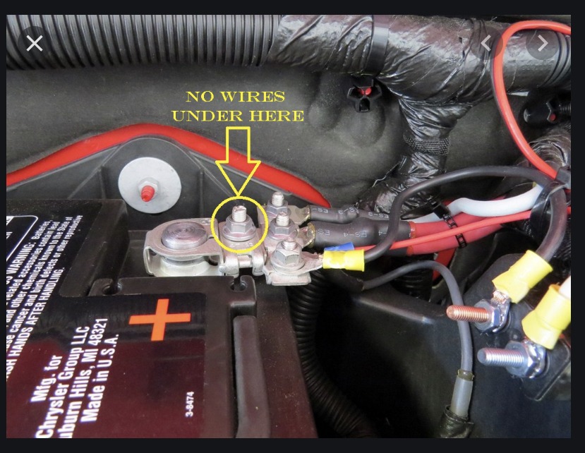

If either you have a picture or idea how to connect to battery much appreciate. Last time I connected one it was a simple post connection. I see the new battery system has three or four (can’t recall) wires coming off the post so wondering the best method to connect the cables.
Chris, thank you. I ended up ordering the JCR Off Road mounting plate and the ordered the 12K Gen 3, Smittybilt with synthetic rope last night. Thank you again.
Hmmm, my winch is a Warn M8000 and simply has a positive wire, a negative wire, and then a small ground wire that goes to the body. There shouldn't be anymore wires than that.
Chris, sorry I wasn’t clear. The battery terminal is what has 3 or 4 cables coming off of it, like image below. I’m just wondering if there is a specific terminal to connect it to, or do I need to add a fourth? Similar on the negative side
Chris, sorry I wasn’t clear. The battery terminal is what has 3 or 4 cables coming off of it, like image below. I’m just wondering if there is a specific terminal to connect it to, or do I need to add a fourth? Similar on the negative side View attachment 118327
No need to add. Just piggy back off of one of the existing terminals that has wires going to it.
Dont go to the one circled as that is how you loosen the terminal and that would be annoying to have the winch connected there if ever needing to disconnect the battery.
