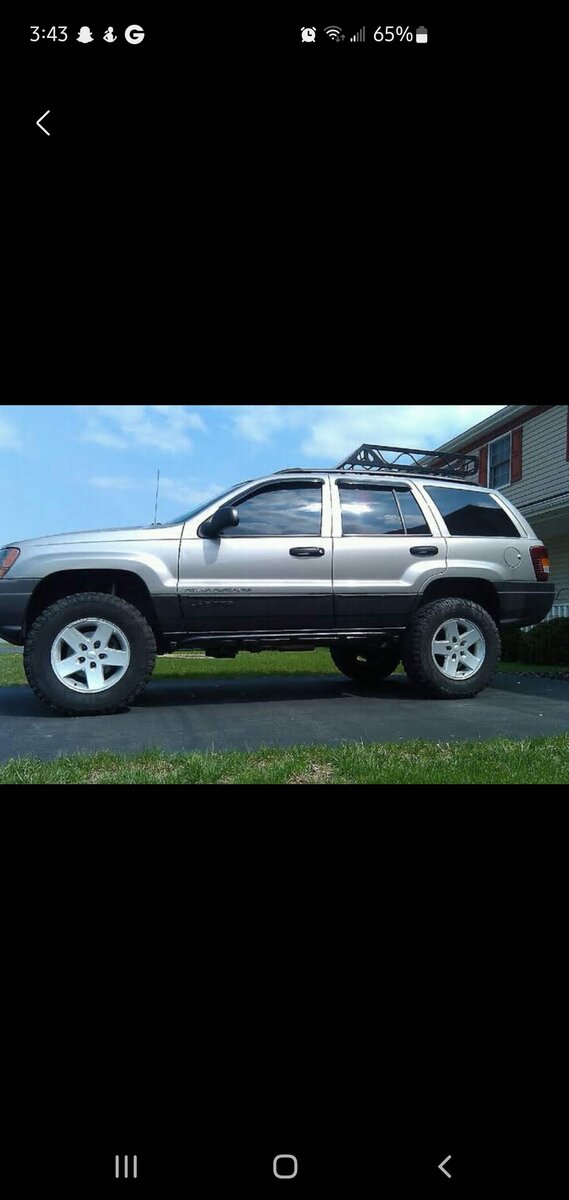

They will fit buuuut, your friend will have to trim the front bumper of the WJ and get 1.5" wheel spacers to keep the tires from rubbing at full turn. I had JK OEM wheels from a Rubicon on my WJ with a 4" lift.
