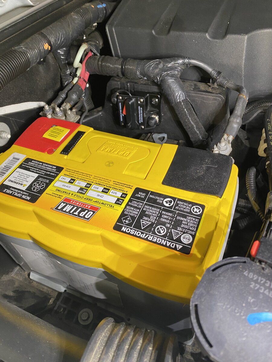

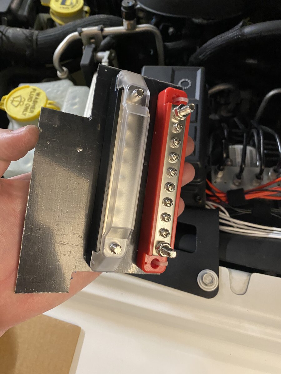

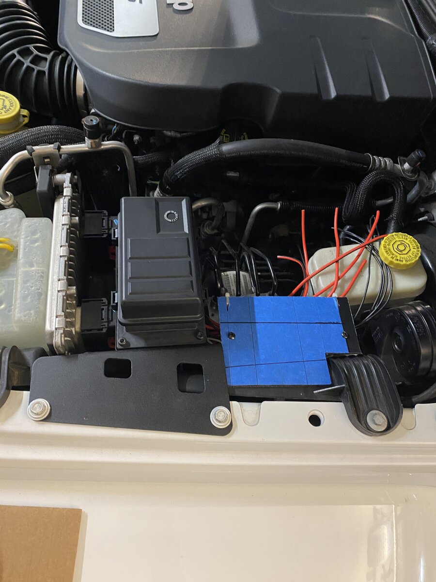

My severely overthought wiring project is taking shape.
Got the circuit breaker mounted, designed the mounting plate for the bus’s bars, & planned my wire routing.
