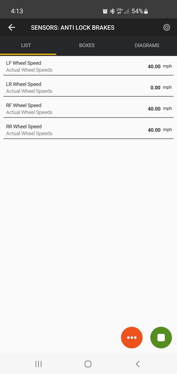

So my LR speed sensor is bad. What is the general consensus about where to get a replacement? Should I go OEM or Rock Auto or what the auto parts store has. Attached is a screenshot of the jscan.
Don’t go real cheap on those. Did that and changed them again at about 45 days. I did go a little cheap on my last one because money was tight and did a Duralast on my last change. Haven’t had any issues. At least I can get a replacement if it nuts out. Put on some anti-seize when u do them and it’s not that big of a deal. But it’s always good to to go mopar if the wallet permits.
