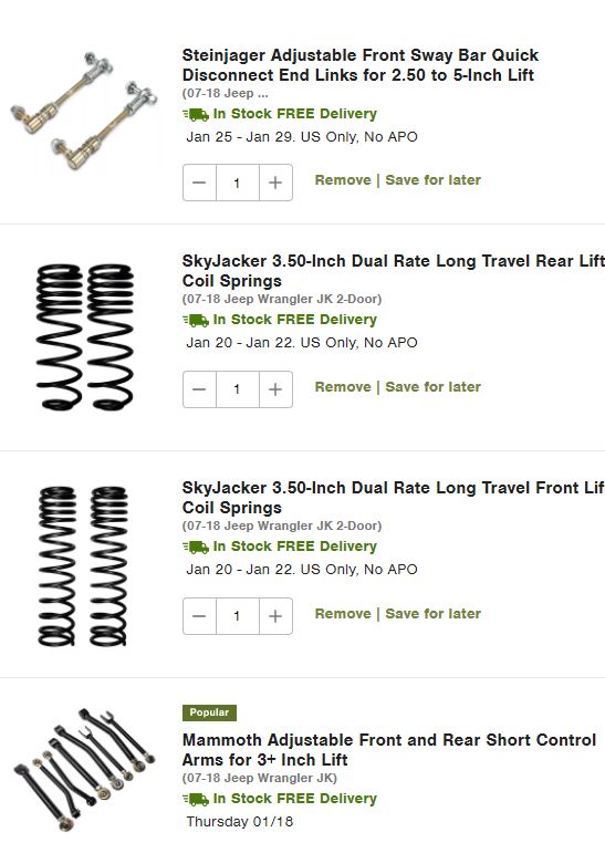

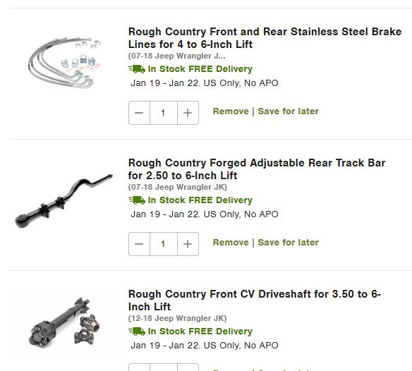

Can you review the attached part list and provide your thoughts?
looks like everything you'd need, is it cheaper to buy different Brands than to buy a kit from one Brand?
I don't have any experience in which Brands are good other then stay away from Rough Country.
He listed their track bar and brake lines, I would have no problem with either of those items. It’s their springs I’m not a fan of.
