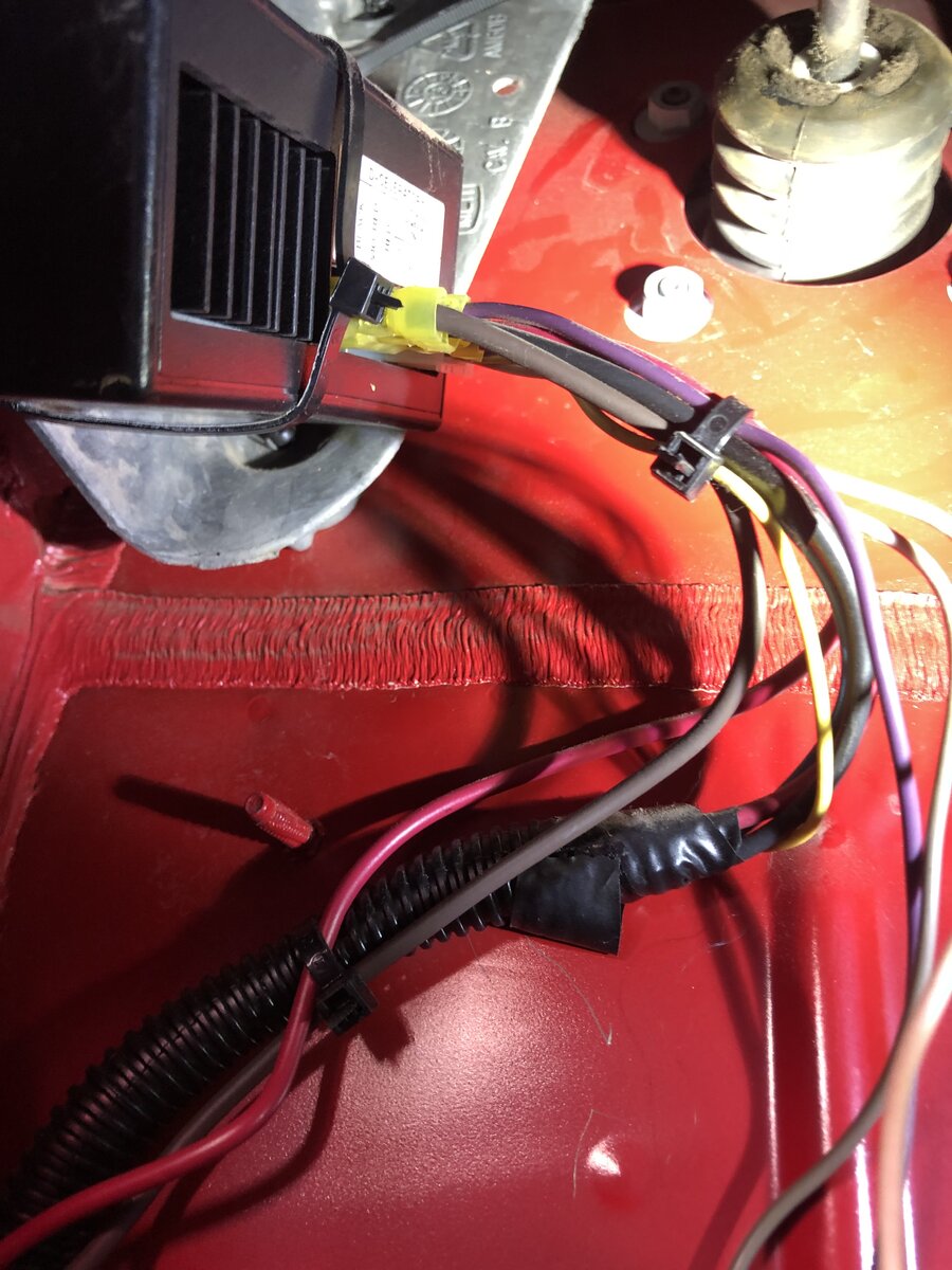

What is this?
I would look around the dash for maybe a toggle switch.
No toggle switch, but I think I solved it. We bought this used and obviously don't know all that the previous owners have done. I know it has a tow bar installed in the front and a box you can clamp a ripcord on and attach the other end to your RV. The brake has a pully and braided cable on it so I know it can (or should) stop if it ever comes unattached while towing. I followed all wires and harnesses associate with the mystery part and they run to the box in front of the jeep, to the battery and into the cab to another box that is zip tied in place and says "Decelerator" on it. So, mystery part is a piece of the emergency tow brake package but what does it do, why is it disconnected and what should it be connected to?

It actually is part of the RV/towing brake system. I found where someone teed off the brake booster hose as described in the instructions. It has since been plugged.
2. Cut the 3/8" or 1/2" I.D. hose from the engine to the brake booster and install the appropriate-sized T-connector. Install the appropriate-sized check valve between the engine and the T-connector. Make sure the flow arrow on the check valve is pointing toward engine.
3. Run the supplied vacuum pump tube from the vacuum pump to the T-connector. Connect the tube to the nozzle marked "In" on the vacuum pump. The nozzle marked "Out" will not have anything connected to it. Cut the tube to the appropriate length and attach to the T-connector.

Maybe. Check out my link above and look for similar parts. I found the solenoid on the inside of the firewall on the passenger side. Went to a supplier that are experts on this system. Company discontinued the unit and parts are very scarce. When I'm ready to tow behind our RV I'll have to get a whole new system.
