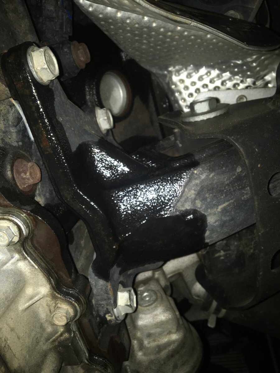

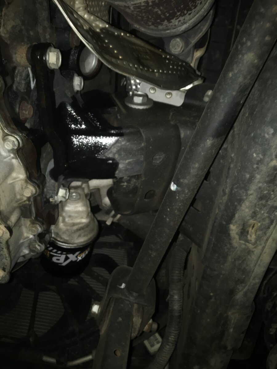

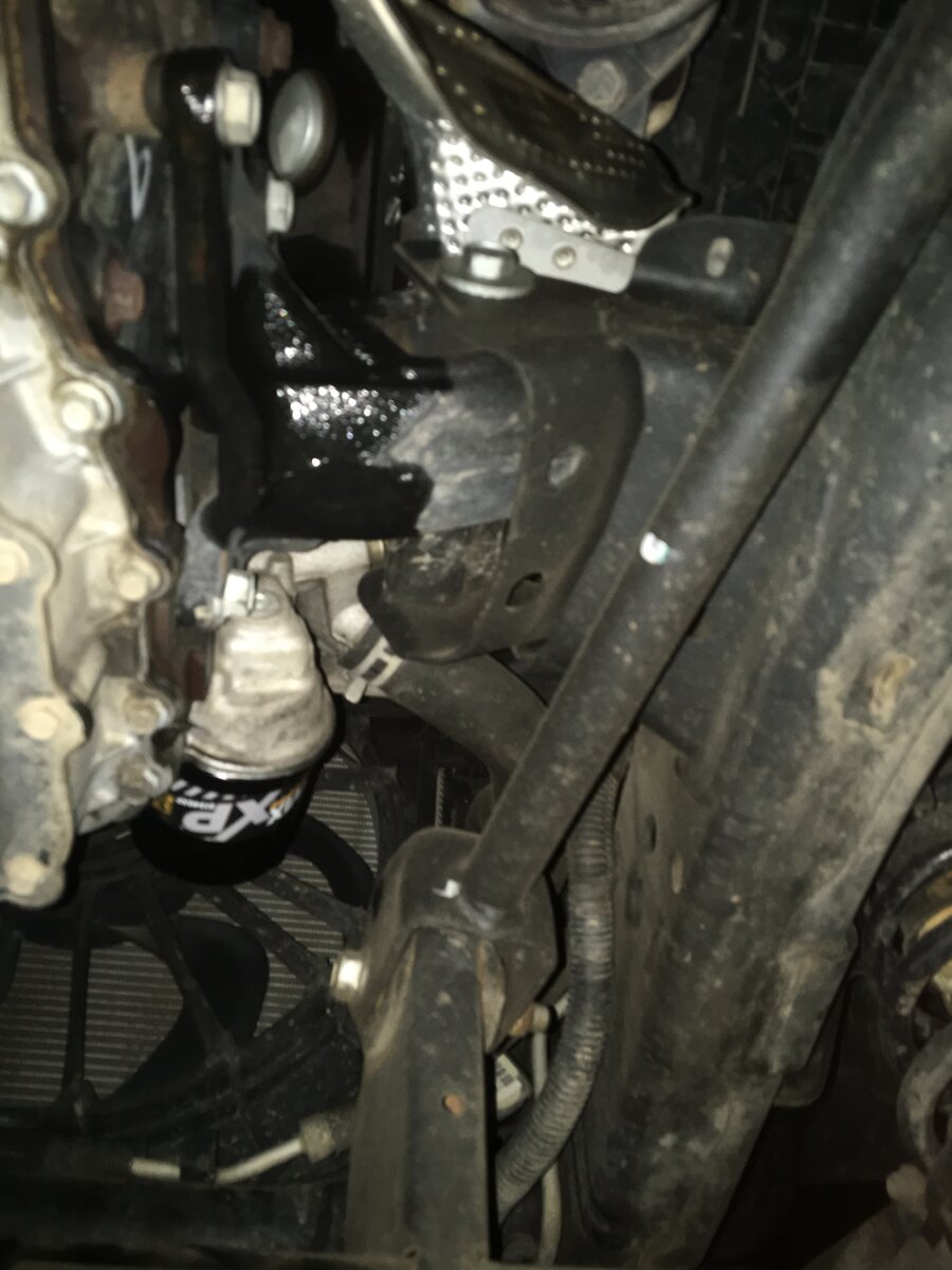

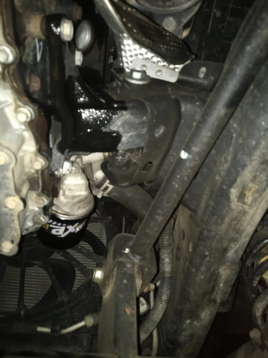

Did an oil change and now noticing what seems to be a leak. Not sure what I’m looking at.
When you took off the old filter did you check to make sure the seal came off too? Sometimes they stay behind and won’t let the new one snug up causing a leak.

Yep, made sure the old seal was gone. I think Sidechickbuiltjk below is right, the funnel did slip while I was putting the new oil in, I just didn’t think it was that much.
Looks like maybe some spilled oil as oppose to a leak.
Some UV dye in the oil and a UV flashlight would tell you pretty quick where it was coming from (if it is a leak).

This thread can probably be deleted, doesn’t seem to be a leak. I’ve been monitoring it and most likely the culprit is a small-ish spill.
