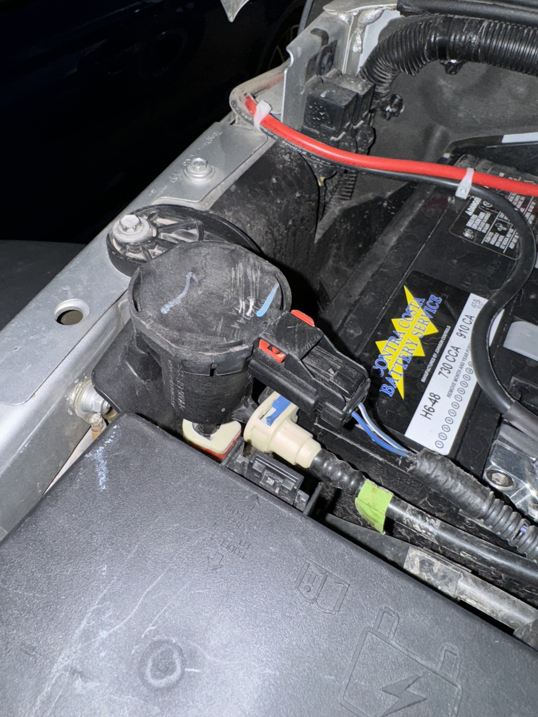

Frog lube Member Supporting Member Joined Aug 8, 2021 Messages 25 Location Seattle Aug 5, 2024 #1 Windshield washer motor? Looks kind of small.
JeepJeezy OlllllllO Supporting Member Joined Jun 8, 2021 Messages 964 Location 717 Aug 5, 2024 #2 That is your purge valve.
Frog lube Member Supporting Member Joined Aug 8, 2021 Messages 25 Location Seattle Aug 5, 2024 #3 Thanks. What does it do?
JeepJeezy OlllllllO Supporting Member Joined Jun 8, 2021 Messages 964 Location 717 Aug 5, 2024 #4 Frog lube said: Thanks. What does it do? Click to expand... It's part of your EVAP system. In short, It controls the flow of the fuel vapors from the fuel tank.
Frog lube Member Supporting Member Joined Aug 8, 2021 Messages 25 Location Seattle Aug 5, 2024 #5 Oh interesting. I have an issue with my EVAP system where I get the Check Gas Cap warning, but replacing the gas cap didn’t fix it. So small leak somewhere. Good to know this is part of it. Reactions: JeepJeezy
Danarch JK Addict Supporting Member Lifetime Supporting Member Joined Mar 9, 2021 Messages 1,279 Location Orangevale, CA Aug 5, 2024 #6 Had a similar issue on mine, ended up being the fuel tank pressure sending unit. Reactions: Duster
