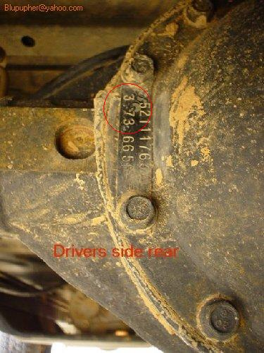

Or, you can look on the left side of the differential cover and there should be a tag with a number which includes the gear ratio:

Just looked around the differential cover but didnt see any tag or numbers. Tried entering the vin but it just says No records found corresponding to the VIN provided double checked vin but it didnt work
OK i got it was 1 digit out on vin, so it says 3.21 Rear Axle Ratio. Ill check that against what i find when i jack it up and count revolutions

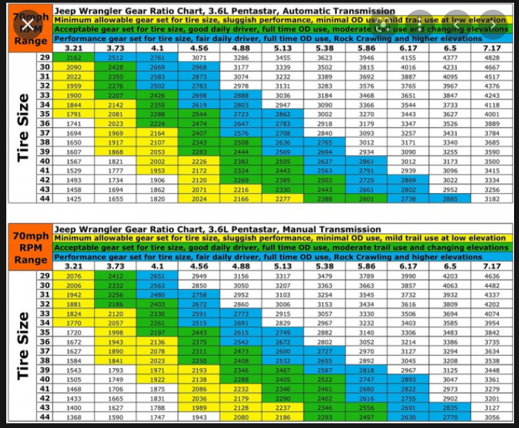

If you do have 38s with a 3.21 rear end, you need to seriously consider a regear. Check the optimum RPM charts below and you'll see that a 4.56 or 4.88 is the minimum you should be running.
