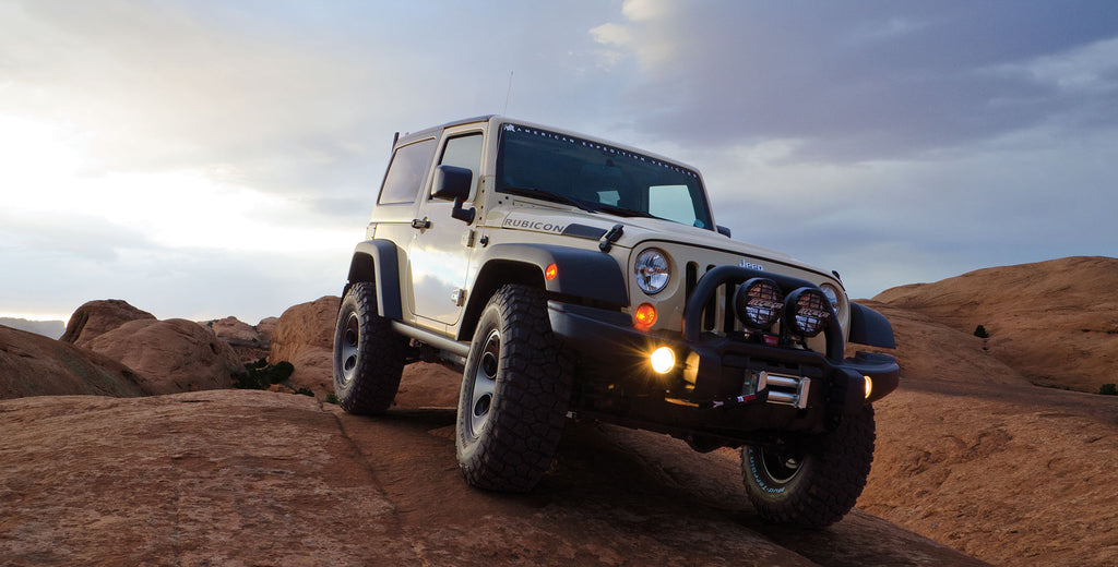

Likewise, having owned several other modified Jeeps in the past, I wanted this one to be comfortable, capable, and dependable. I researched several different lifts and decided on the AEV 3.5” DualSport, mostly because it allows me to run 35” tires and retain a more factory like suspension geometry as well as it is a true complete lift. The 2.5” XT Lift doesn’t require any exhaust modifications as do lifts of 3.5” and up. It’s a complete lift with exception to not having a ProCal Module to recalibrate speedometer, trans shift points, TPMS parameters etc. The lift sells for about $1000 and the ProCal is $170 more. IMHO
