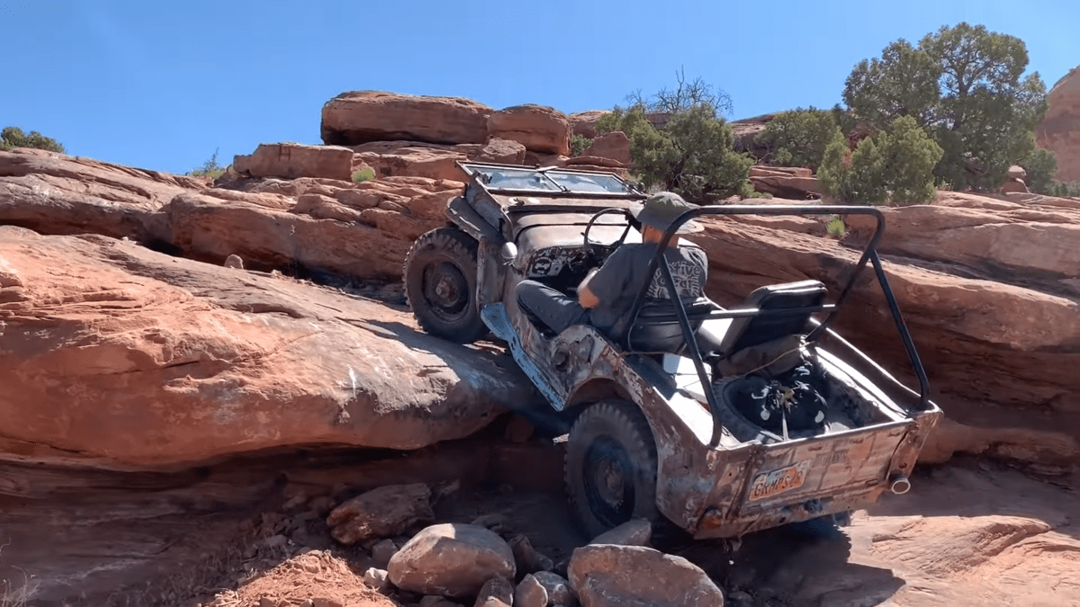

Your Jeep, as it sits right now, will go 90% of the places the big tire crowd goes, but slower.
The only reason for "mods" is for specialized driving, like rock crawling.
YouTube has a series that covers exactly what I just said; "Grandpa's Jeep."
