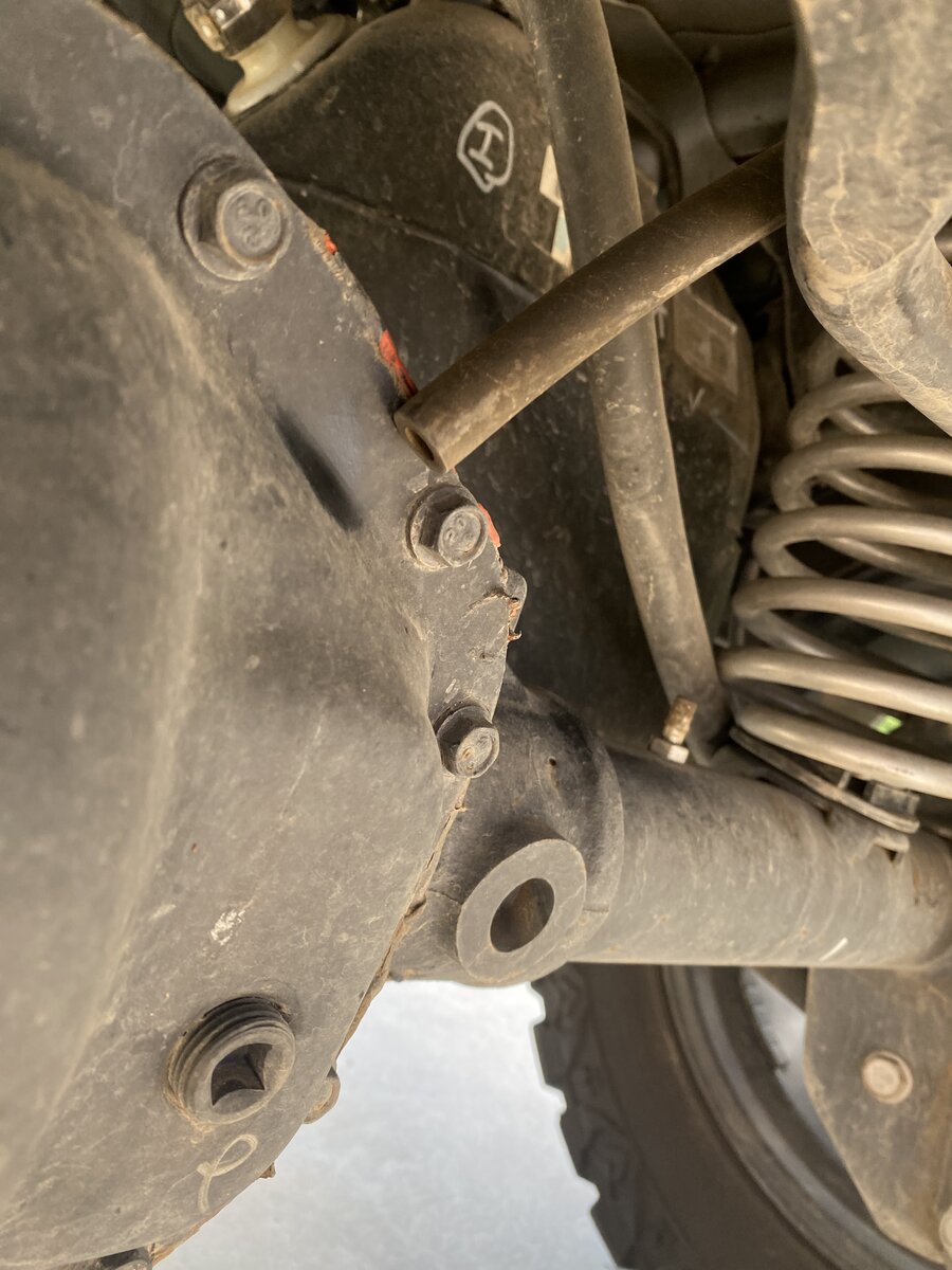

KSwanson Member Joined Aug 14, 2022 Messages 55 Location AZ Aug 27, 2022 #1 What is this tube hanging down?
BLACKJKU Moderator Staff Member Lifetime Supporting Member Joined Feb 22, 2020 Messages 4,872 Location Huntington In Aug 27, 2022 #2 That's the breather tube it's supposed to go on the round silver piece sticking up on the right top side of the axle tube. Reactions: mrjp and BigAL07

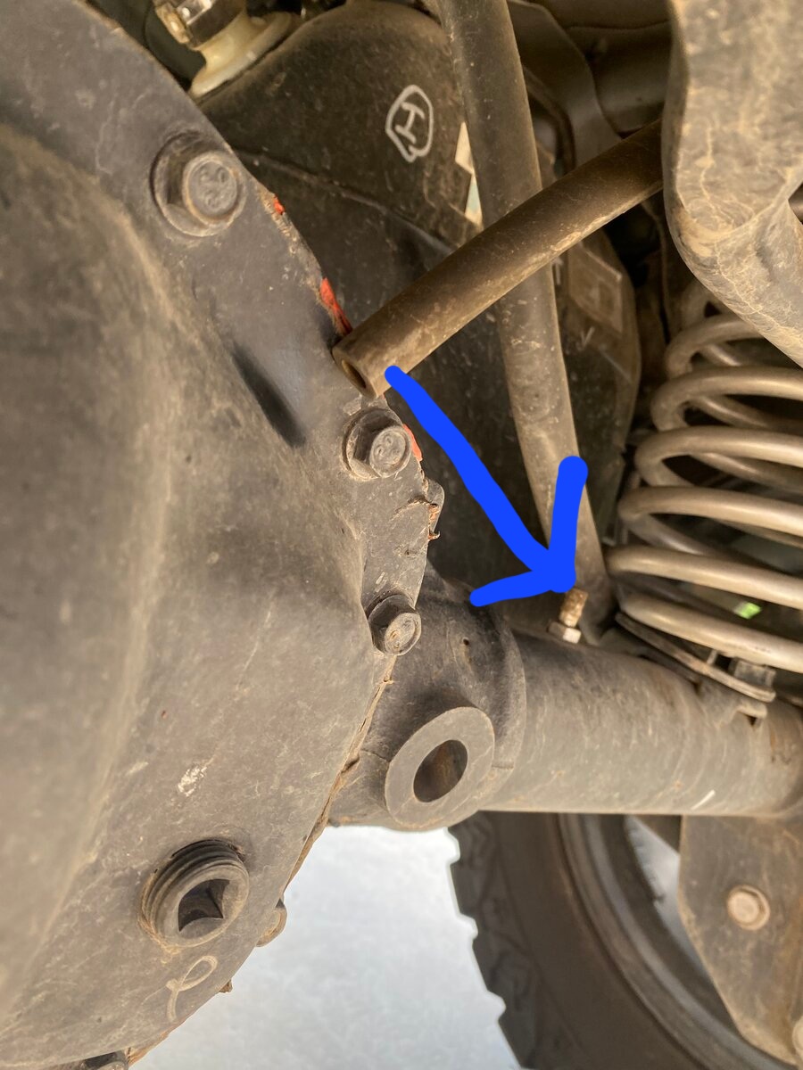

JeepJeezy OlllllllO Supporting Member Joined Jun 8, 2021 Messages 833 Location 717 Aug 27, 2022 #3 It goes here. I used a small clamp to keep mine on. Might need to extend the hose if you have a lift. Reactions: mrjp, Danarch, BigAL07 and 1 other person
