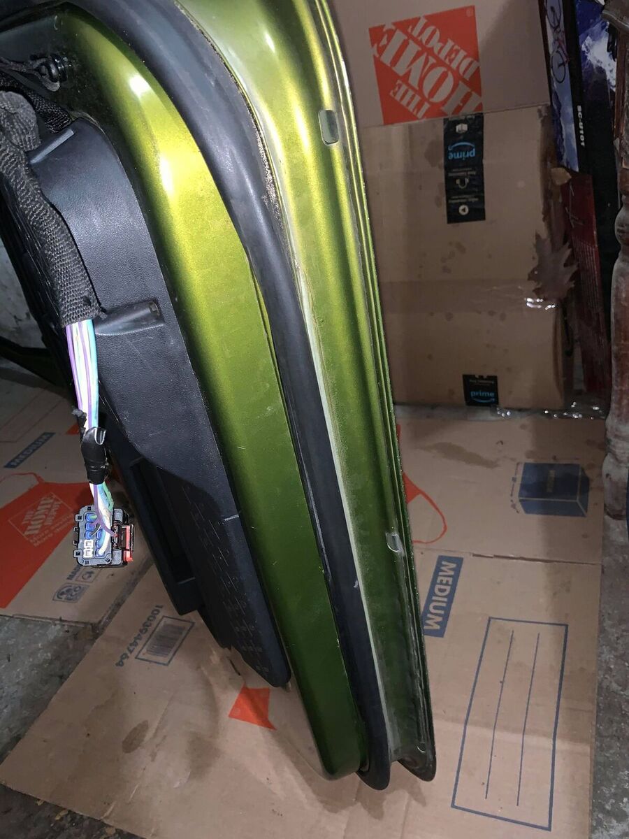

This is what I see on the bottom of the door. Are these supposed to “open” or something? Because they definitely aren’t.
Reactions: Anybodyhome
Mine aren't open. That hole also isn't at the lowest point so I don't think it would do much good for water drainage.

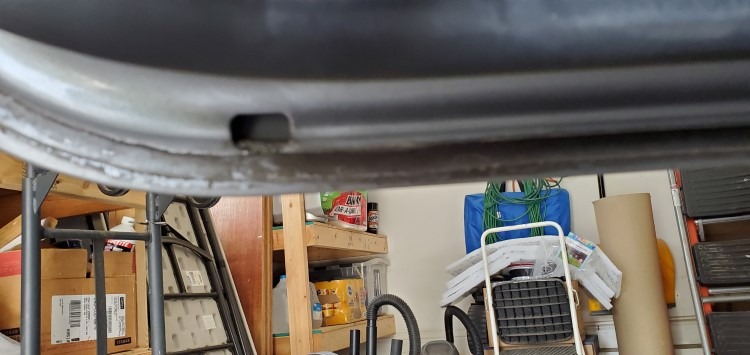

Yes sir, those are your drains. I pictured mine below. Are your clogged with crap or have they purposefully been closed with something? You pic threw me for a second because of its orientation.
2014 JKU Sahara.
Open the door and look between the weatherstripping and the outer skin of the door panel. My front doors have 3 each 5/8" x 3/8" holes. 1 on the hinge side, 1 in the middle and one on the latch side. The photo shows the driver's side bottom left, or latch side, of the door. The black on top is the weatherstrip, the seam below the hole is the rolled and welded seam of the exterior door panel to the tub of the door. The back doors, because the bottom edge of the door is pretty short, only have 2 holes each.
Think of it this way- the entire door is a tub, a bowl. The exterior panel of the door is a flat lid or cover to the tub. The holes are located almost right where the rolled and welded seam brings the exterior door panel and the door tub together.
2014 JKU Sahara.

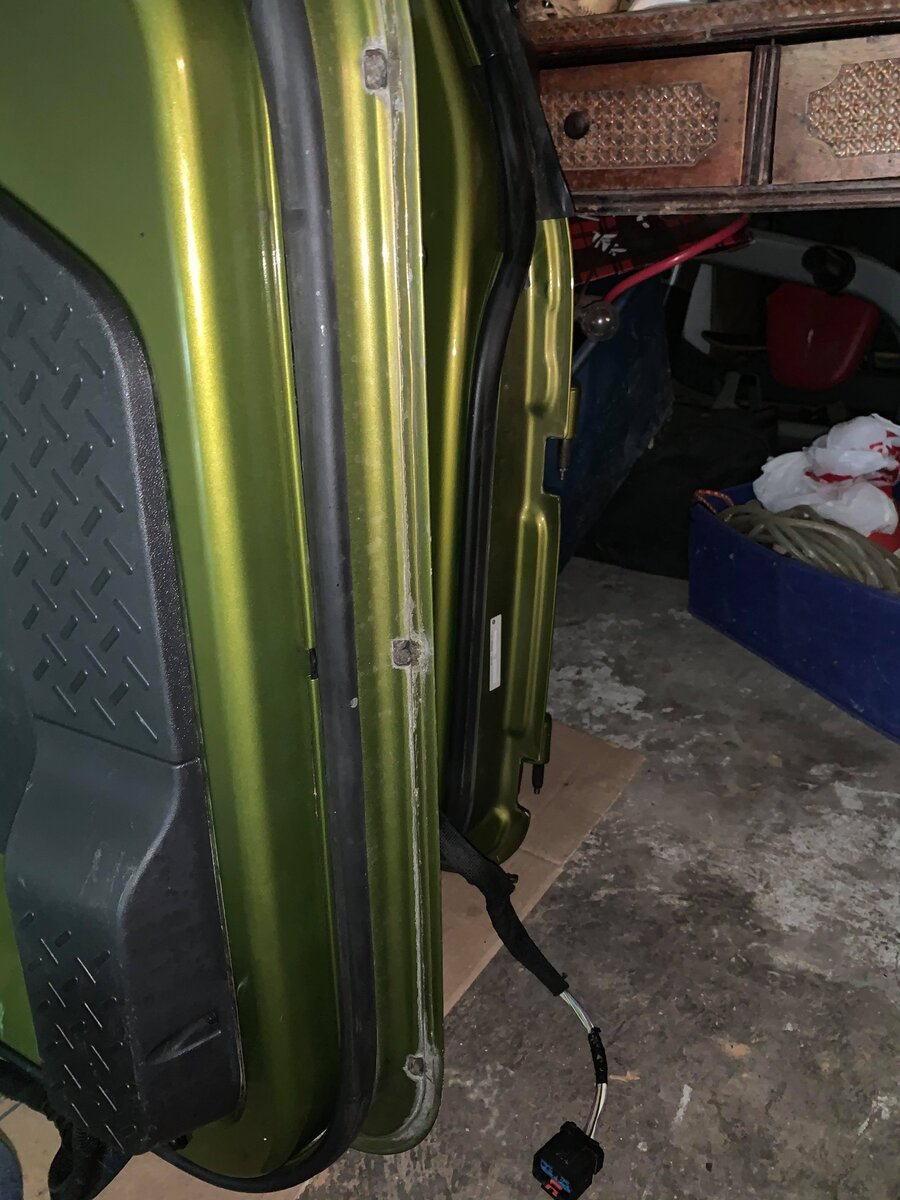

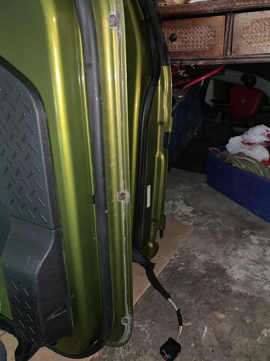

Thanks for the info! I didn’t intentionally close them off but they are definitely blocked off. I’ll look at the other one and decide how to proceed.
This is what the underside of a normal door looks like, for reference (in case anyone with a similar issue finds this thread and wants to see).
Upon clearing away the sealant from the first image I discovered that my passenger panel actually has broken glass in it from a shattered window that must have occurred at some point in the past. Instead of clearing the glass properly, it would appear that someone just decided to plug up the holes with gasket maker or something similar.

They definitely plugged the holes to keep them from raining glass chips every time the door is opened and closed. I covered them with aluminum tape for the same reason until I am able to remove the inner panel to properly clear the glass.

It isn't possible to remove most of the glass through the drain holes unless I expand them. Many of the chips are too big to fit through the holes and they lodge in place, causing a jam. I can push the bigger chips back up into the door and remove smaller chips until the bigger ones get stuck again, but that strategy was taking ages when I gave it a shot last night.
