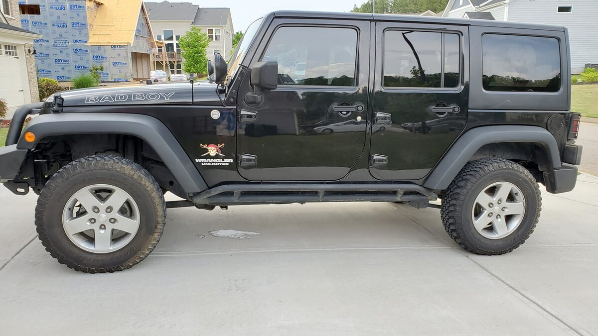

Can't wait to see what you decide. Pic of my Jeep w 2.5 inch TeraFlex lift w ARB front bumper w Smittybilt winch which adds around 400 lbs, which is why I needed the lift.
One purchase affects other purchases.....

Bad boy, what size are those tires?
