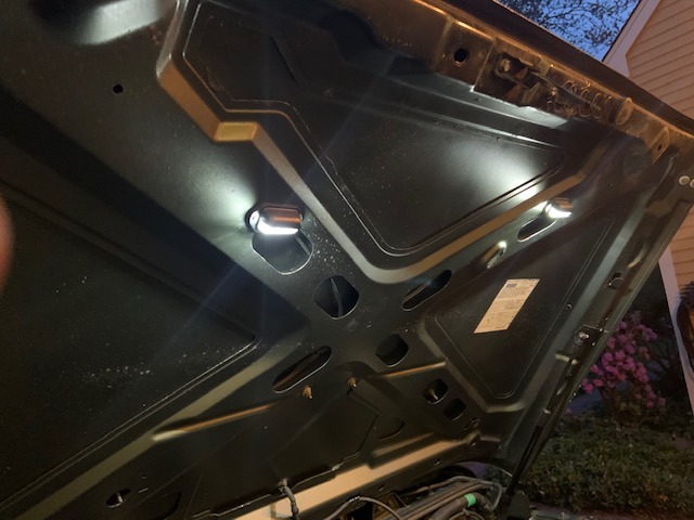

I actually finally installed a light. A pair of inexpensive LED's - very bright actually.

What lights did you use @JimNH ?
CZC AUTO 12V LED Exterior License Plate Tag Light, Interior Courtesy Dome/Roof Trunk/Cargo Underhood Lamp, Total 12 White SMD Bulb, Legal for Car Truck RV Trailer (White light, 2 Pack)​
look for these on Amazon. I tried to put in a plunger switch, but could not figure out the best place to put it on the jeep.
