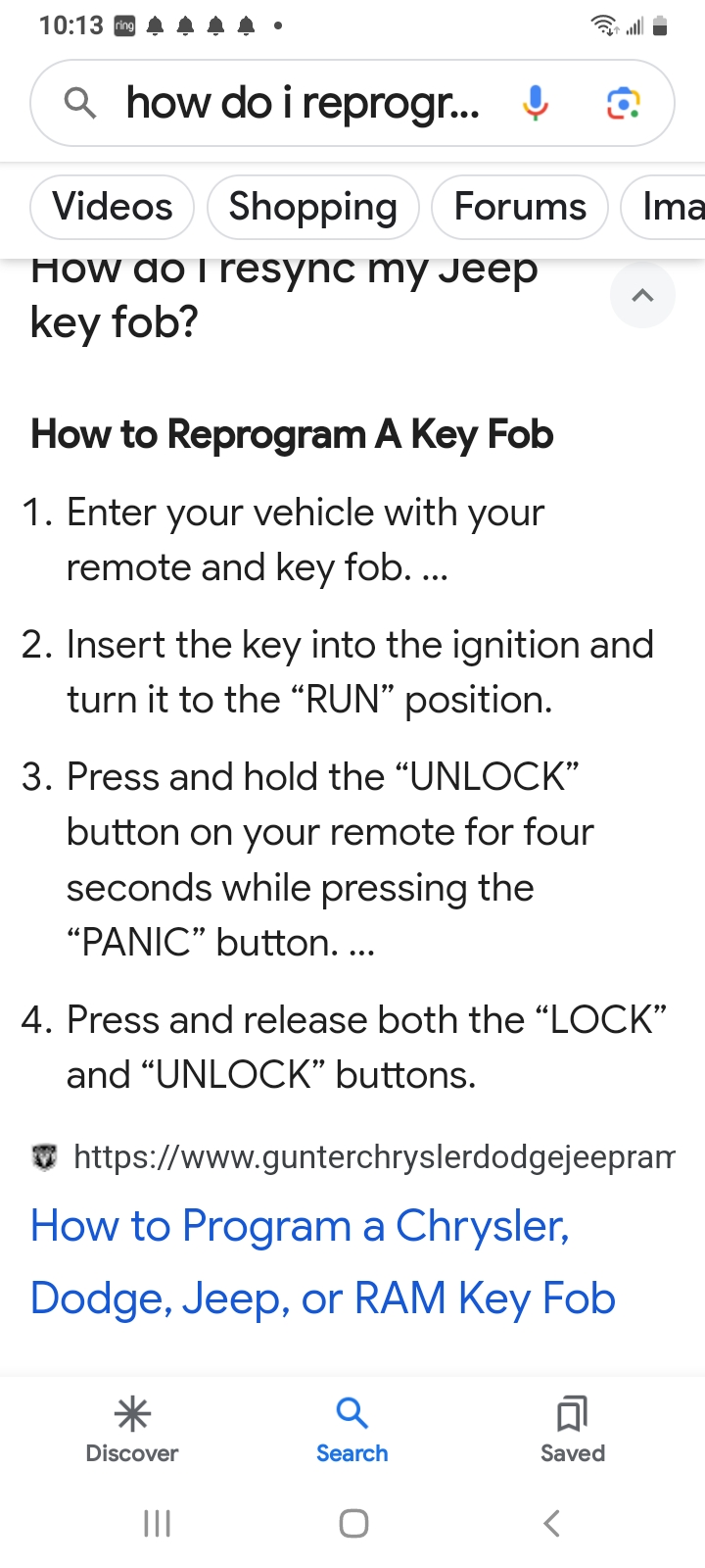

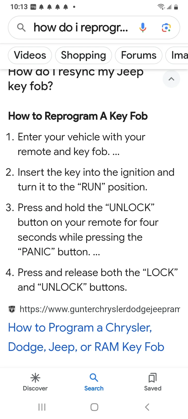

Hey Jon so here's a quick way to reset you key fob with the new lock ..it seem like it's not communicating
