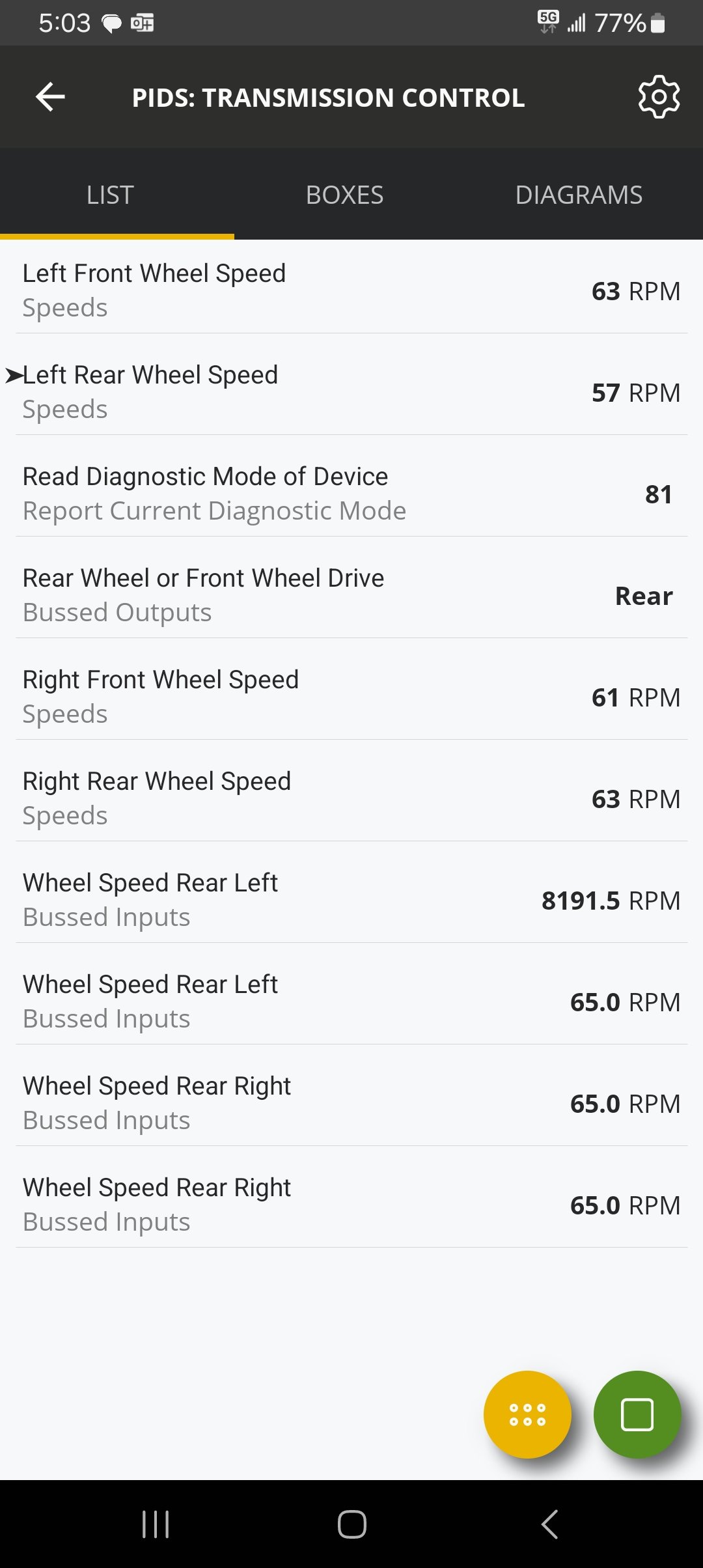

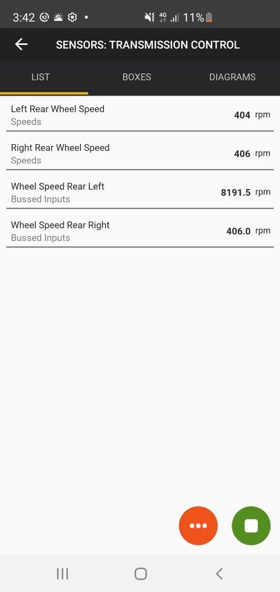

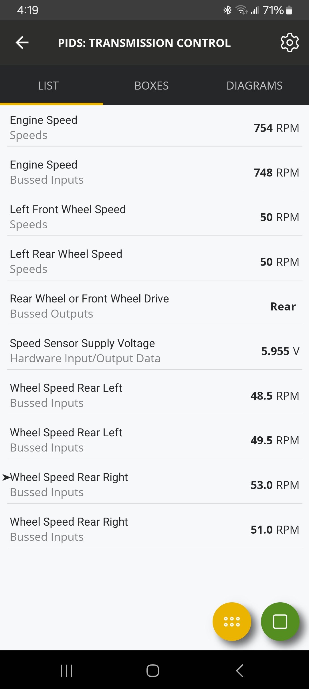

Hi everyone, JKU 2014 here. I have what I supposed was a wheel speed sensor issue but replaced the sensor and still get all the error lights. Just scanned everything again with jscan and got something weird.
Bussed speed differs from actual wheel speed. Any clue on this issue?
Thanks in advance.
You might need to clean out any debris on the tone ring - something may be contributing to a false reading. It may well be the harness, too. Is this reading the same as the original speed sensor? You can buy a replacement harness pig tail, but check the wires/contacts for any issues.
Yes, used a genuine Mopar speed sensor.
Wheel speed sensor reads actual speed ok, but bussed input (which I don't have a clue of what it is supposed to be) shows an incorrect reading. All usual lights are on. Abs track control, hill descent
Thanks in advance!
Thanks in advance!

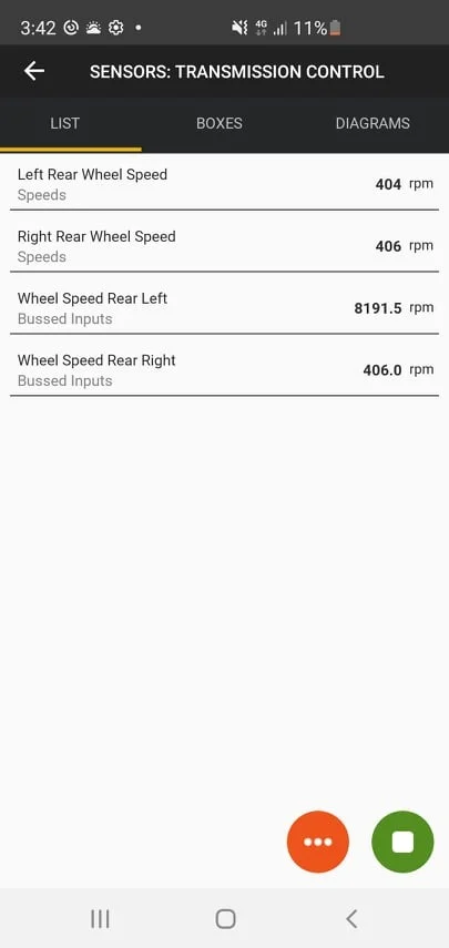

Is it possible that you could have a cable with a bad spot somewhere for that sensor? If it's going to ground it could possibly be the reason.
I will check the wiring. The strange thing is that the actual reading from the sensor is correct, as you can see from the picture. Just "bussed input" (which I don't have a clue what it means) is faulty.

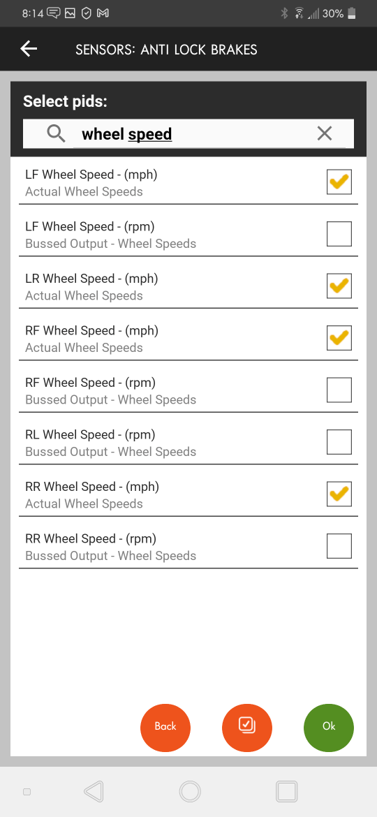

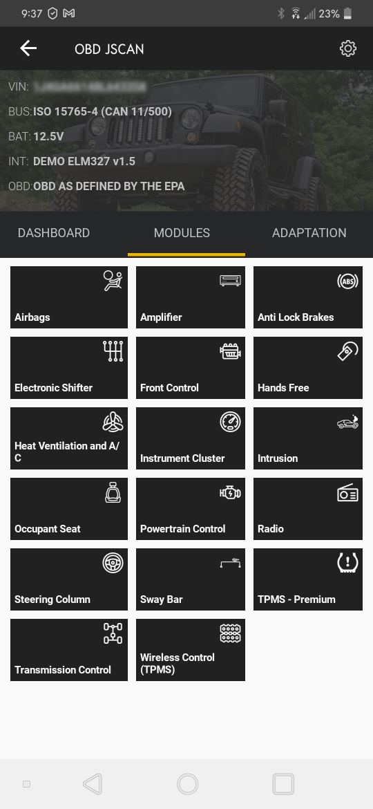

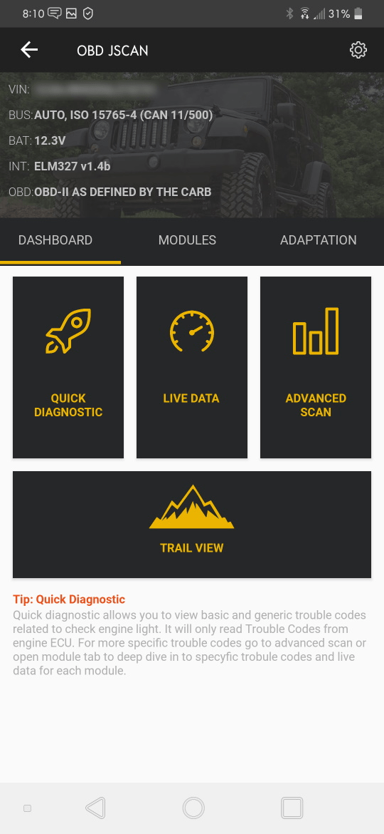

I see a lot of threads asking for help troubleshooting symptoms, which is good. We can all learn from each other. A recent thread had someone using a code reader that actually indicated the problem was a speed sensor and which one it was. Nice! However, at $90, it still cost more than a $25 scanner and the app at $24. Now, there is a lot to be said for having a dedicated scan tool... portability, convenience, etc. but for those that have this particular app and are wondering how exactly to use it, I took some screen shots of HOW to show the wheels speed sensors when you get the the common symptoms: ABS Light/Traction Control Light on. There may be other symptoms, too. Can't recall... Its been a while since my last speed sensor went out, but here is the quick check you can do with the jScan app.
Start the app...

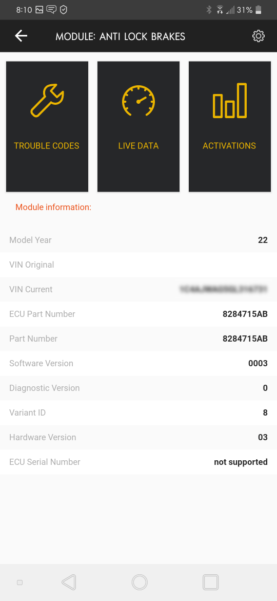

Select "Modules"
Select "Anti Lock Brakes"

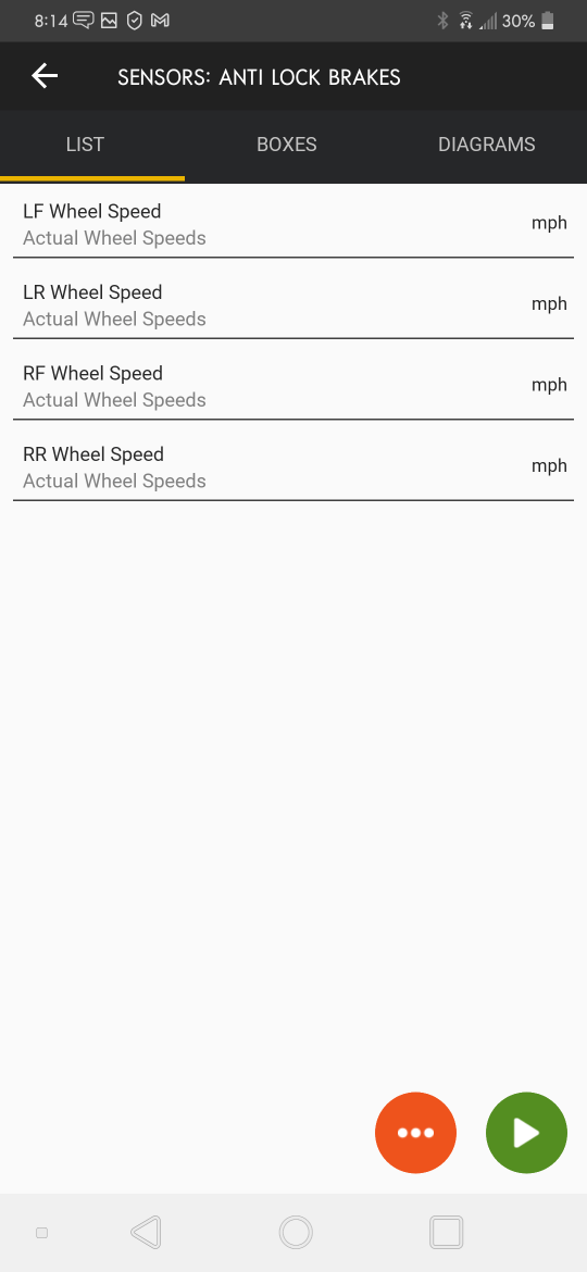

Then "Live Data"

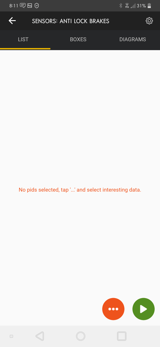

Click the orange circle with "..." to search for the appropriate PIDs. Type "wheel speed" in the search bar and select the LF (left front), LR (left rear), RF (right front), & RR (right rear) Wheel Speed sensors (mph) as shown below.
And you'll get this...
If this was a live shot (sorry, not that ambitious), it would show values as your are driving. A bad sensor would be zero as the others would have a value.

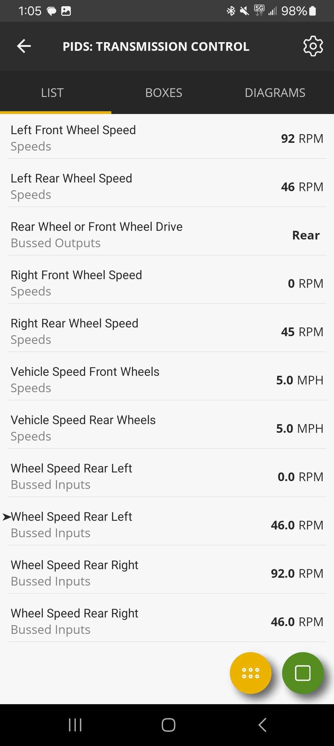

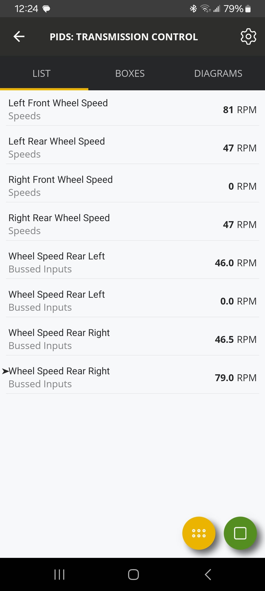

Thank you for the step by step, but doesnt really solve any issues. I am also using JScan. I've got more than a dozen screenshots, and have replaced parts. Inspected wiring and connectors.
Intermittently, downhill assist engages as well as abs engaging under normal braking. At times, codes could be cleared and no issues for months. At times, issues returned immediately.
