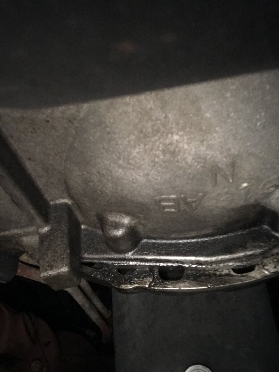

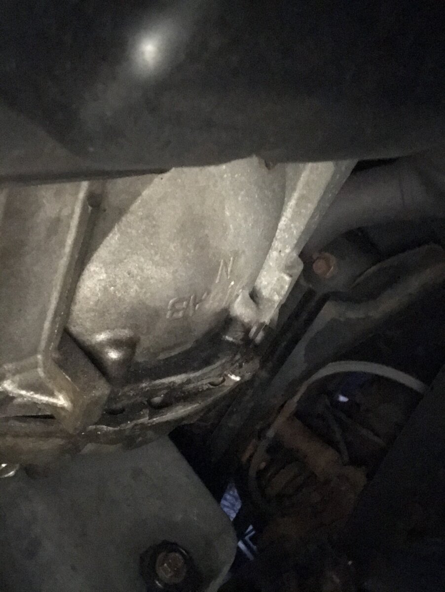

Hello all,
New to this but have an issue. Found some black grease in my inner driver fender and on bottom side of driver door. Everything seems to be driving fine but does anyone know what to look for? Only area I found grease was near transmission. Attached pictures. Any knowledge would be greatly appreciated

Thank you! Does everything in the pictures look normal? Seems like something is off
All looks as it should from the pics you provided. I doubt you will see any change in you motor oil level. It takes very little oil to make a mess or coat something. Again, check the back side of the engine on top behind the rocker covers, you might find the source of your leak. It doesn't take much oil to look like a lot of oil😏

Thank you 👍. Appreciate the help, wasn’t quite sure what I was looking at
Could be a rear main seal leak, which is a powertrain warranty item (mine went bad at 65k miles). That leak is messy and looks a lot worse than it is. You won't lose enough oil to notice a difference at the dipstick unless you don't address the issue.
That’s what I thought it could have been but I figured I would have noticed a lot more oil around that area.
When you park it at the end of the day put a piece of card board under the area and in the morning look for oil on the card board then straight up. Will let you know where it may be coming from, RMS would be the small opening in bottom of bellhousing.
Rear mains have a tendency to get worse over time/mileage. I would clean the area as best you can, keep cardboard under your jeep as mentioned, and try to pinpoint the source. Don't go to deep or jump to worse case scenarios until you have located the sorce of the leak. There are other possibilities, I hesitate to mention with out knowing the source, i.e. front main on trans, and oil filter housing. Keep a simple focused approach and you'll find the oil leak.
