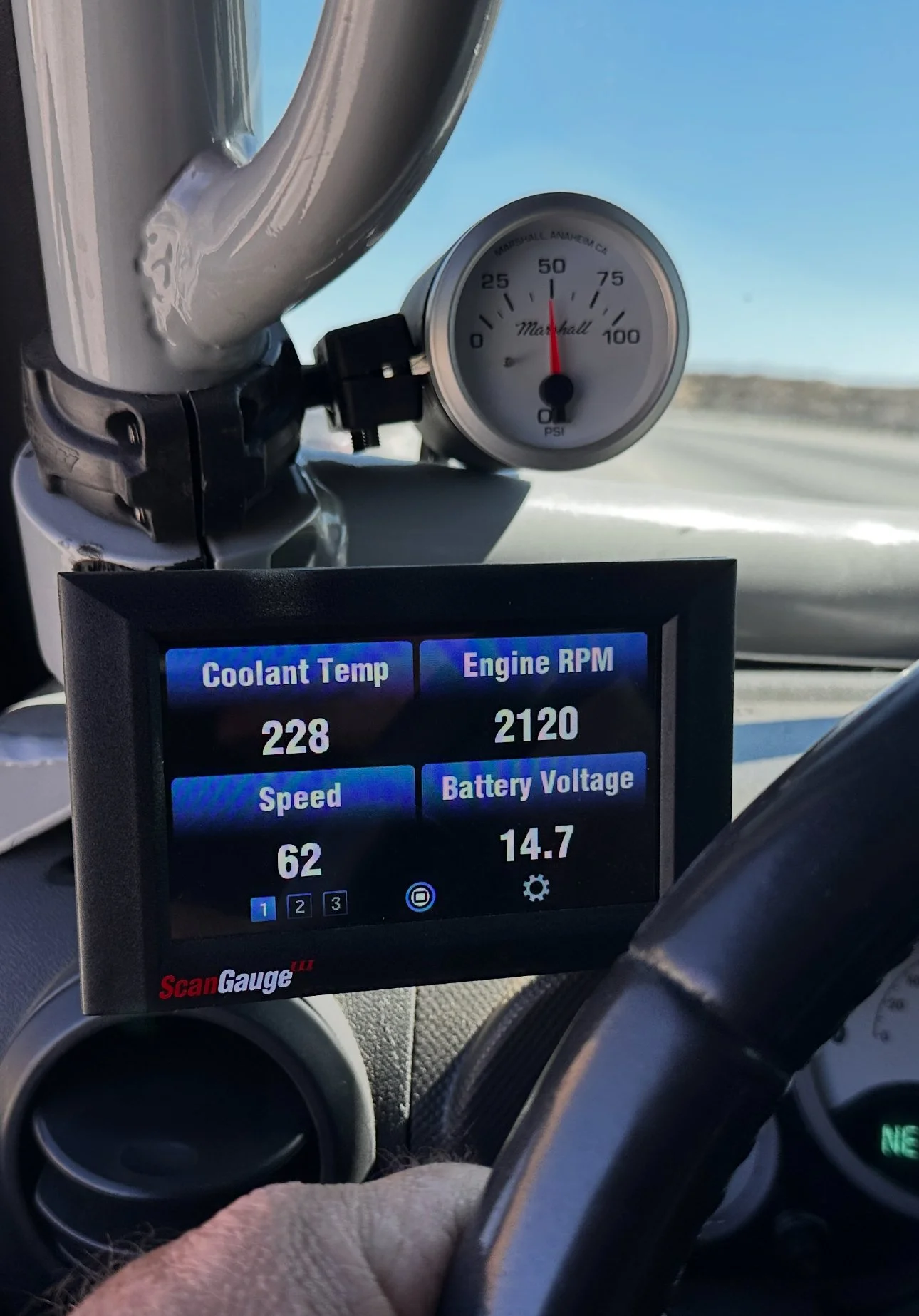

Not "overheating" hot but not where I like it. On a steep grade (freeway) it would climb to 230f and then on decent, go down to 185f (fairly fast). Crawling in 100f heat, no issues, 190 all day. So it was a flow issue I assumed.

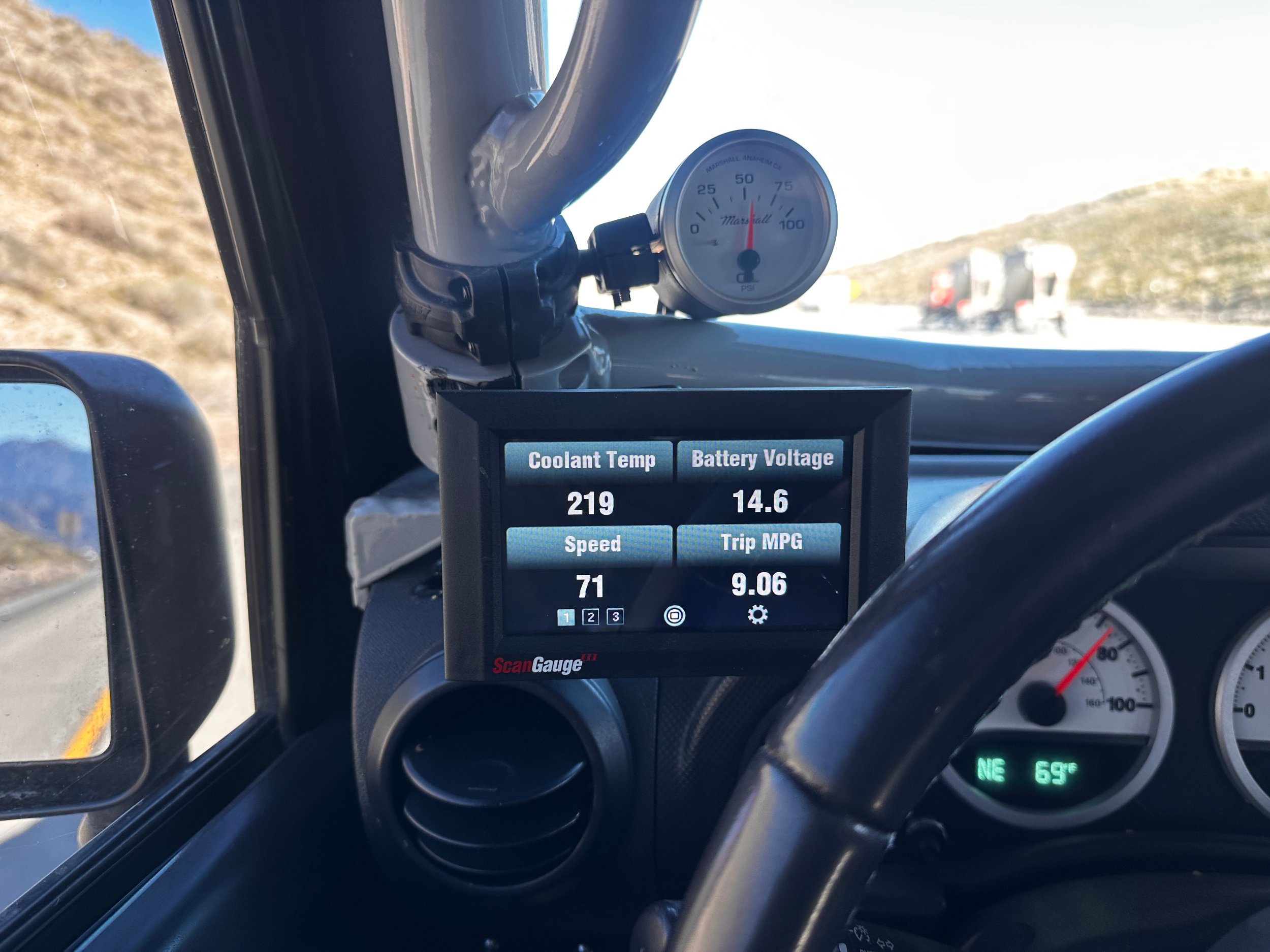

Fast forward to a week ago. I pulled the old school tube a fin cooler that was smack in the middle of the radiator. It was not only "inefficient" but plugged with dirt on the lower half between the cooler and condenser. First improvement. Next I added two 13 row "stacked plate" coolers. These are much more efficient. They flow more air between the plates and have a much smaller footprint. I was able to put the new coolers vertical and right on a grill gap/intake. The net gain (or delta?) was 9 degrees on the same freeway grade at the same spot. I was also doing 9mph faster on the "good" test. Another thing I noticed was the temp hit 119 sooner but never climbed after that. The pre test would continually rise. The only reason I topped at 228f on the pre test was I ran out of grade to climb.

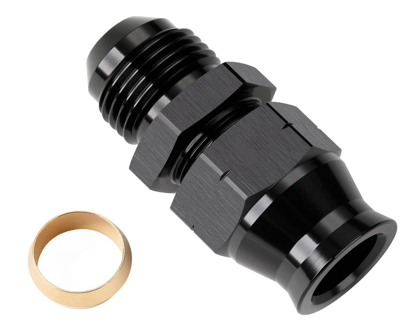

I used -8an hose through out. It looks good. For the trans exit fittings, I decided to leave them hooked up and un molested. Just looked like a hassle, clips, orings, leaks etc. For the adapter I used a 3/8 compression to -8an fitting like this:
I put a tiny amount of oil resistant silicone on the ferrule before I tightened on the ferrule. Not sure if it helped but there are no leaks anywhere (as of yet lol).
Here is a couple of pics of the test on my ScanGauge III:

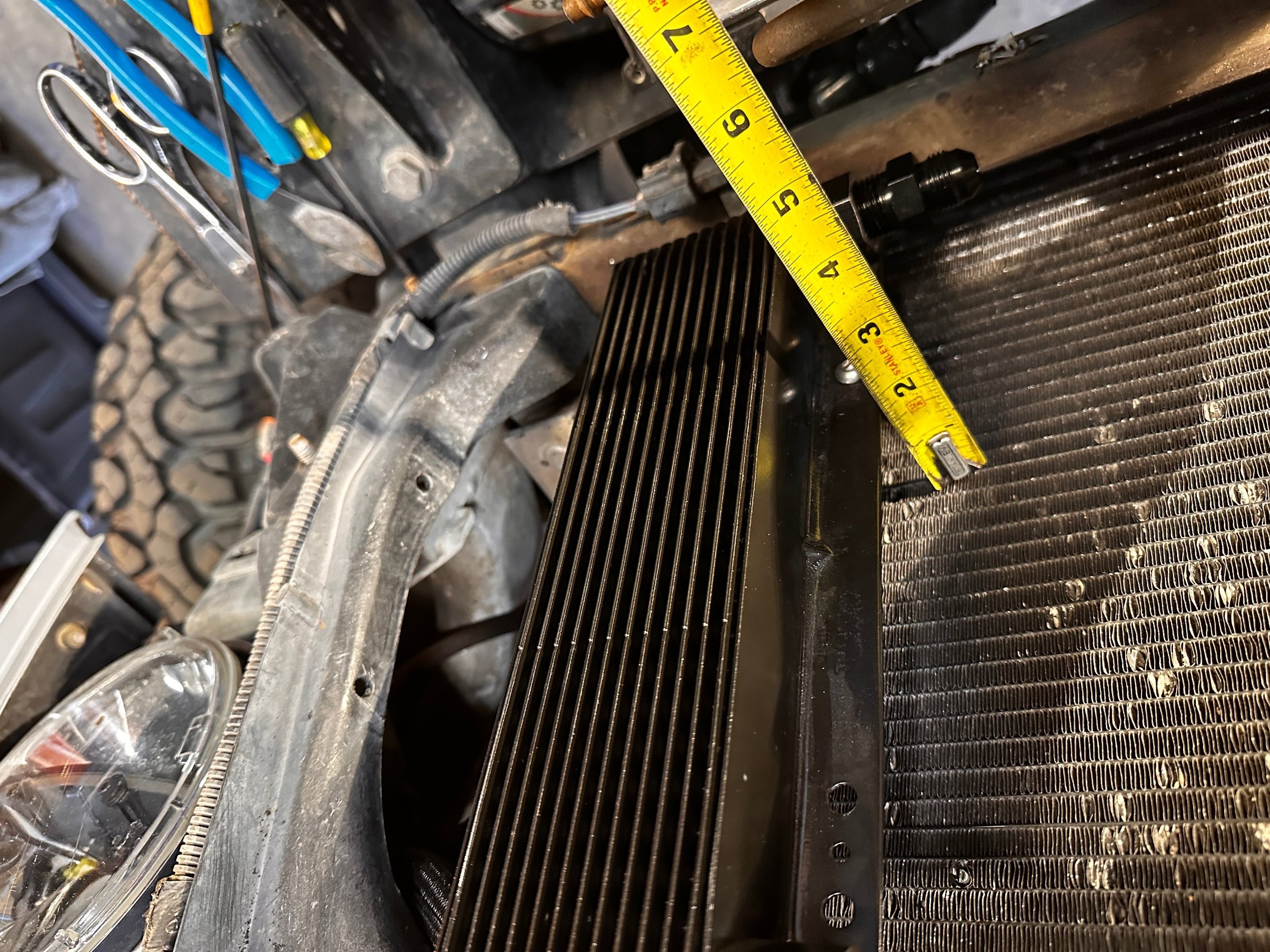

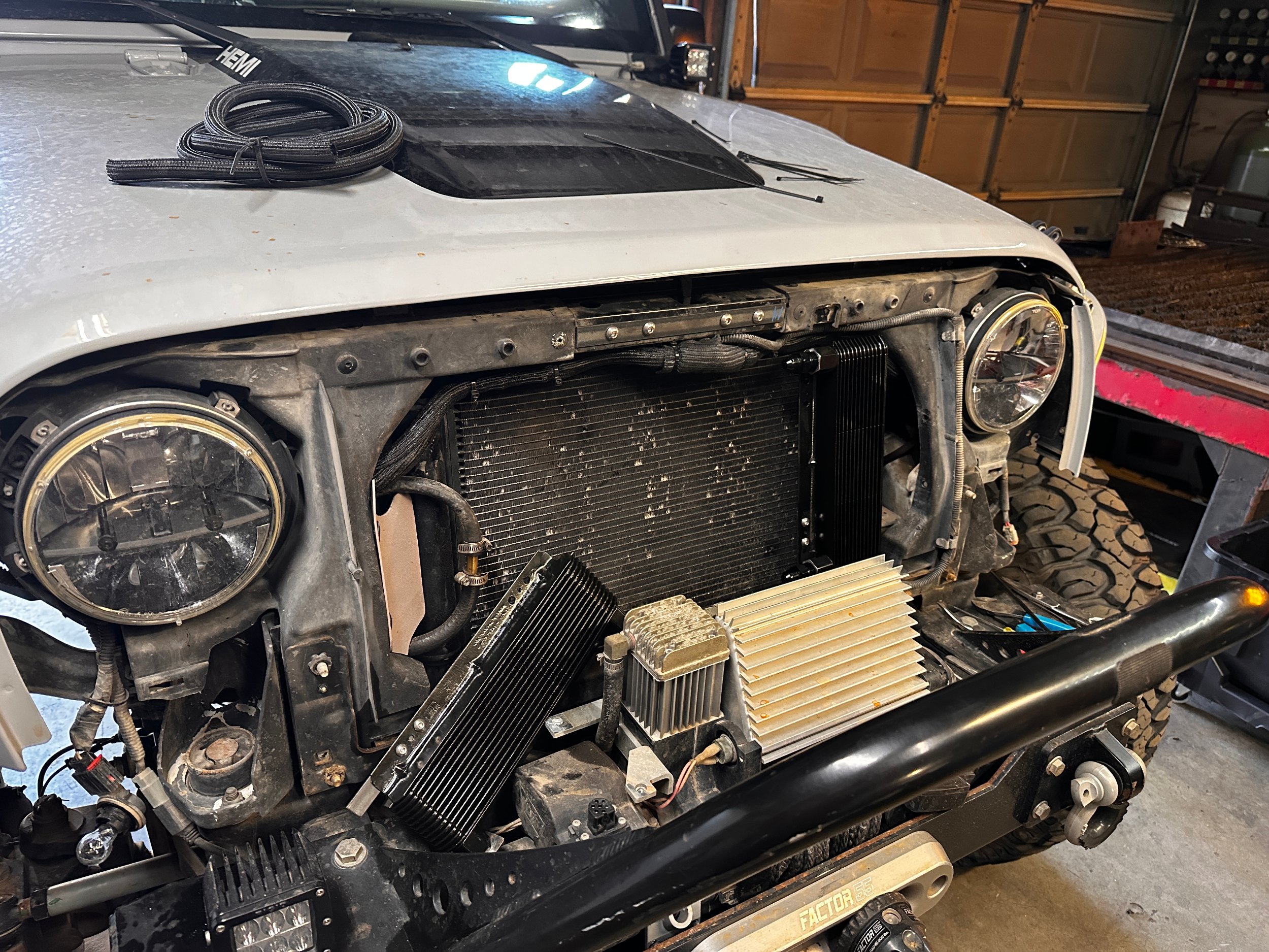

Right at the start. Grille and old cooler pulled, it was about 12 x 11 inch and sat right in the center of the condenser. I laid a new stacked plate cooler on the bumper to get fit up.

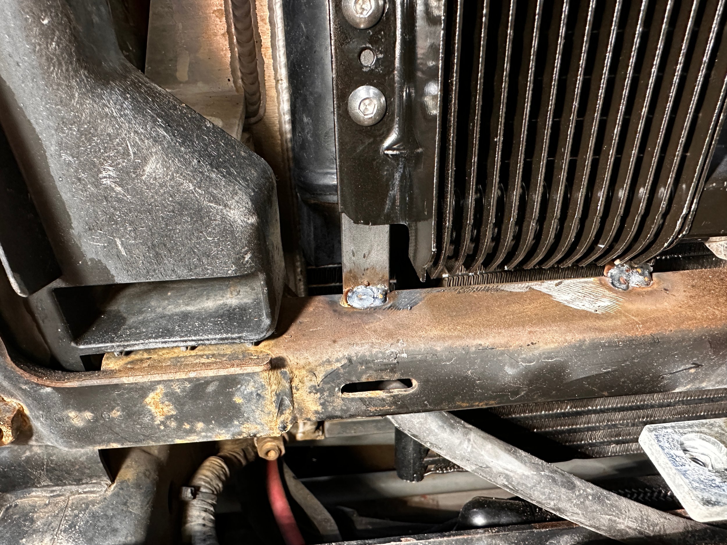

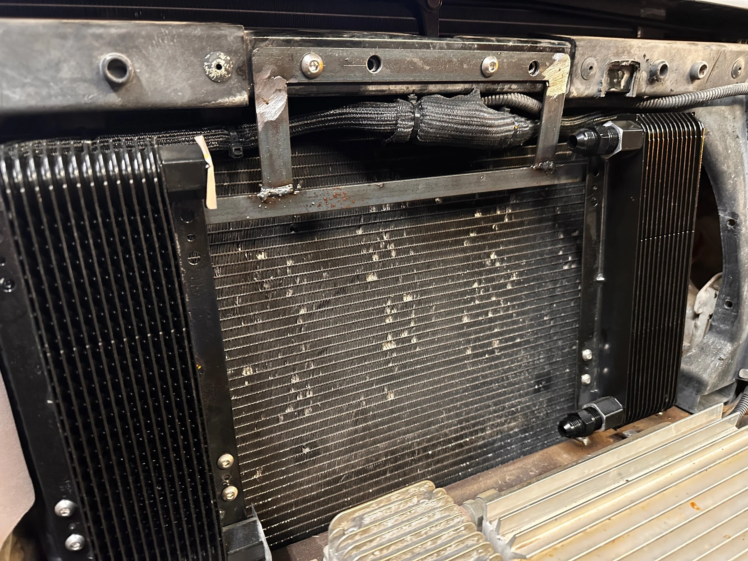

I made a couple of mounts to hold off the two new coolers. I welded the bottom mounts and bolted the top mounts to some existing holes that I was able to tap 5/16" coarse thread
From there it was easy to bend the top mount to make clearance for the grille. There is about 1/4" gap at grille and 1-3/4" air gap between coolers and condenser.

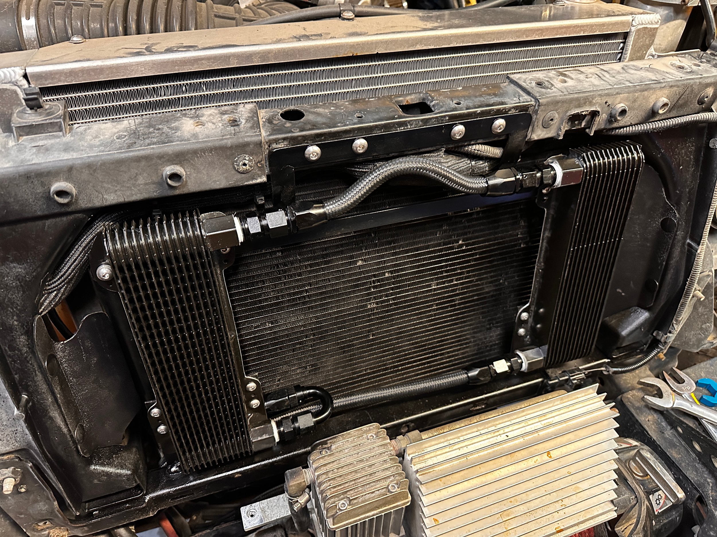

Here it is mounted and hoses connected:

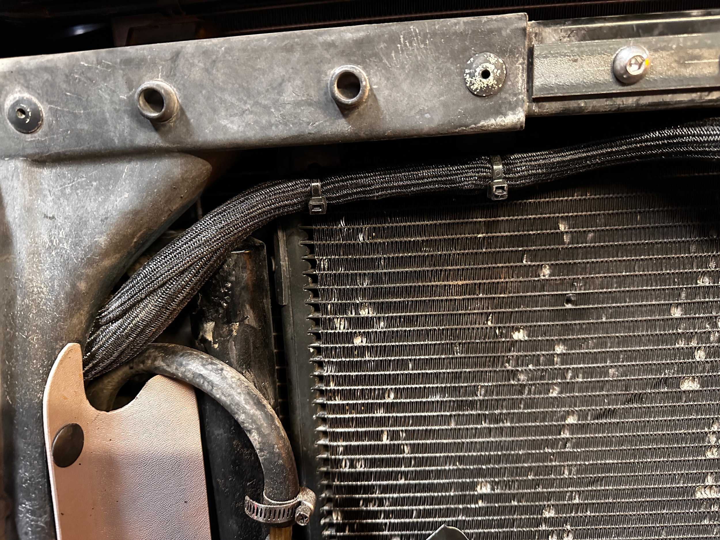

I also recovered the cracking split loom with some split self closing covers:

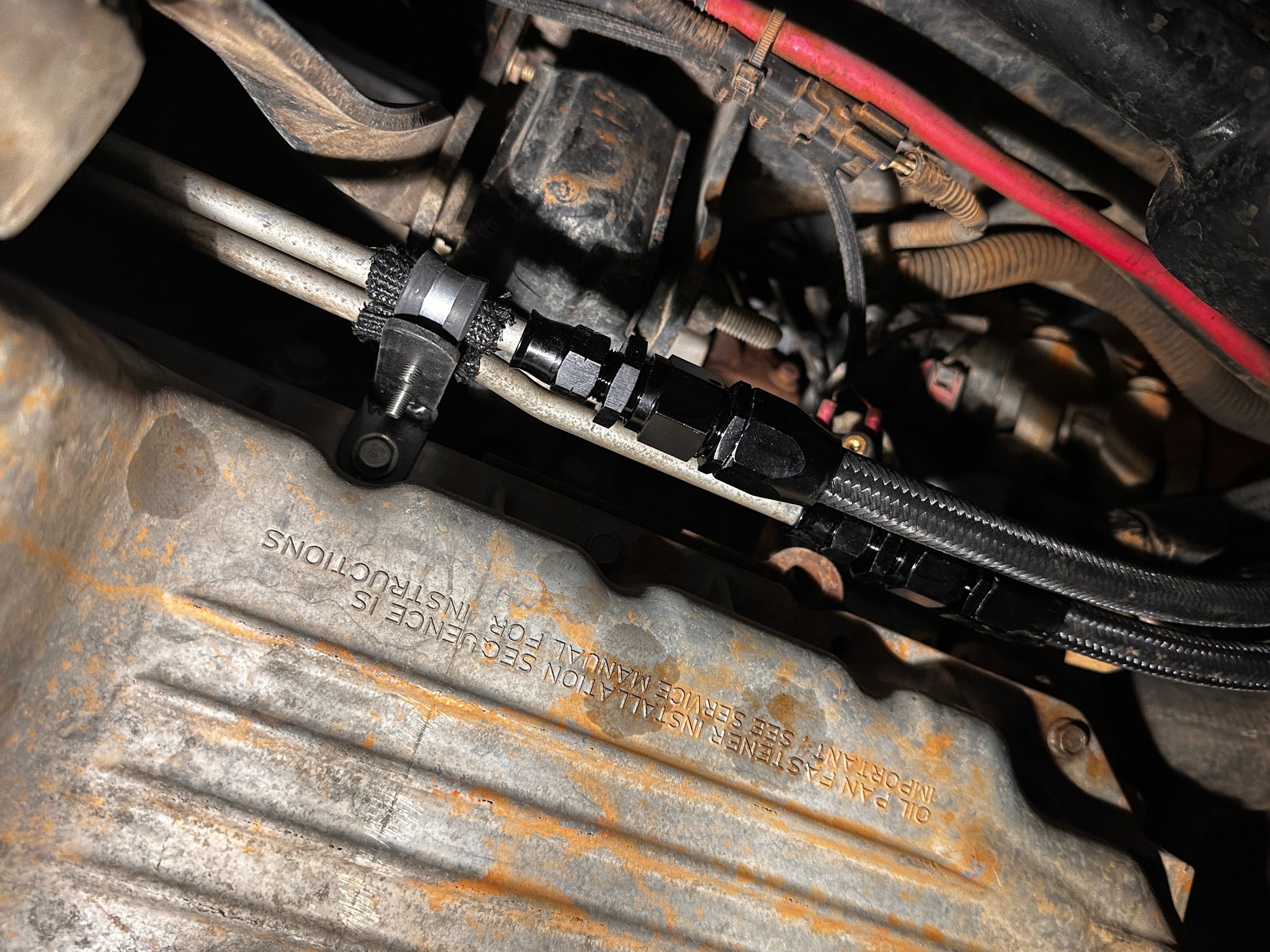

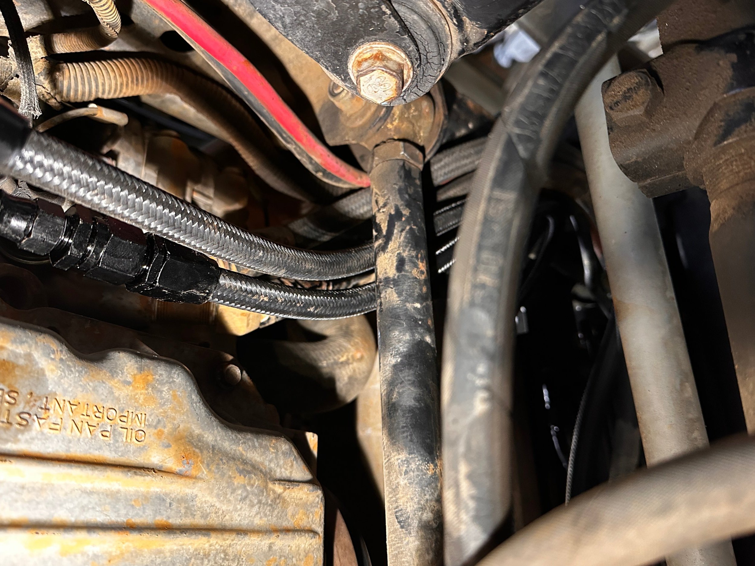

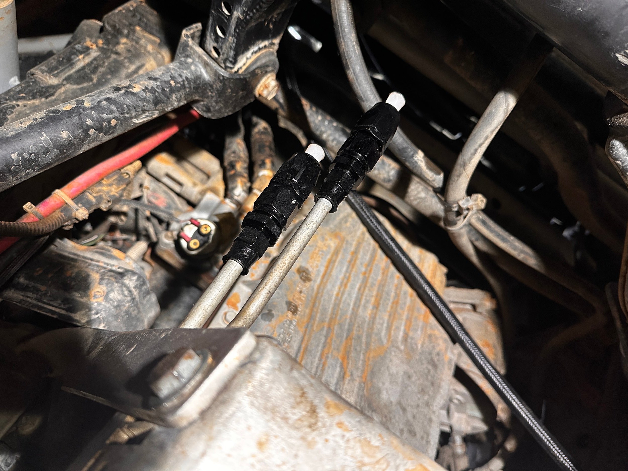

For the trans tubes to an hose I used the compression fittings shown above. I cut the tubes at different lengths to make a tighter fit. I pulled a oil pan bolt to hold a trans tube mount. The tubes are solid now. The lines float easy. here you can see them stubbed out with a silicone plug in the ends.
The mount and clamps:
The hose routing, they do not touch any edges or moving parts, about an 1" over the crossbar. I like the setup.
